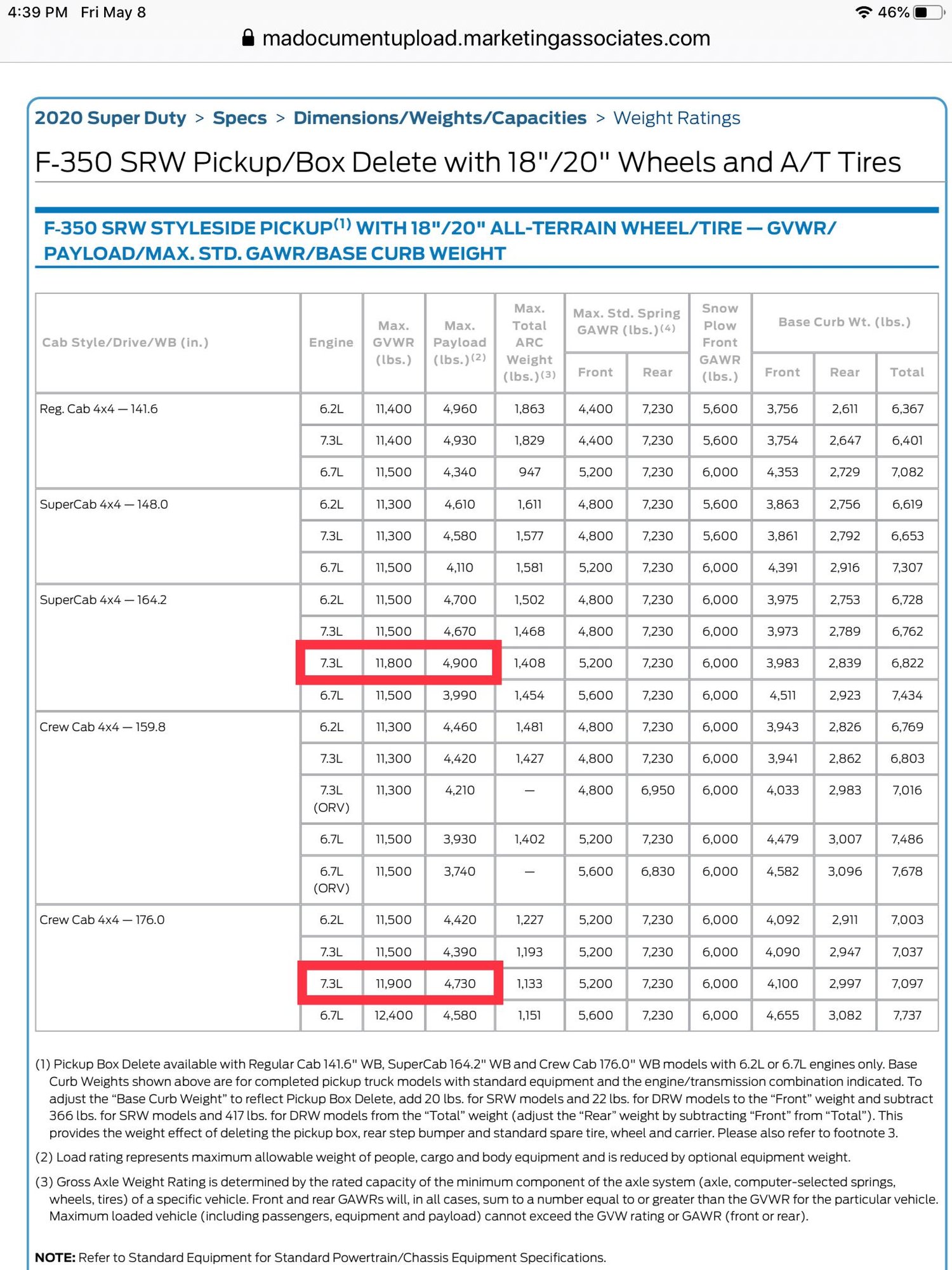

There are two new-for-2020 special F350 7.3 longbed SRW configurations that perhaps should not be overlooked; see below.
HTH,
Jim / crewzer

Jim, I didn't see your post when I replied to Steve. I don't know how I missed it?? I appreciate you helping me out. Ideally, what I would like to get is a late model/new? low mile, F350 dually, crew cab, 4wd, long bed(8'). I don't want a diesel. A few creature comforts inside. And maybe the pickup truck fairy will just leave the keys under my pillow one night?
I just want to have confidence that I'm not pushing any boundaries and jeopardizing the safety of the kids I'll be hauling around. Nothing fancy.
As far as payload goes, I wouldn't feel comfortable with single rear wheels. The extra margin of safety with duals is like an insurance policy. I really appreciate the input you folks provide. It is comforting to have this site as a resource. Thank you, all.
Ken
