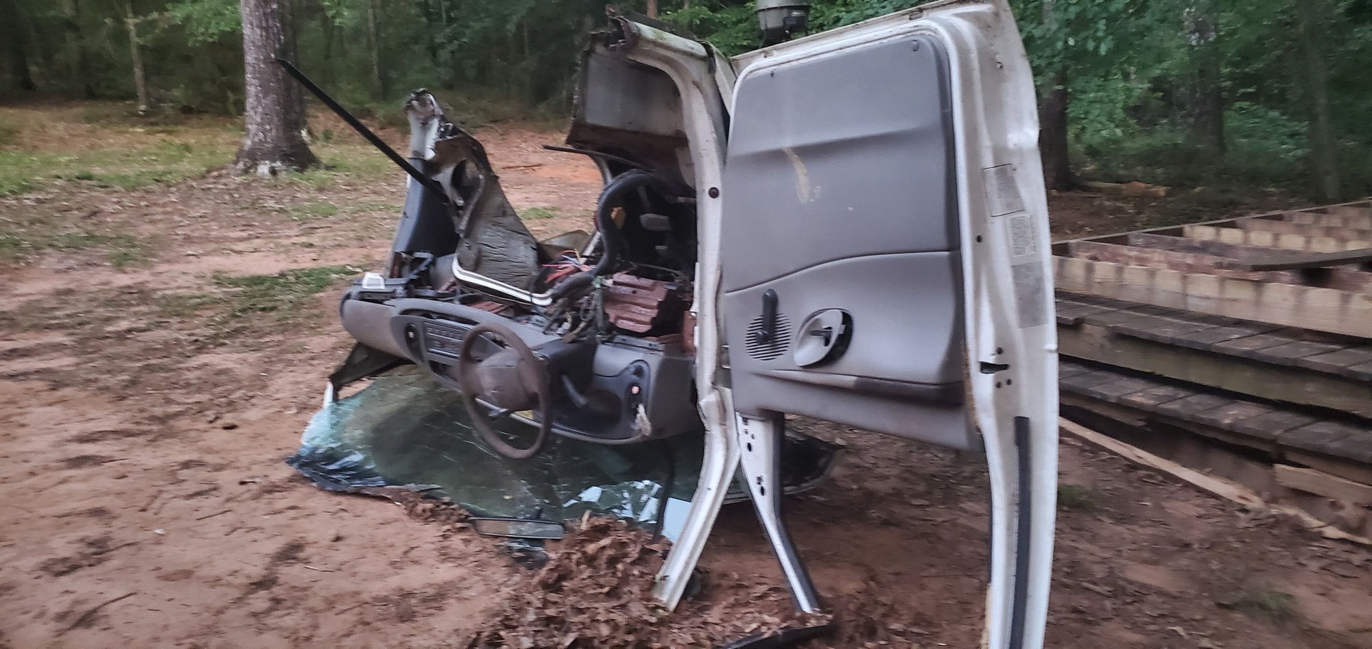

Had the van moved from an old property today, You can imagine I am ecstatic to have this in my yard
In a 7.3 watching a 7.3 bring my 7.3
see the mud hand signature on the 79.. ugh...

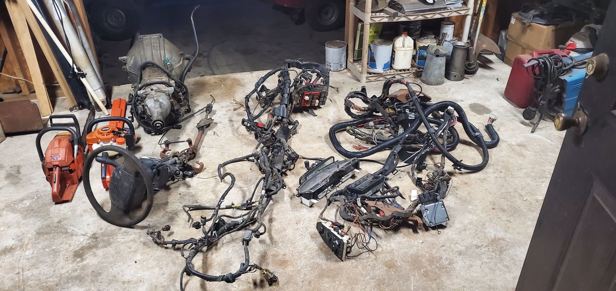

Now what DUMMIE wants all these wires in a truck with no wires in comparison? Me i guess

Thank you for the kind words! Mighta thought differently of me if you'd saw it unfold. It was a controlled winch removal, not a snatching affair

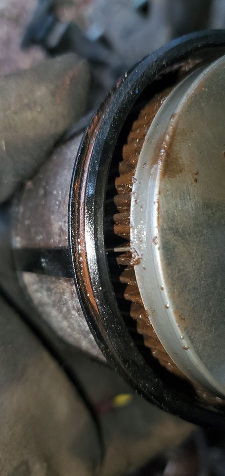

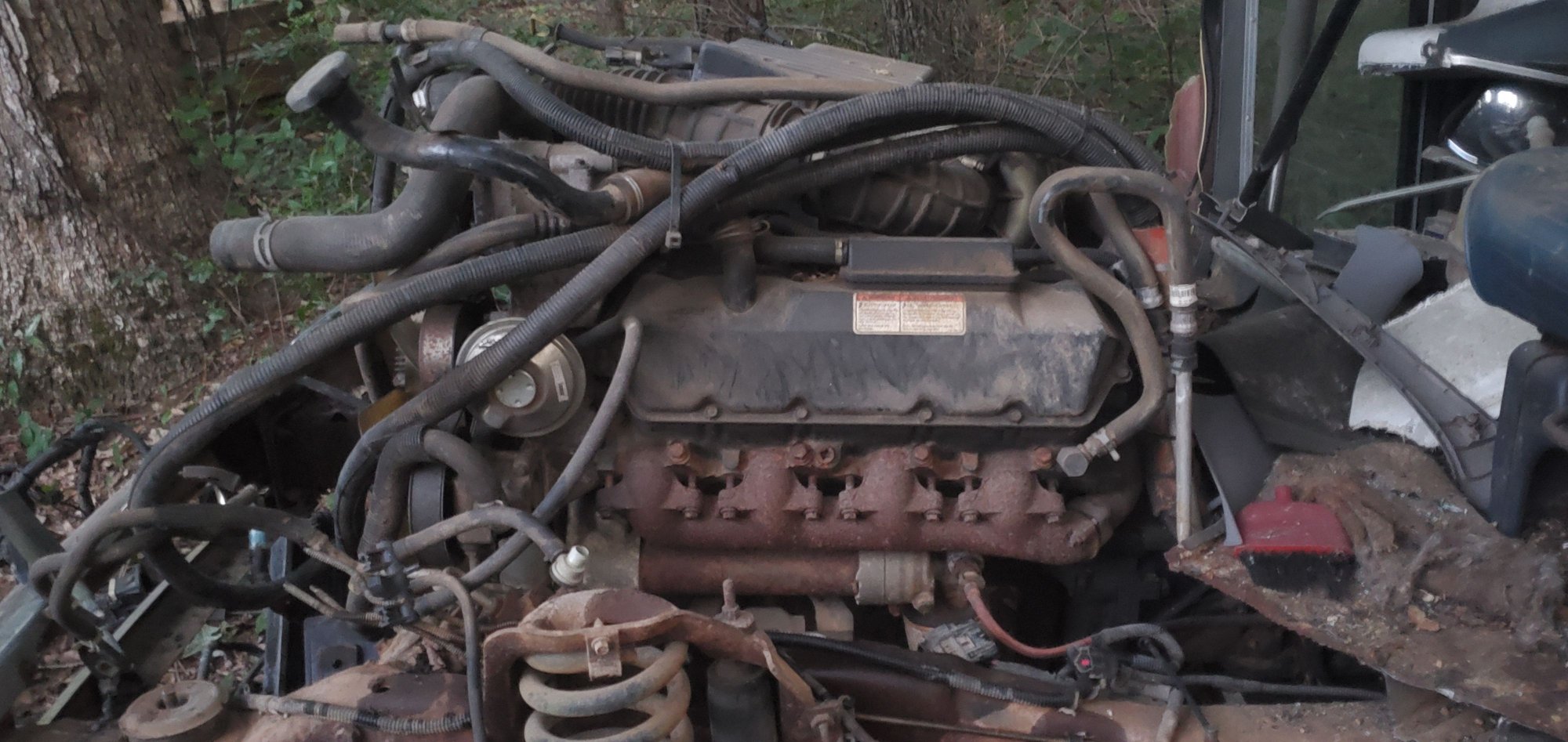

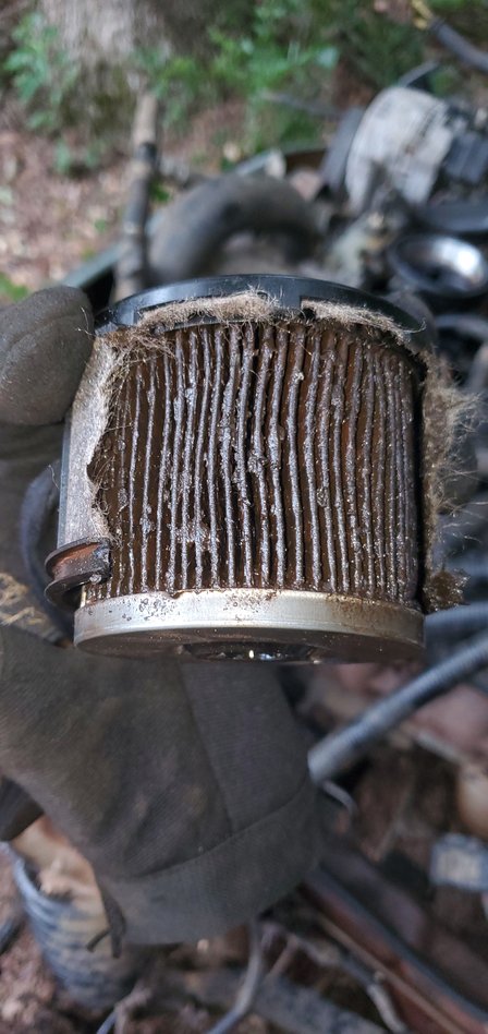

I was driving this around when i bought it but someones was slacking on the upkeep
80% plugged
more crud (common respiratory unknown disease) but seen worse with 260k miles

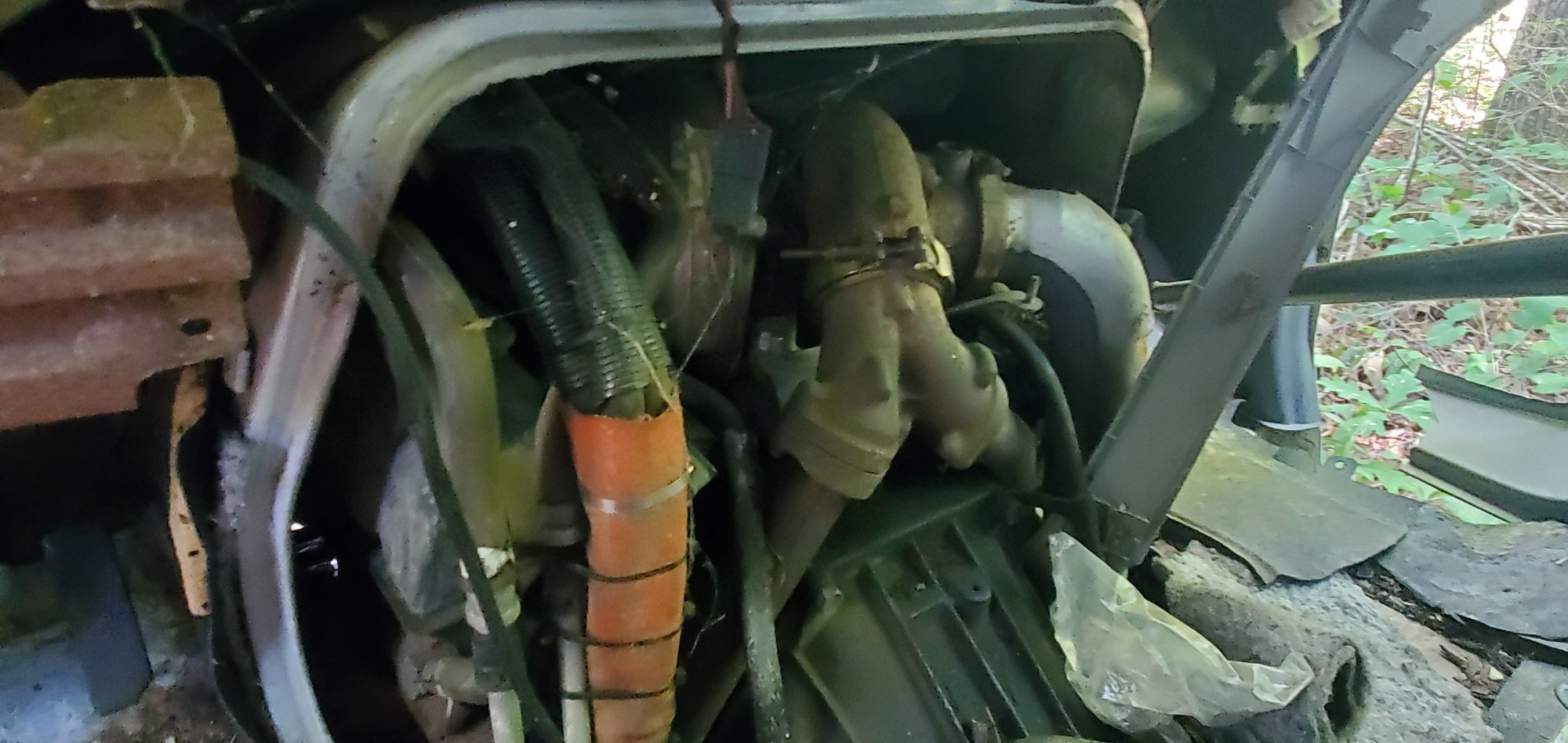

fuel drains down the front of the block instead of into the valley which is nice!!

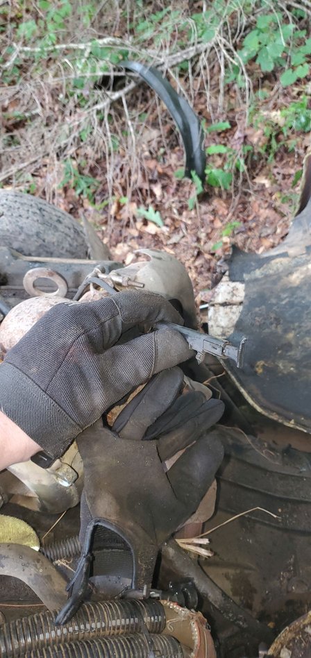

This is a first. Never seent a fuel bowl drain cable.. Learning every day!
Rat carnage(could b worse) Fuel bowl heater, IPR sensor and ICR plugs devoured.
Little corrosion but absolutely zero shaft play!!
