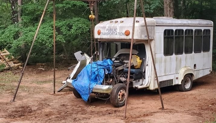

Azalea and Mandeville that came for mothers day went in first. With the ball & chain and 4 kiddos there ain't alotta time for toolin!

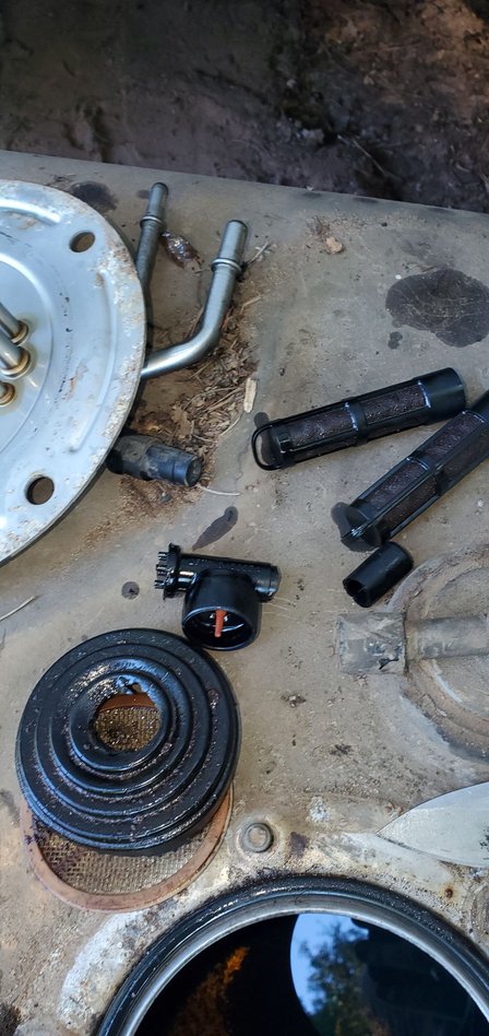

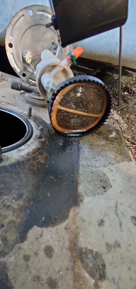

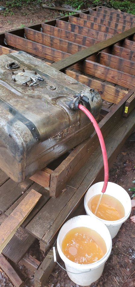

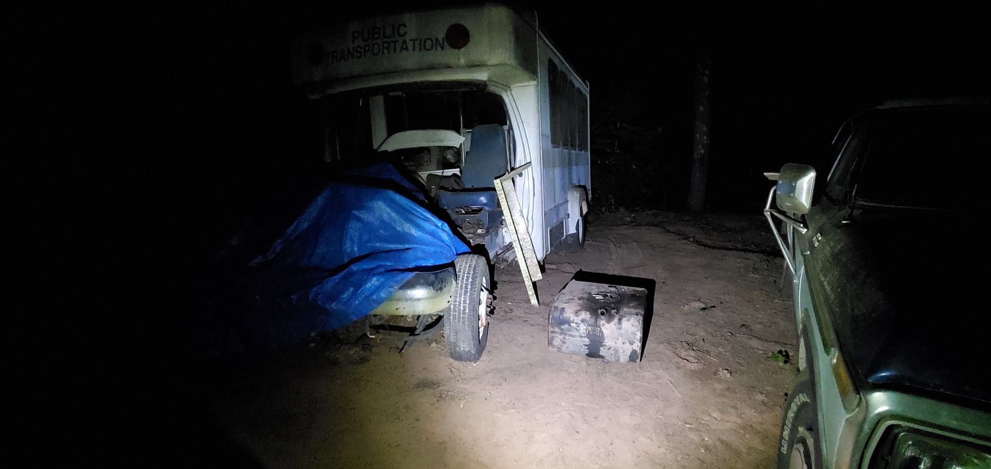

got the tank out this evening and was surprised at how decent the in tank screens were. The pickup boot was a different story.. The dry rotted boot makes it suck air at 1/4- of a tank, I fought this issue in my dually for a few months when I first got it..
I've seen worse fuel.. Honestly figured to see algea growing inside the tank
What a FIGHT this monster was!!!!
Was blowing leaves before I started on the bus and this little top reminded me of the scene in tremors where the graboid pulled the station wagon underground😆

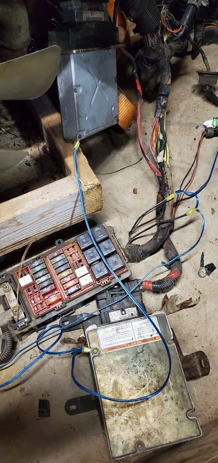

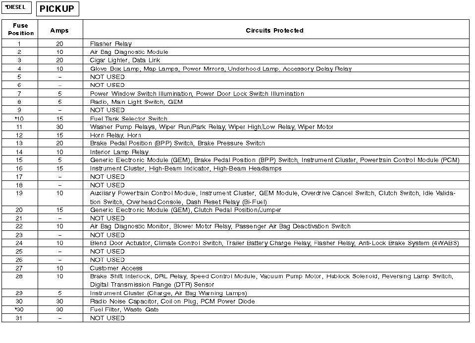

Sitting in here with the putty cat and we think 72-73 of the 104 PCM pins will be used(basically all of them)
Also appears that 17 of 29 fuses will need to be used on the underhood fuse block and 9 of 30 from the inside
Then on from the PCM to the
IDM
GEM
VSS
and a few other small systems.. Hoping to start breaking down the harness soon

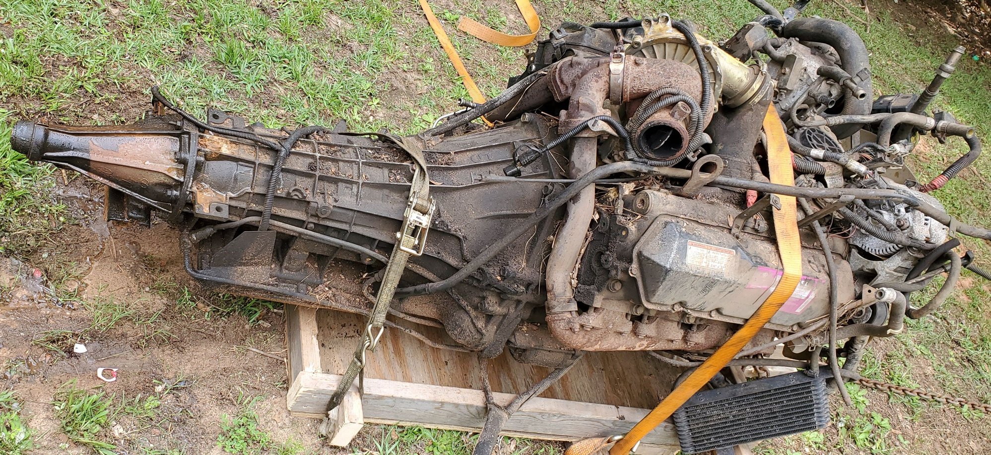

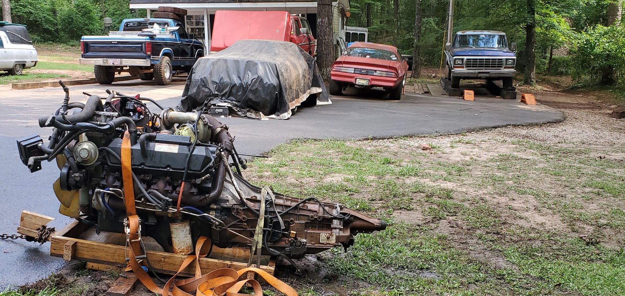

Plan on pulling the power plant tomorrow..
Wore the lil helper out today. Firewatch out
Lil break from the powerstroke madness
450 got new tires, tubes, chain, sprockets and chain guides 💪🏍

The divorce
3rd harness
Fuel Pump
Fuel lines
Fuel tank
Taillights
VSS controller
Supercab getting ready for surgery (I see the back tire)

now is a great time to replace the seals and gasket for the oil cooler.

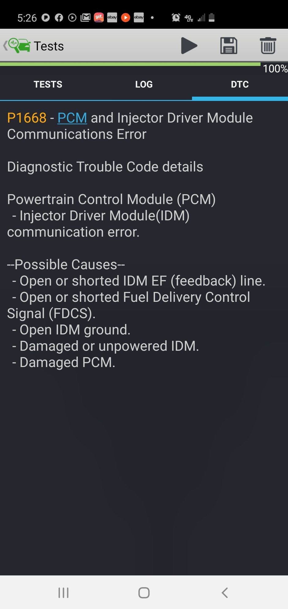

1 hour to get power to the key and cluster
1 hour to get power to the outside fuse box
1 hour to track down ground issue with fuel pump
Going to run larger gauge wire for Glow plugs tomorrow
Closeeeeee but I'm smoking more than the diesel
Getting good RPMs when cranking. Power to the fuel pump (confirms power to the ECU) and the glow plug relay is cycling. No oil in the ICP harness, also unplugged and still didn't start. Oil level is reading correctly on stick plus oil is within an inch from the top of the HPOP reservoir plug/cap. Fuel bowl heater fuse is good as well. Going to get fuel psi reading tomorrow and bench test the solenoid for the IPR.. (which I'm leaning towards as the issue)
The van went down and wouldn't restart 7ish years ago after sitting overnight so we stored it. Looking back I wish I had found the issue before pulling the harness but we'll get it sorted out 👍.
Going to buy Car Gauge Pro tomorrow as well as
@SkySkiJason suggested. Its past time to step my 'electrical systems' testing skills up.
Bought the app today. I went with forscan because I like the PID gauge screen. Any tips or advice
okay fellas I'm a duck in the water ATM..
Added pcm ground
Need 500psi ICP and +10.5v to pcm to crank.
I am also starting with an 800 CA battery as well as my tahoe in unison via jumper cables

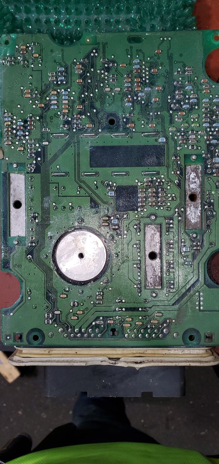

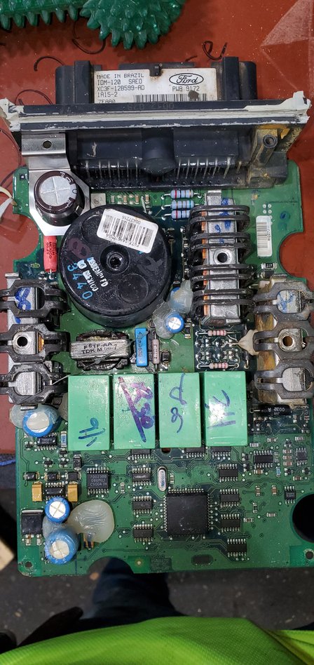

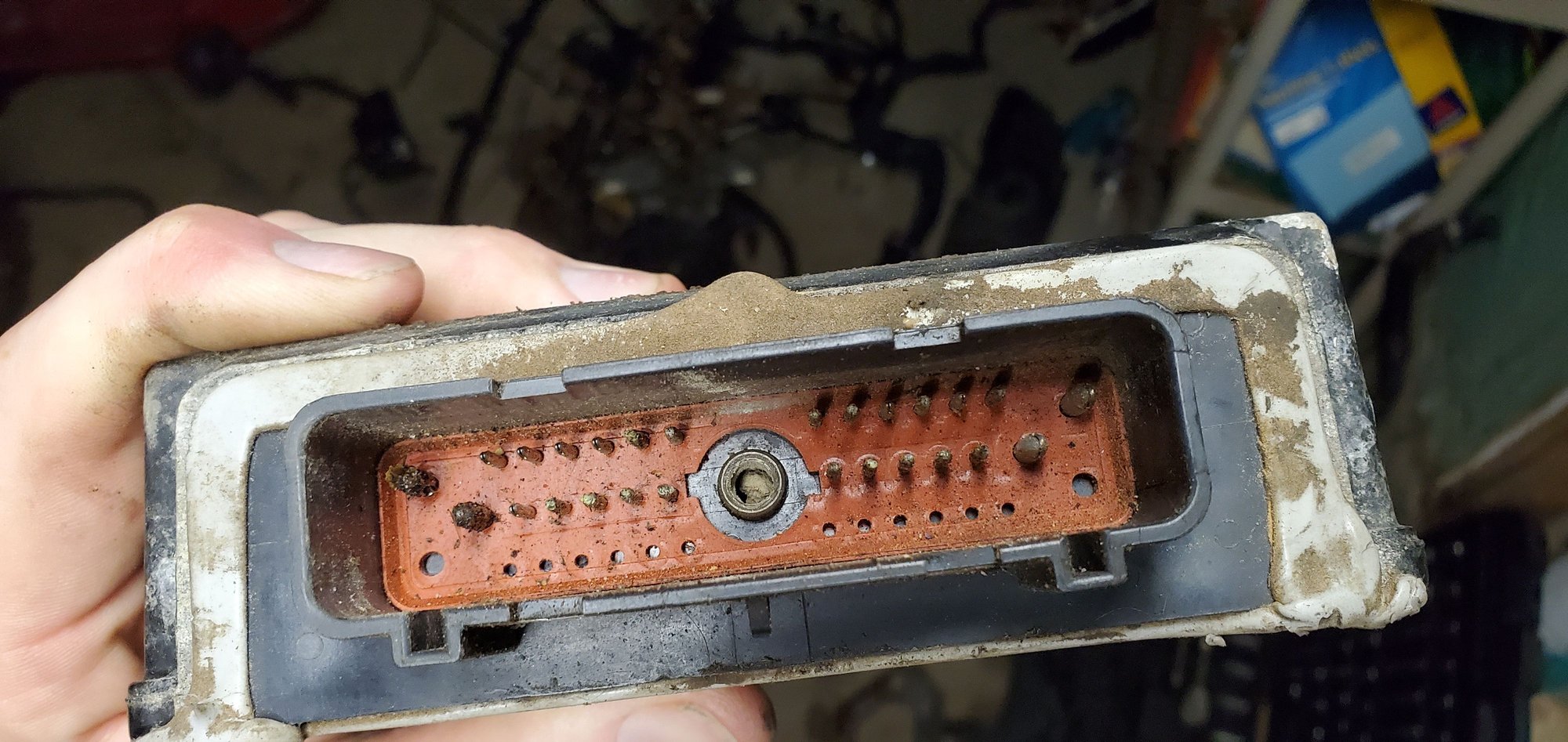

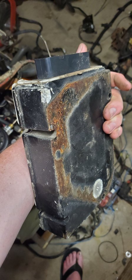

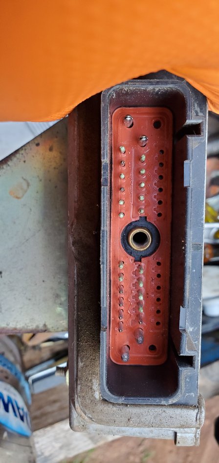

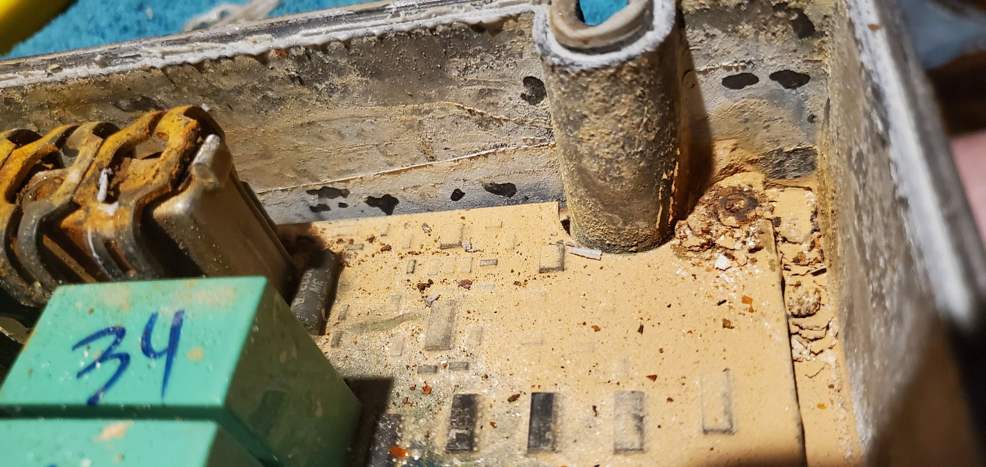

There is corrosion on the IDM and inside the pigtail.
Safe to say we have found a starting place
flood damage
@SkySkiJason I definitely owe you for the direct lead
Taking it to the machine shop tomorrow to dissect a little deeper. Surely its cheaper to rebuild than buy used..
I suspect it isn't burnt up rather than corroded and oxidized
Now I have GOT to check on the IDM in my dually😬
Not seeing anything burnt. Three of the larger pins were corroded so im hopeful that's it

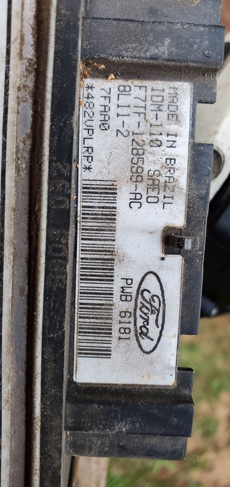

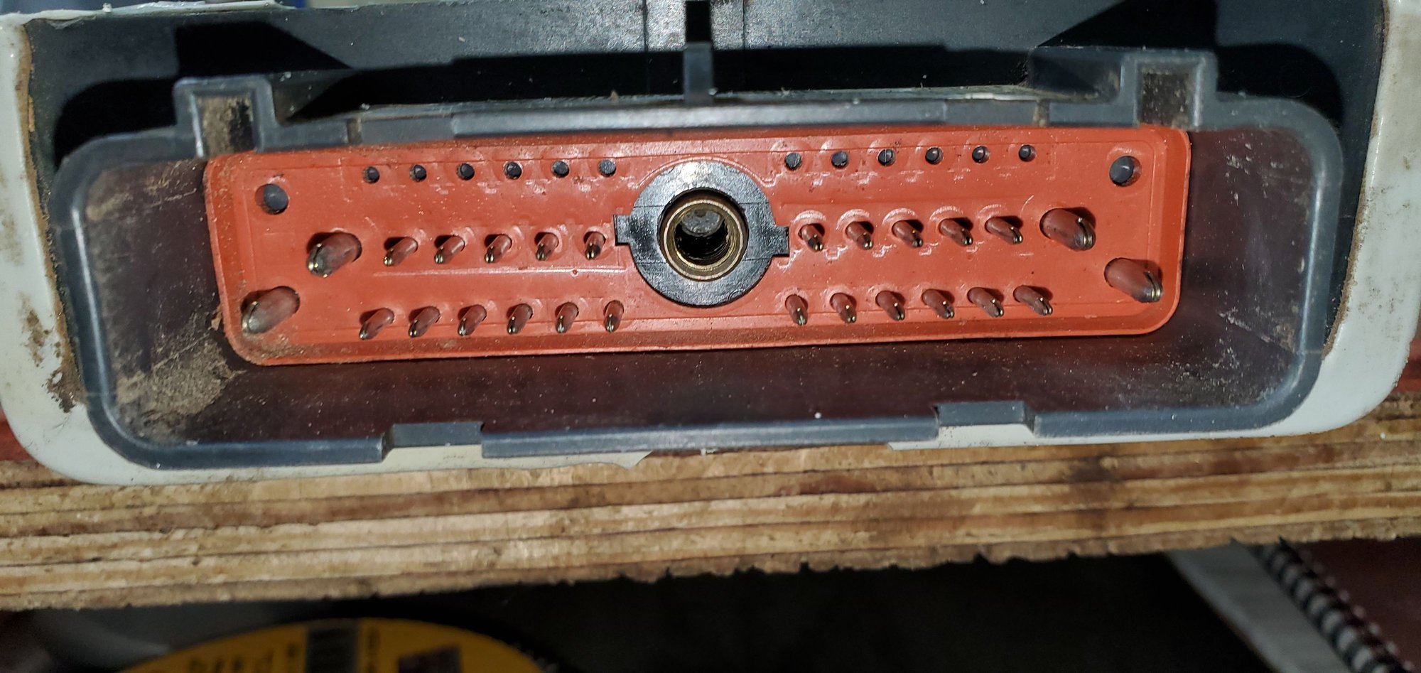

The old IDM wouldn't register for a buzz test so I borrowed another one
16 hour day yesterday because of a paper roll drive motor
New rule at work,, facemasks if within 6' and separate every 10 mins for 5 minutes for 'controlled exposure
I pulled the IDM out of my dually (after unhooking the batteries)
The plug and pins are in excellent shape
I know, my lugs are rusty🙄🙄 Older women always snapping pics of them at the redlights tho 😆
do i see 110?🤔
Finally a successful buzz test..
and...... DRUMROLL.......
