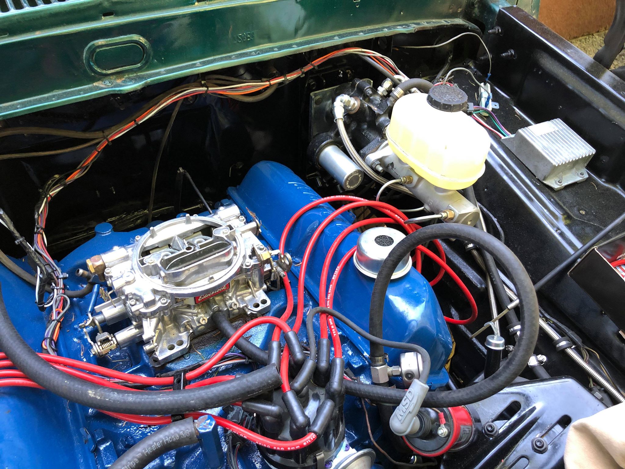

Done it to my 79 Bronco. Well worth it. Just got to fix the leaking proportioning valve.
