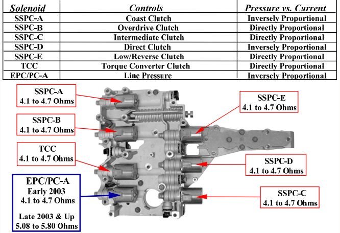

Thanks Mark, I've been looking on line for a diagram of the valve body to figure out which solenoid it would be. Do you have a link for a diagram that would show that?

It is the TCC solenoid.

Much appreciated Mark, so I need to locate a TTC solenoid in case that is the problem, right? That would be the solenoid that id bad would be causing the problem? And the wiring running to that solenoid is where the problem would be if in the wiring,right? How many ohms should it show going to the solenoid? Basically start at the solenoid and work my way back if it isn't receiving the correct amount to the solenoid? Haven't fooled with transmission that much, a little (that's putting it lightly) over my head. I appreciate you taking the time to send this me. Thanks

Electrically check the wiring from the PCM to the transmission connector. If it doesn't show a problem with continuity or short to ground, then check the resistance of the solenoid.
