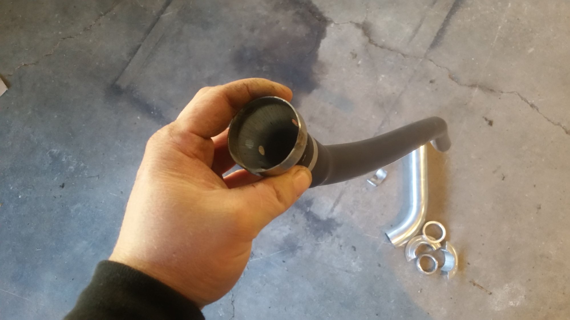

I ordered a cheap ebay filler neck for the rear tank of an 80s f150, I then cut it all up and used the innner tube in my 73 filler tube. Won't know for sure if it works until tomarrow.
Warranty voided
Part i needed
This cut helped me get it into the tank easier
Trim for vent hose
swear at it until you get it worked all the way in
Ugly spot weld
Done
Had to trim the extra catches off cap but still fits and seals

filled it up this morning and it fills alot better, still can't wide open with the nozzle but 3/4 works fine. I should have put the tube a little farther down the neck because with the angle of the gas nozzle i can insert it all the way but i can and might correct that later but for no its much better
