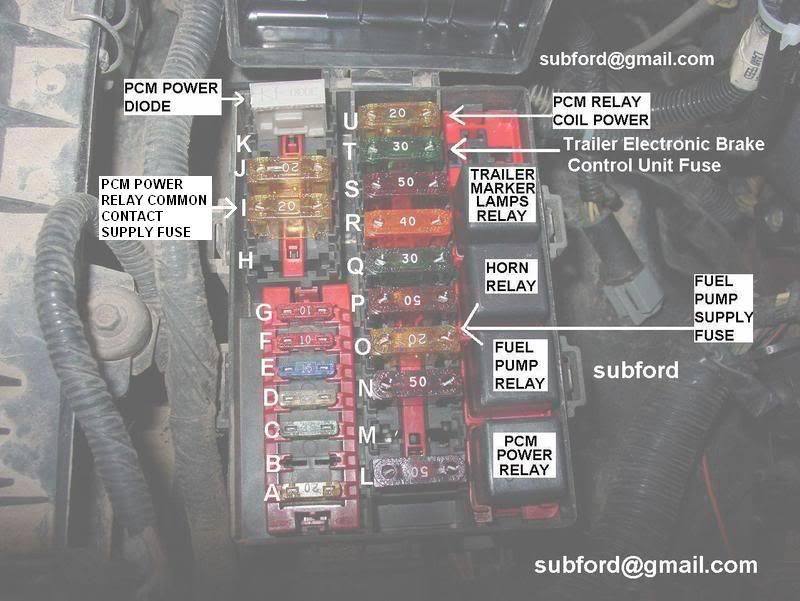

I follow your steps but I cannot find right fuses and relays. Here are fuse boxes that I have in my Van:
This is under steering wheel
This one under the hood:
Also I have two unplugged connectors which I don't know their purposes:
regards

Now that you have a pic, go ahead and remove all those fuses, diode and relay's. Spray the whole box with some electrical cleaner if you have it, or wd-40 if you don't will be ok. Spray up all the fuses and relay's too. With everything all clean now, start inspecting the fuses and replace any blown. I see a couple split open ones that should be replaced.........well looks like all 4 actually. That whole row of small ones are cracked.
You can look in your owners manual for the fuse locations or try a google search. That or just see if you have any larger blown fuses (the maxi fuses) if not, just trade those relays and toot the horn. If one is bad, the horn wont toot when you try one. Toss that in the garbage and when the horn toots, put that one in the trans location. It's the upper one as shown in the diagram. Then you'll have to replace the one for the horn latter.
The plugs are where you plug in an OBD1 code reader to read codes from the trans. Something you don't read right now, as your issue is already known (trans not getting power, which is why you have high gear start in D, as already pointed out by Mark, above.)
