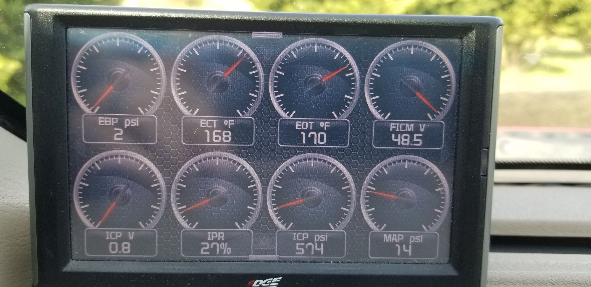

This is engine running but not at operating temp

This is after the truck has been idleing for about 20 minutes.

EBP looks ok, but can you get the MAP sensor to increase?
Also, it would be good to see FICM VPower and LPower

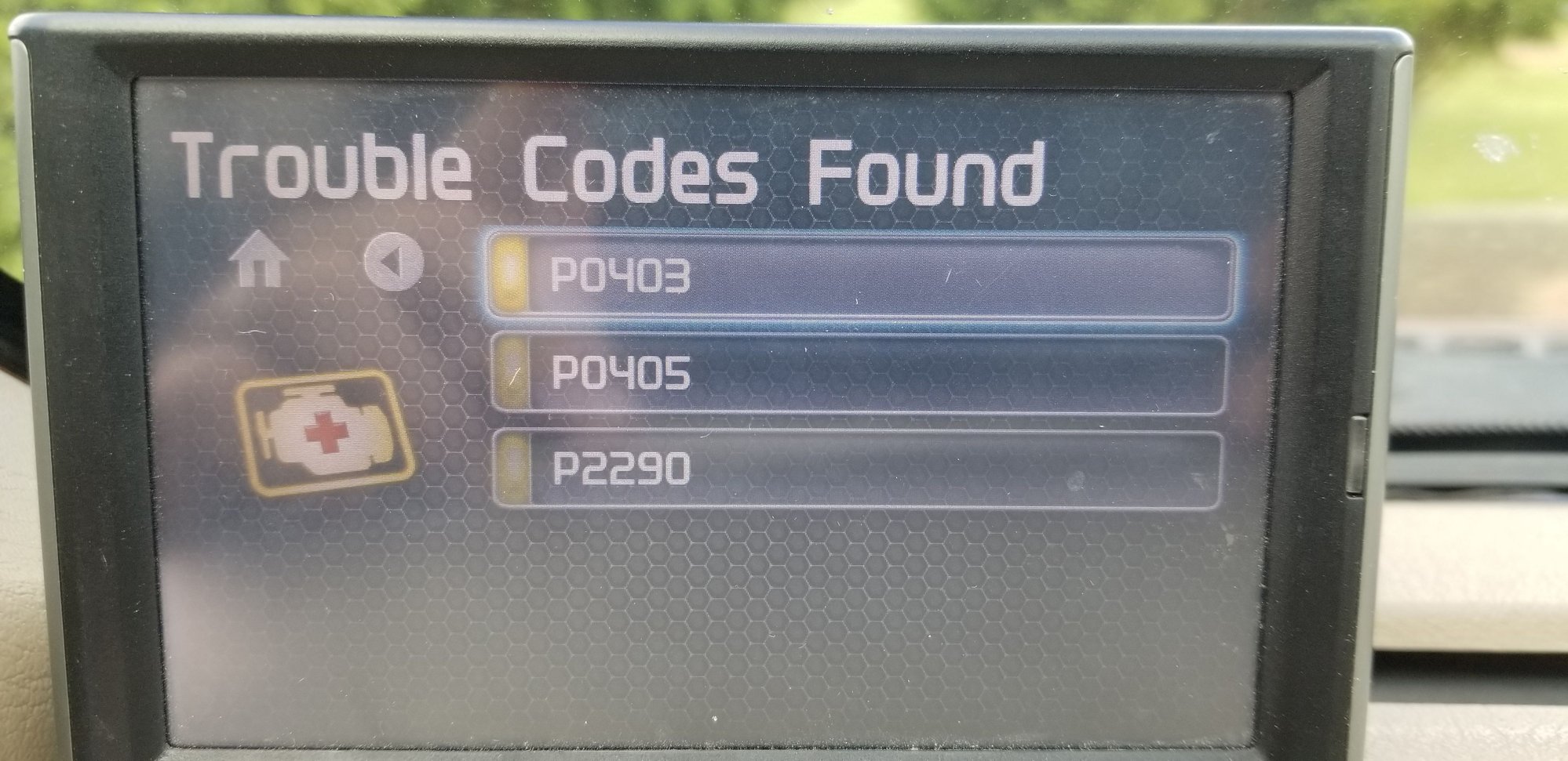

WOT
Not WOT but truck seemed pretty slugish when pic was taken.
After i got home from my test drive only code to come back minus the EGR codes was the P2290.

Im not sure what you mean be FICM V power and L power. Only thing the edge shows me is Ficm voltage which is 48.5 and the ficm sync which said 1.
