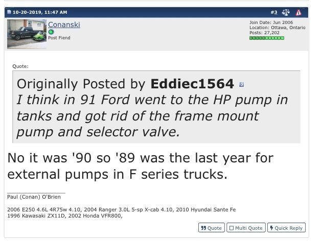

Wen did Ford switch to the "newer" FDM system? I know there was a different system in the 80s and sometime before the mid-90s they had switched to the FDMs with no separate switching valve. He's running a '91 which is in my gray zone. I don't know if that would be the earlier or later system.

I am going by this statement in a different post.
