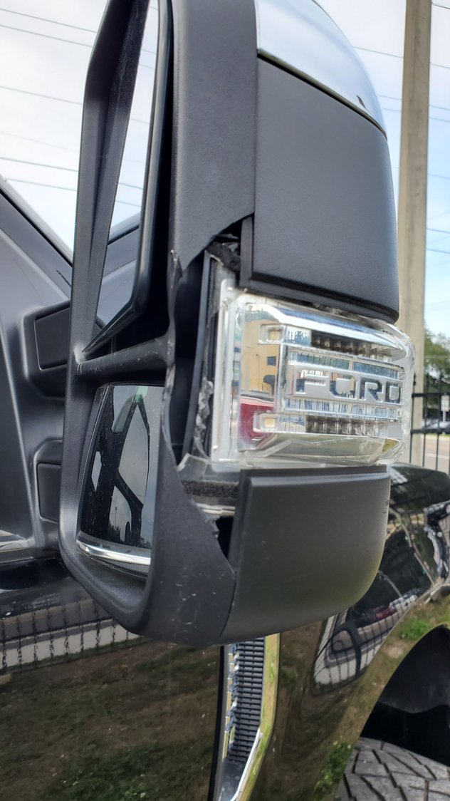

Also, the passanger side mirror has a crack in the housing, I tried looking for just the part but couldn't find it. Do I have to replace the whole mirror or is there a part number on just the housing that's cracked. Thanks.

No parts are available to repair the mirror. You might can find a used mirror to scavenge parts off. Else, only option is leave it as is or buy a new mirror. Not sure if the manual tow mirror covers will swap or not.

Darn, I was hoping I could find a cheaper route. I'll give the salvage yard a shot before ordering a replacement.

I'm wondering if you could buy a cheaper aftermarket mirror and use the housing with your guts? There are some posts here and possibly in the 17+ Super Duty section about taking one apart.

My wife tagged my mirror on something and destroyed it, I got a replacement off Ebay for ~$500 that was new but without packaging, you have to just find the one with all the options. On a Platinum you probably have the same options mine had, power fold, power extend, heated, puddle lamp, temp sensor, BLIS and I think that is it. There are a bunch of different part numbers for the color matched/chrome caps options, but as long as the cap isn't damaged you can swap it to the new mirror fairly easily which is what I did.
Edit: Physically swapping the mirror is a trivial task, you just pop off the interior trim and there are 2 bolts under the trip and 2 bolts in front of the trim and then the electrical connector and it just comes off.
