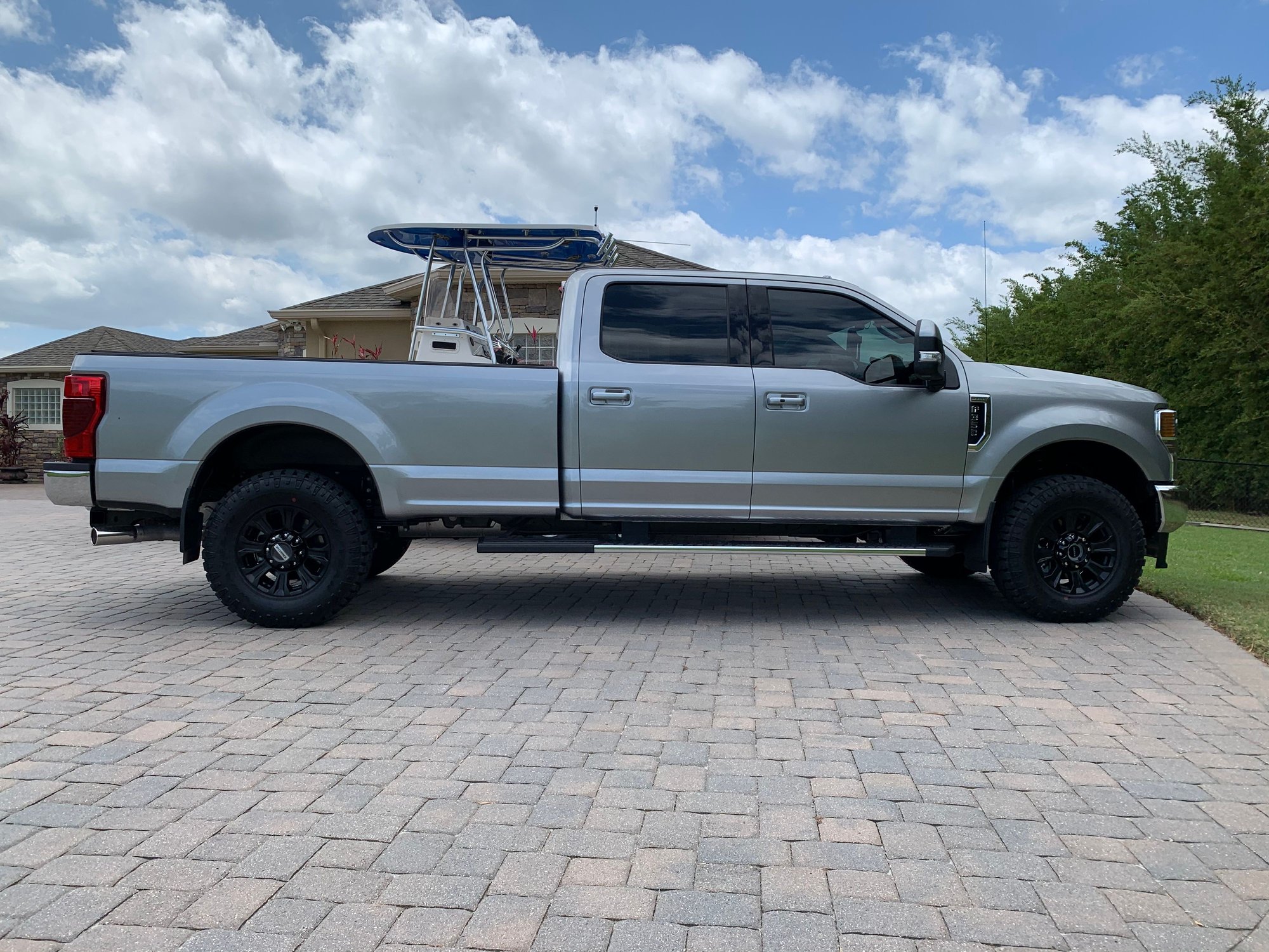

Stock 2020 Fx4 F350 with no lift or level. 35” Tremor take off tires & wheels.

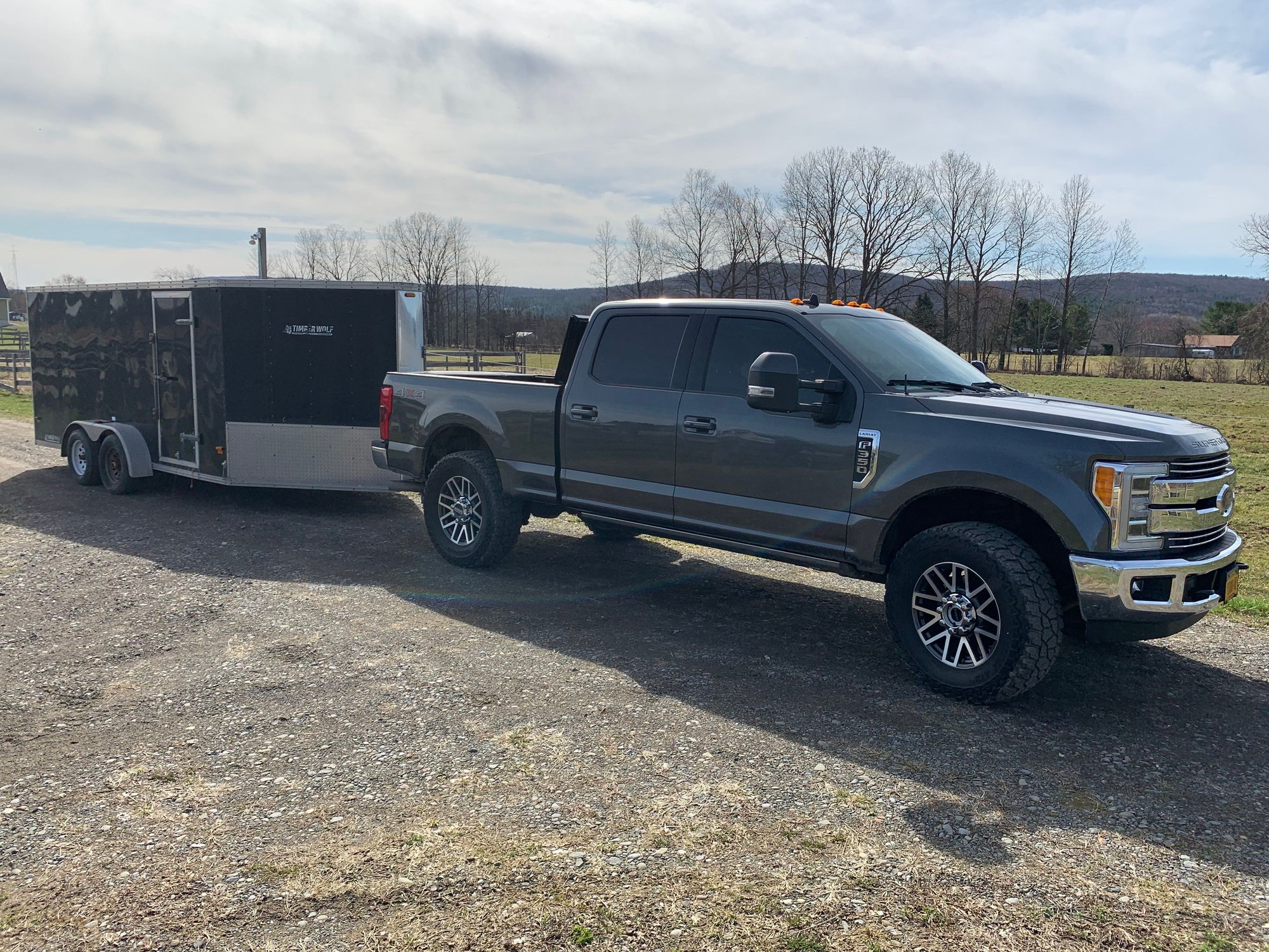

37” well documented on here. I have fairly aggressive off road use. No body contact what so ever. Contact begins at 38 degrees of steering angle (of 40 degrees) with sway bar and radius arms. You can find my thread on modifying those to be no rub.
not for everyone, but you asked biggest.

No rubbing or clearance issues of any kind. Towing is also a non issue.

Depending on the options or capabilities you need the FX4 is a smart choice. I wanted the larger gas tank & 8’ bed so that ruled the Tremor out.

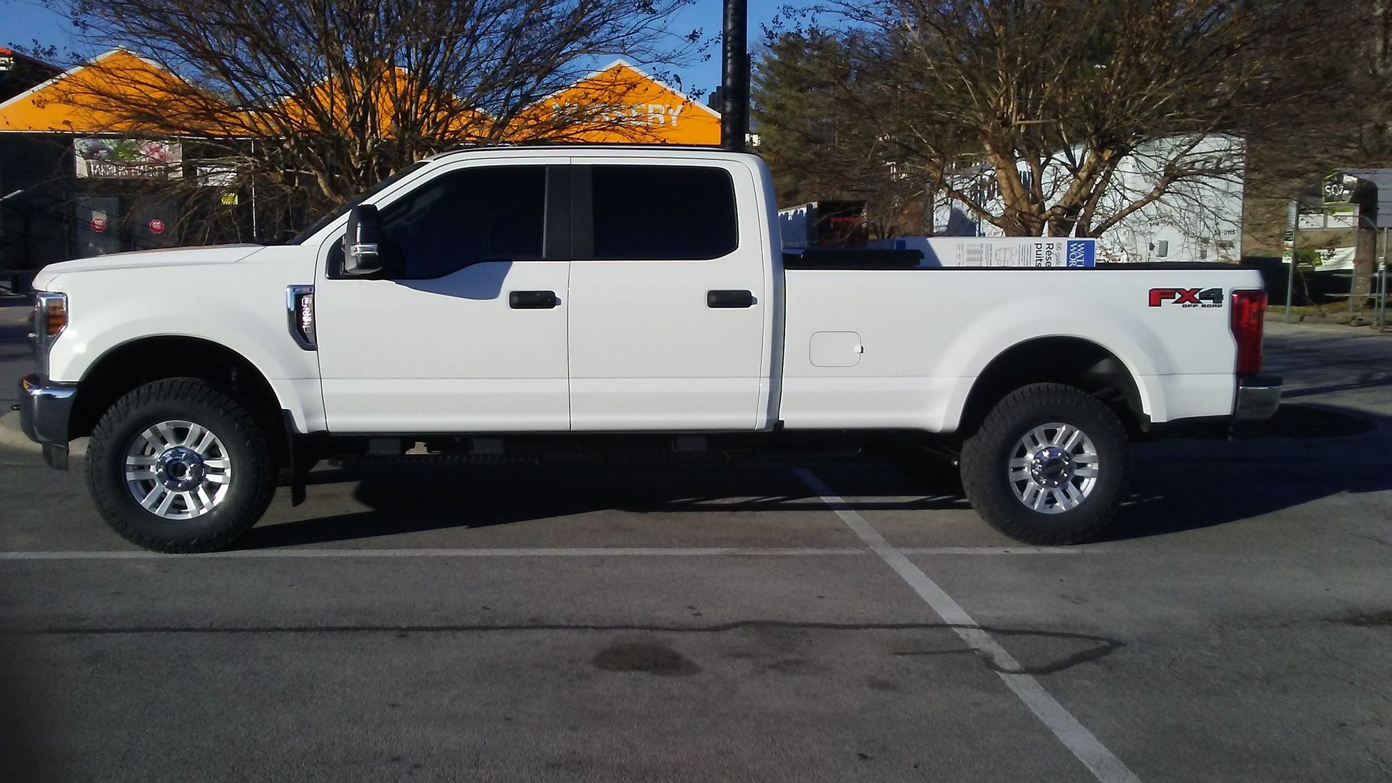

check out that killer paver parking area driveway......oh sorry what were we talking about?!? Yeah here is a stock 19 FX4 with 35ish 285 75 18. Junk the stock shocks put some Fox in there
