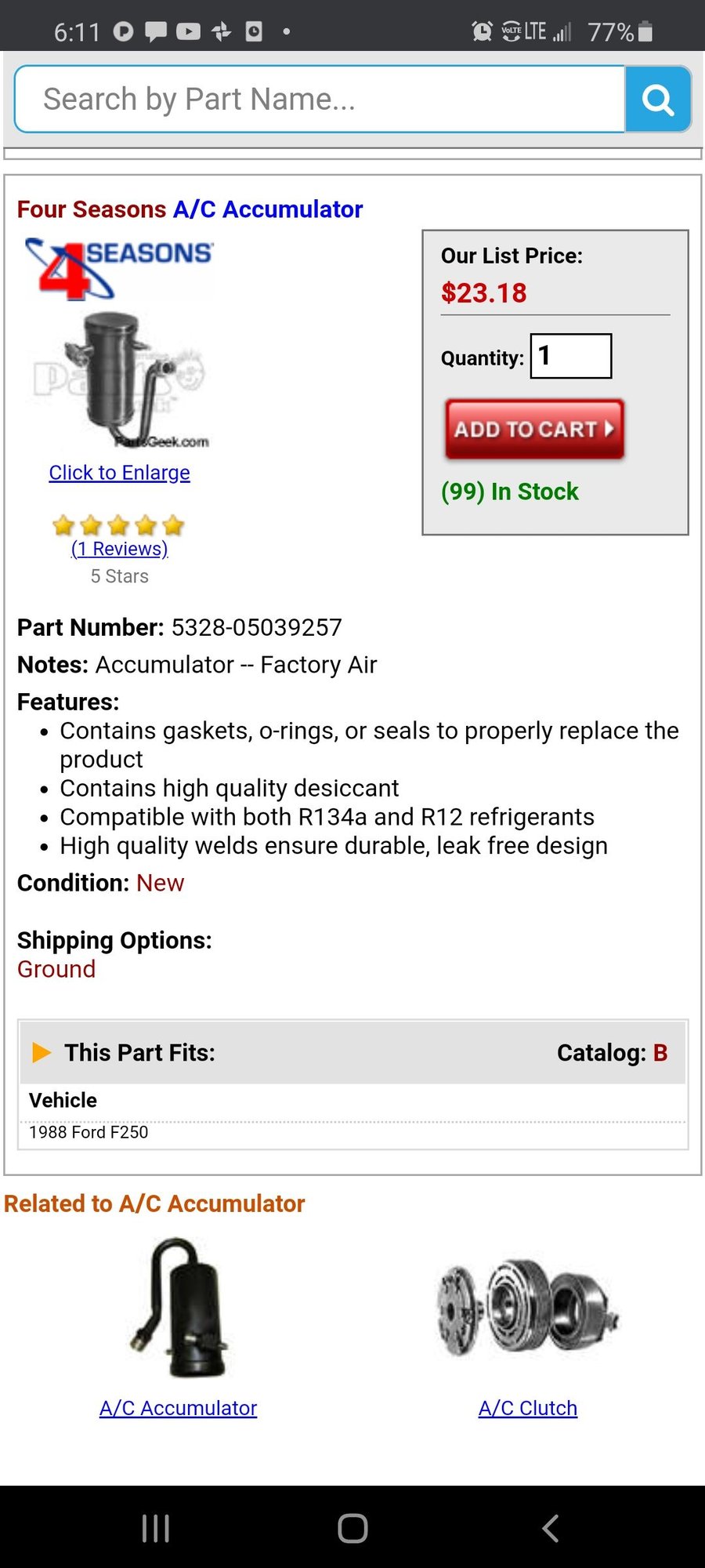

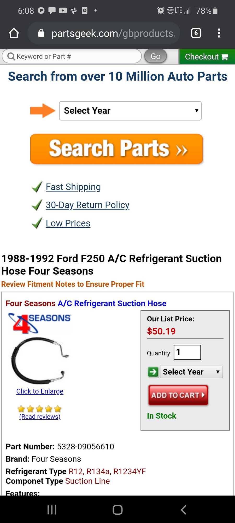

No, unfortunately not. I didnt get any of the A/C or radiator parts with the 6.9. Just re-using the gasser one. That is a lot of parts, but I'm glad they are available! Thanks for the part numbers!

Without the diesel condenser only the suction hose will work for you. The discharge and the liquid line will need to be custom made.
