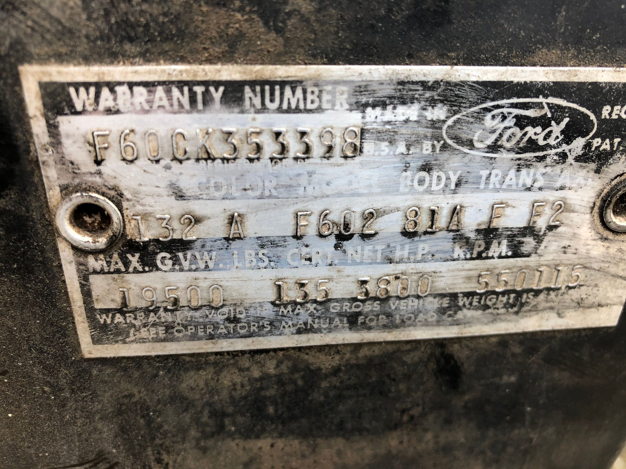

I just bought a 1963 F600 dump truck. The good, it starts, runs, and the PTO/hydraulics work, bed lifts, and clean title. The bad news, head gasket must be blown, the dipstick was a creamy white. I didn't let that stop me. They really shouldn't give me days off in the middle of all this shelter in place. I loved the body style. My addiction started with a 1965 F100, step side, with a 352. I loved that truck but was not in a place where I could restore it as it needed. It was a California truck. I am in the St. Louis area. For now, it's parked on my property. Next I have to find a manual and figure out how to remove the engine so it can be rebuilt. I am a newbie to this. And just for grins, what do you think it's worth? There is significant rust in the floor pans, like I can see daylight on both sides. The dump bed is solid and in good shape. Thanks. Like I wasn't dropping enough on things that go bang.
F600K353398 132 A F602 81(A?) F F2

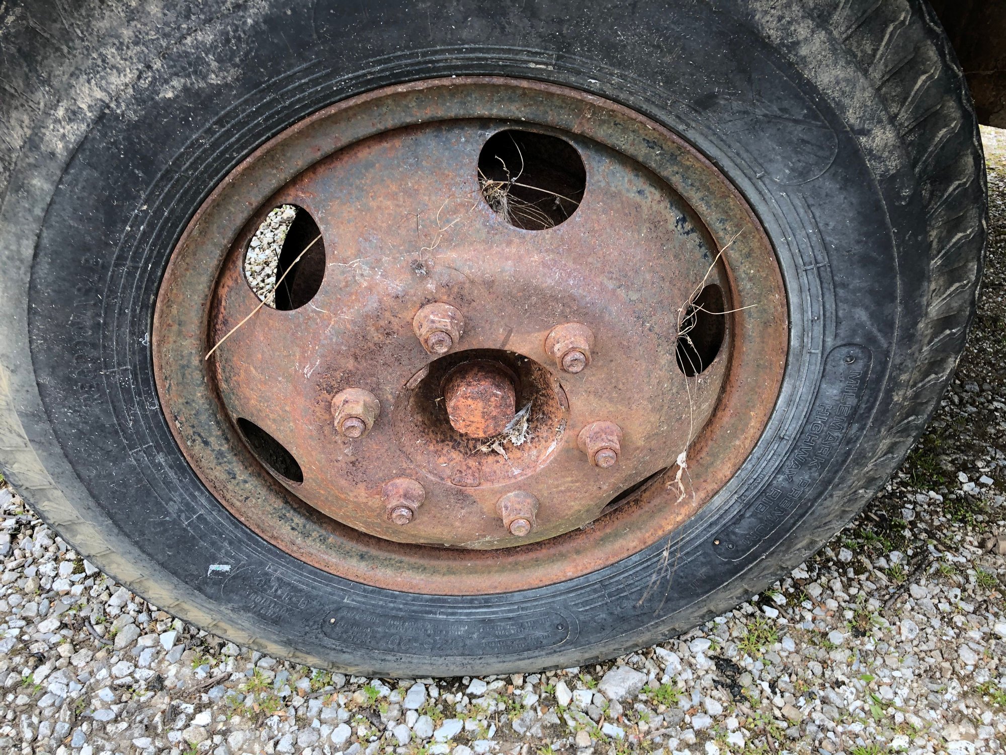

Add my welcome here too. I started off the conversation on your thread over on the 61-66 forum. Please post pictures of its wheels front and rear. Stu
F60 = F600 (gas).
C = 292 2V
K = Kansas City MO Assembly Plant.
353398 = 1963, assembled November 1962.
132" Wheelbase.
A = Raven Black.
F602 = F600 (gas), 19500 lbs. GVWR
81A = Standard Cab.
F = Borg-Warner T-98 4 Speed Manual Transmission.
F2: Eaton model 13800 Two Speed Rear Axle // 6.33/8.81 // 14,000 lbs. Rear Axle Capacity.
19,500 lbs. Gross Vehicle Weight Rating.
135 net HP @ 3,800 RPM
550115:
55 = St. Louis MO Ford District Sales Office, where the original selling dealer ordered the truck from.
0115 = Domestic Special Order number, truck ordered special by the original purchaser, not "bought off the lot."

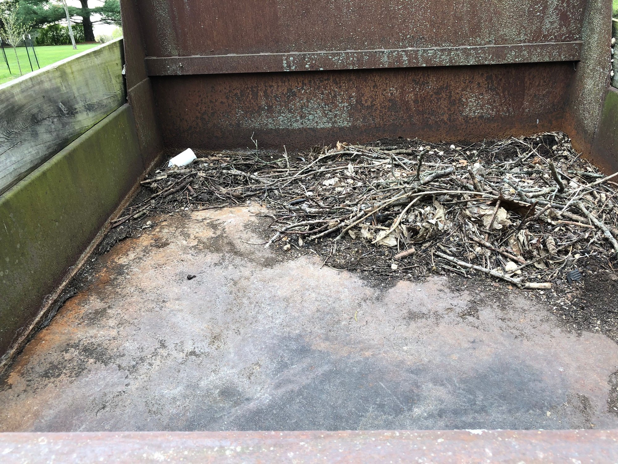

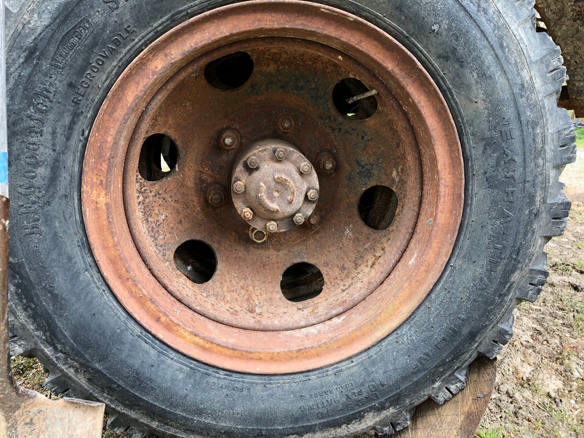

Pics

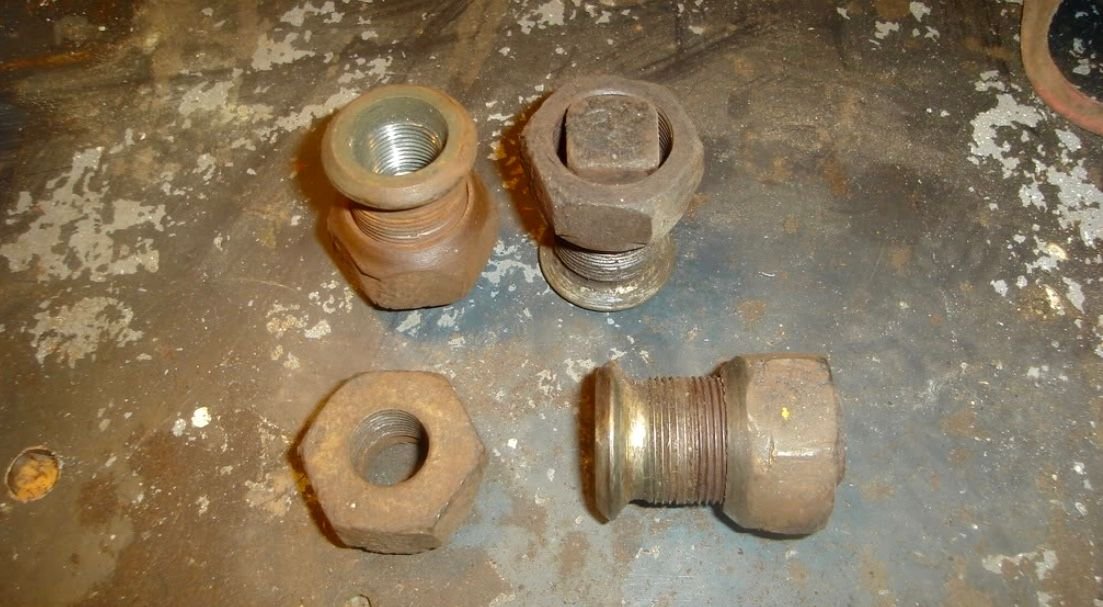

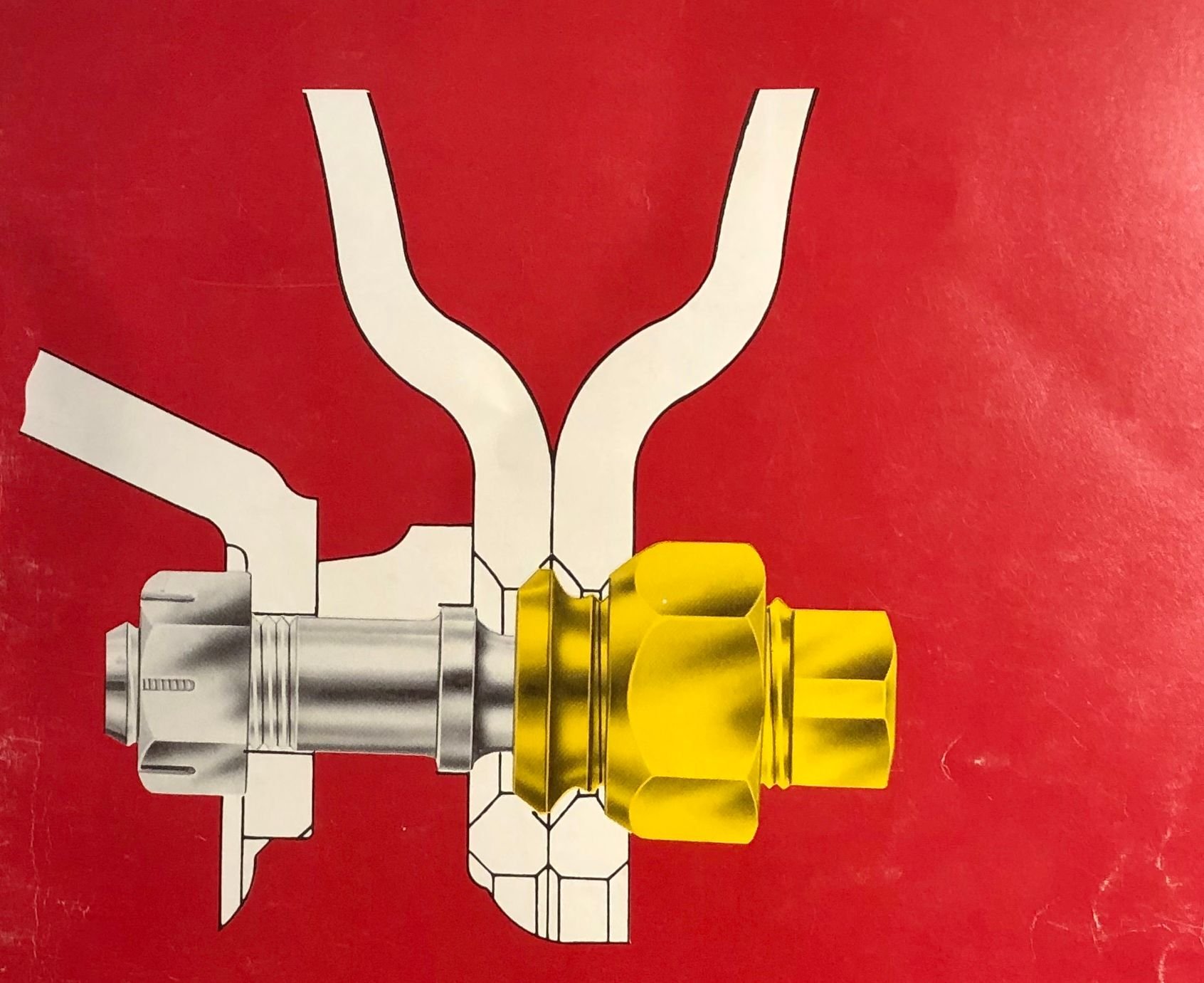

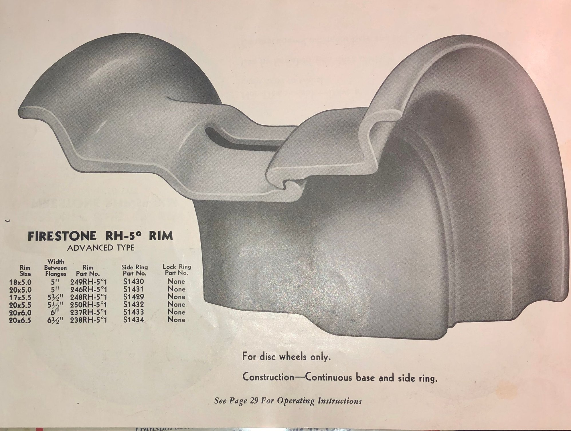

Hub piloted widow maker Firestone RH-5°s. I’m gonna go into this and probably belabor every point assuming it’s new information to you. Below are pictures of the RH-5° showing how it goes together - and can violently come apart. Do not attempt to mess with them yourself unless it is to pull the valve stems releasing the air. Be especially careful around the outer duals.
The hub piloted mounting system was only used on early Fords in 1963 and 1964. Below is a picture of this system that was pioneered by Motor Wheel Spoksteel in the 1930s.
There are no similar wheels today that are either the safer locking side ring 20” or tubeless 22.5” styles. This will thus require that the wheels be replaced with more traditional stud piloted wheels. You would be best to buy new fasteners. I’m quite sure that your current lug nuts are all right hand threaded. Ford references have this wrong stating that the truck has left hand threads on the left side and right hand threads on the right. Before buying new fasteners make sure I’m right (or wrong) on this. This modification does not require replacing wheel studs. Pictures below.
Replacement wheels having the 6 x 8.75” pattern have been discussed here a lot. A good source would be a military surplus dealer. That is discussed in the below old threads. Stu
https://www.ford-trucks.com/forums/1...s-on-f600.html
https://www.ford-trucks.com/forums/1...em-solved.html

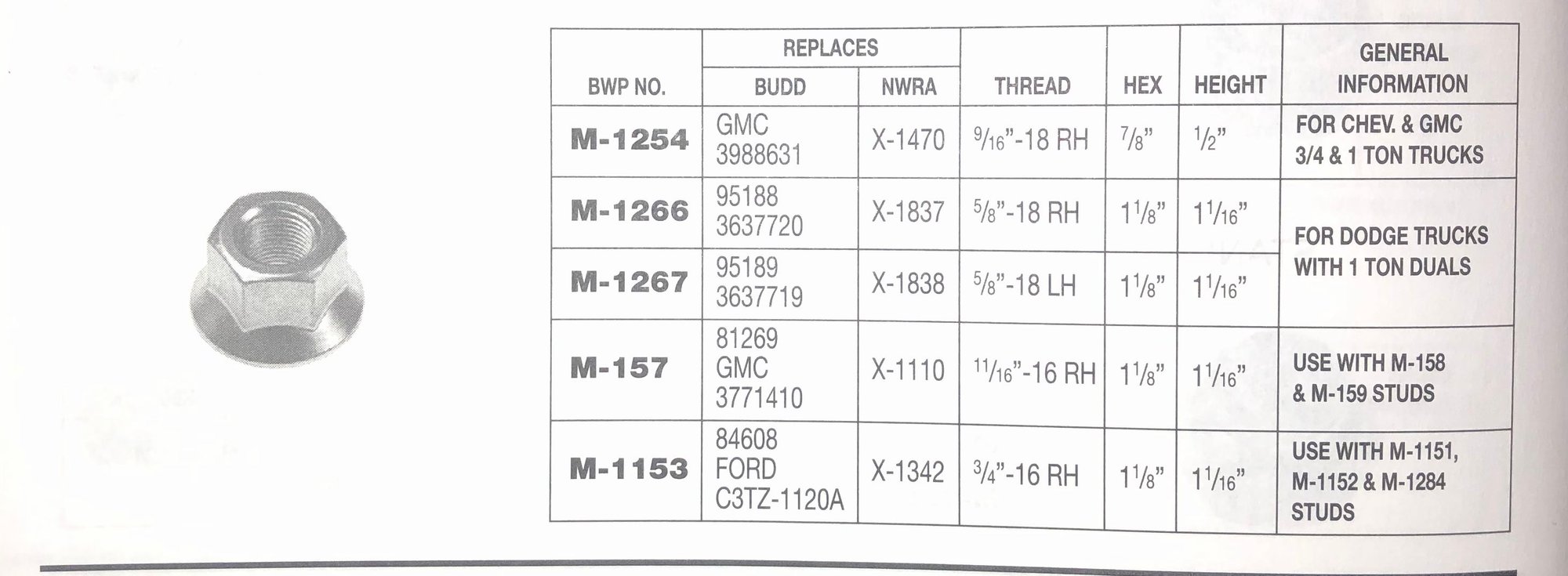

I’d like to take another shot at this to hopefully save davidg from twisting off wheel lugs on the left side of his truck. Plus hopefully he reports back what he finds on the truck to settle whether the Ford reference is right, or the numerous other industry references. Bill (ND) will agree I’m sure that the Chassis Catalog shows both right and left hand threaded fasteners used on the 63/64 F/B/N-600 trucks. But every period industry reference I have, as well as current on-line references I checked, show only right hand threads used on hub piloted mountings. The below shows the NWRA code for these original lug nuts to be X-1342 which crosses to Ford C3TZ 1120-A. This is a right hand threaded nut, with no left hand equal cited.
When davidg swaps out his widow makers for safer stud piloted wheels these original lug nuts won’t work on the replacement wheels. Either all new Budd style nuts, or saved right hand threaded used ones from the donor truck, will be needed. The original wheel lugs on the truck can be left in place and used with the new stud piloted fasteners. Additional right hand threaded nuts will be needed for the other side of the truck.
If all this proves wrong (and the Ford catalog correct) those of us that help with wheel questions will want to know. The next guy that shows up with a 63/64 F-600 will be helped. Stu
