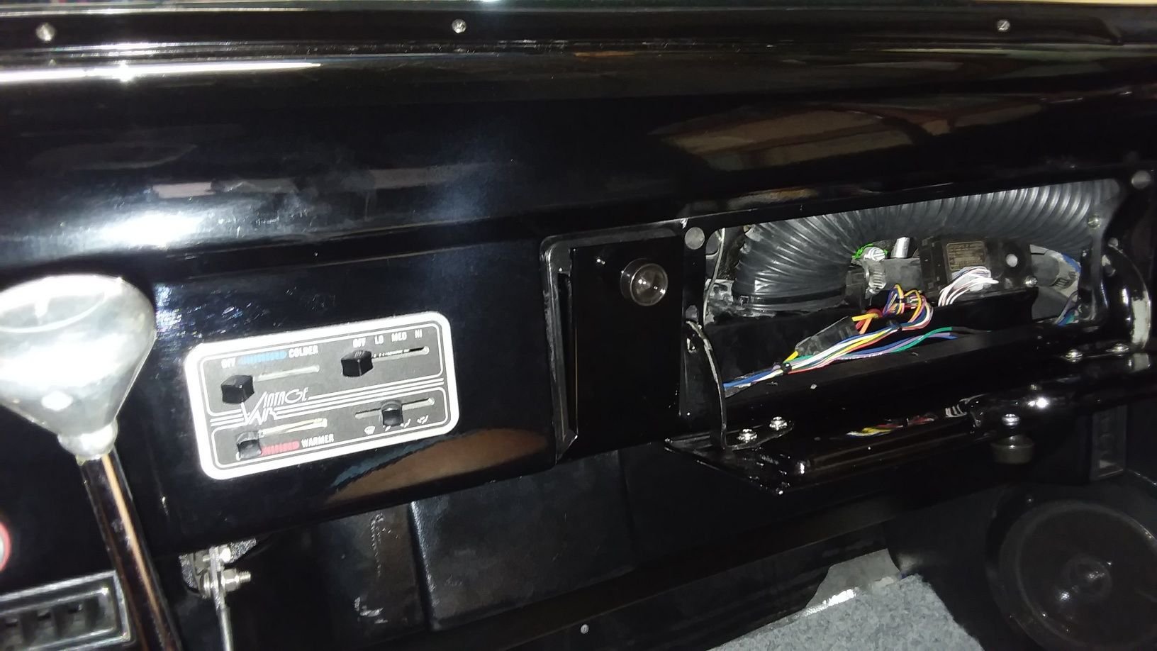

Can only speak for the Vintage Air units I have in both my 56's , looks of cool air, have to keep it turned down in the pickup, but need it turned up a little higher in my panel. Made my own dash extensions for both trucks.

I ended up pulling the AC because it was just too clumsy under the hood, but the heater works great, original defrost vents plus the two slim vents either side of the dash and the foot vents built into the heater core under the dash. Controls are in the radio hole with an oak bezel.

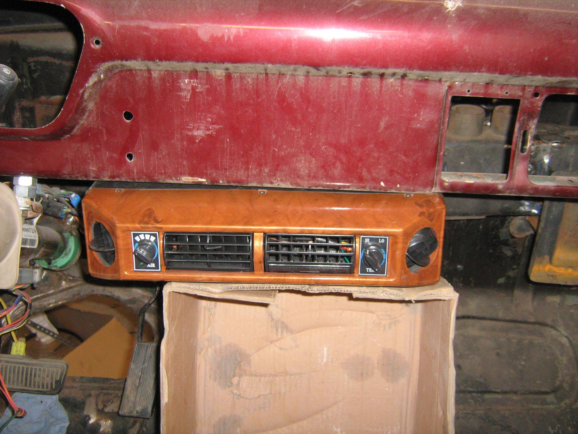

I am going under dash but not because of quality or fitment , simply because I'm CHEAP . My donor engine had air so this is as simple as it gets , use the under hood stuff from the donor and run the lines in to the under dash which if fully self contained .
Sitting on a box for checking for fitment .

Here I thought the box was your console keeping with your theme...lol

I would have to look up the dimensions of mine but it was pretty much the shallowest I could find at the time and my pic is as far back as it has room .
