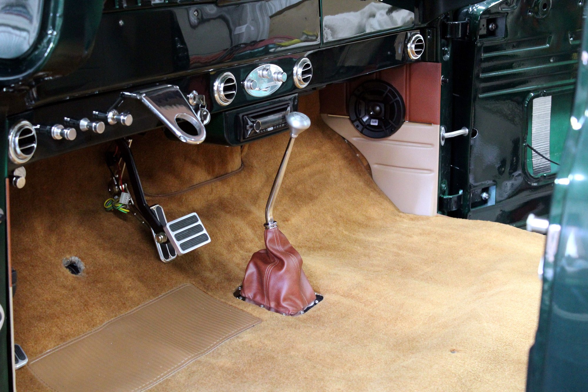

Can only speak for the Vintage Air units I have in both my 56's , looks of cool air, have to keep it turned down in the pickup, but need it turned up a little higher in my panel. Made my own dash extensions for both trucks.
Would you mind sharing some more info and pics on your Vintage air setup? I like the look of the control panel you have on the green one as well as the vents. Which Vintage air system did you use, etc..?

I used the https://www.vintageair.com/search-re...it%2056%20f100 but didn't use the defusers that came with the kit or the dash extension. Bought the round defusers separately and made the metal extension. The controls are an oval billet controls are an option . The controls in the kit are like the ones in my panel.. I also bought a Y fitting to feed the 2 center defusers..
