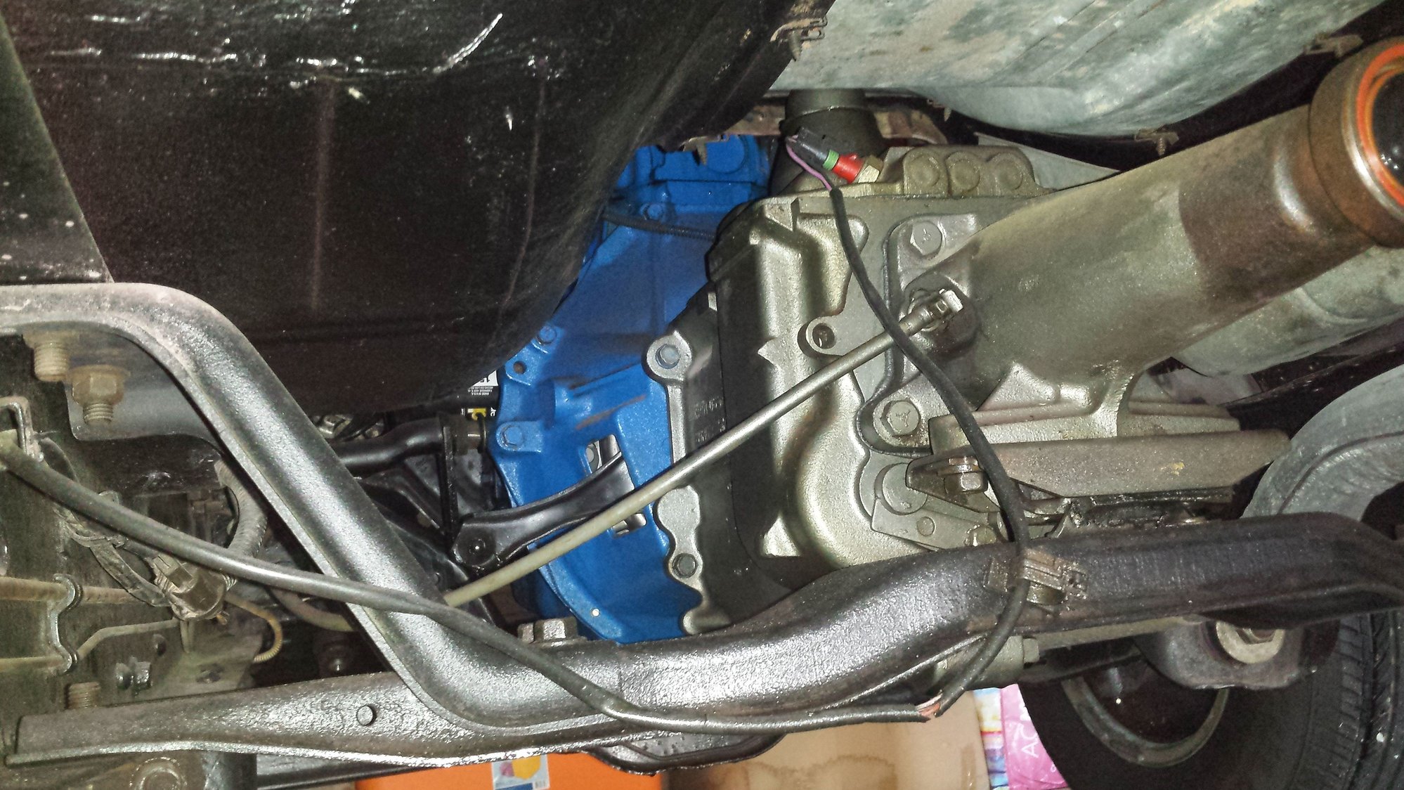

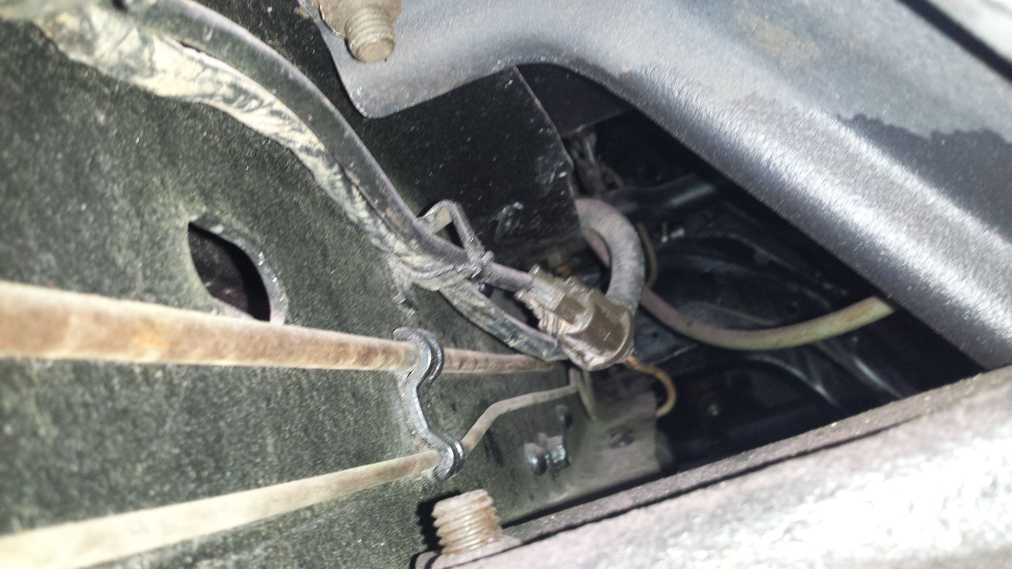

Old Apr 13, 2020 | 02:23 PM
FuzzFace2's Avatar
FuzzFace2
Posts: 30,915
Likes: 4,123
From: Angier, NC
Dave ----

Old Apr 13, 2020 | 02:31 PM
FuzzFace2's Avatar
FuzzFace2
Posts: 30,915
Likes: 4,123
From: Angier, NC
NP happy to help.
The truck was inside and the water has dripped off it from the rain coming back from work this morning so was not to bad.
Hard part was getting my fat azz up off the floor
Dave ----
