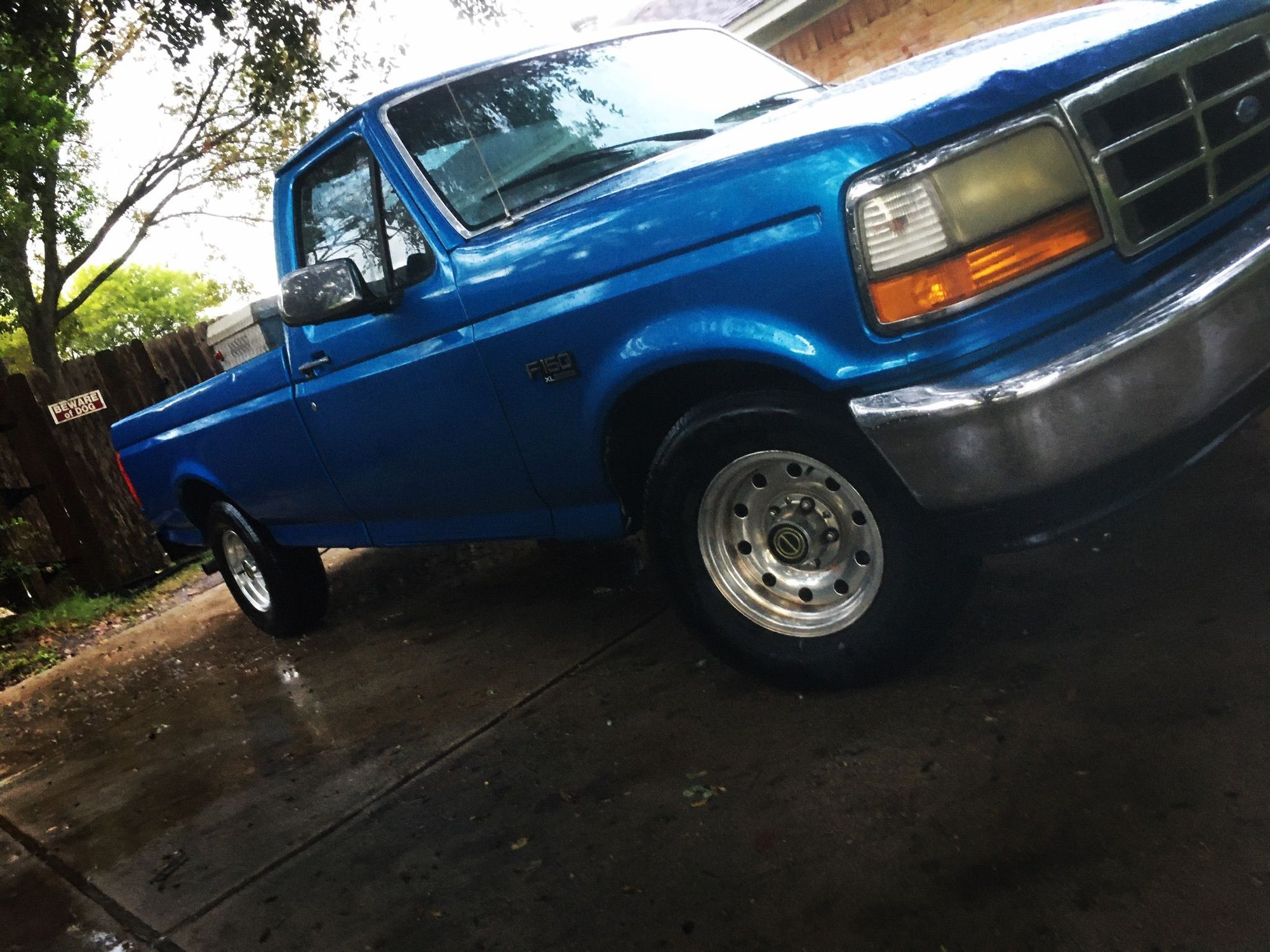

Originally Posted by crashtestdummy
It appears to me that you have a problem with your ground wires on the rear left frame rail. Your gas gauge is pegged for the same reason. Your ignition switch may also be going out, not the key switch but the switch lower on the steering column. The 300 is an awesome engine but I think you need to think about buying the same truck just one that is in better shape and use the old one as a parts donor.
I’m good on the comment about buying a new one and using old one for parts. Look how gorgeous she is
