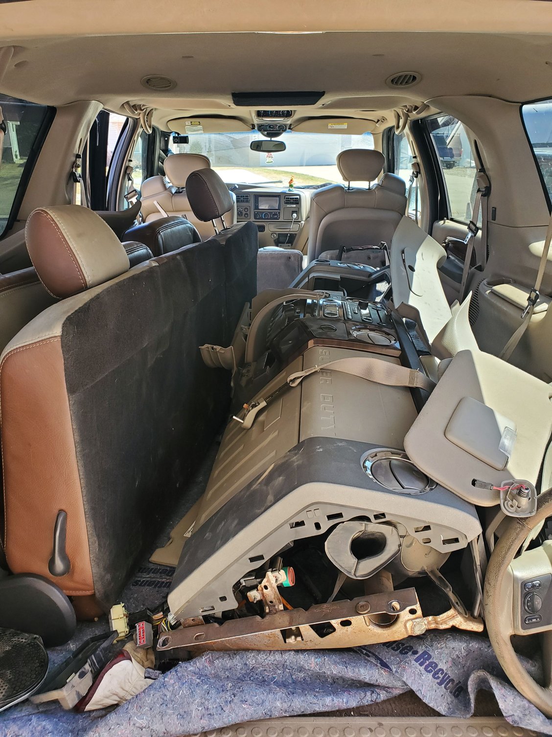

Im new to the forum. I have a 2000 excursion 7.3 in which i have decided to do a full interior swap. I bought an entire cabellas interior from an f350 amd plan to install it.
I started tackling it today so i figured id post a bit of progress and see if you guys can give me any guidance. I feel pretty confident i can do it only thing that will take me some time is the dash.

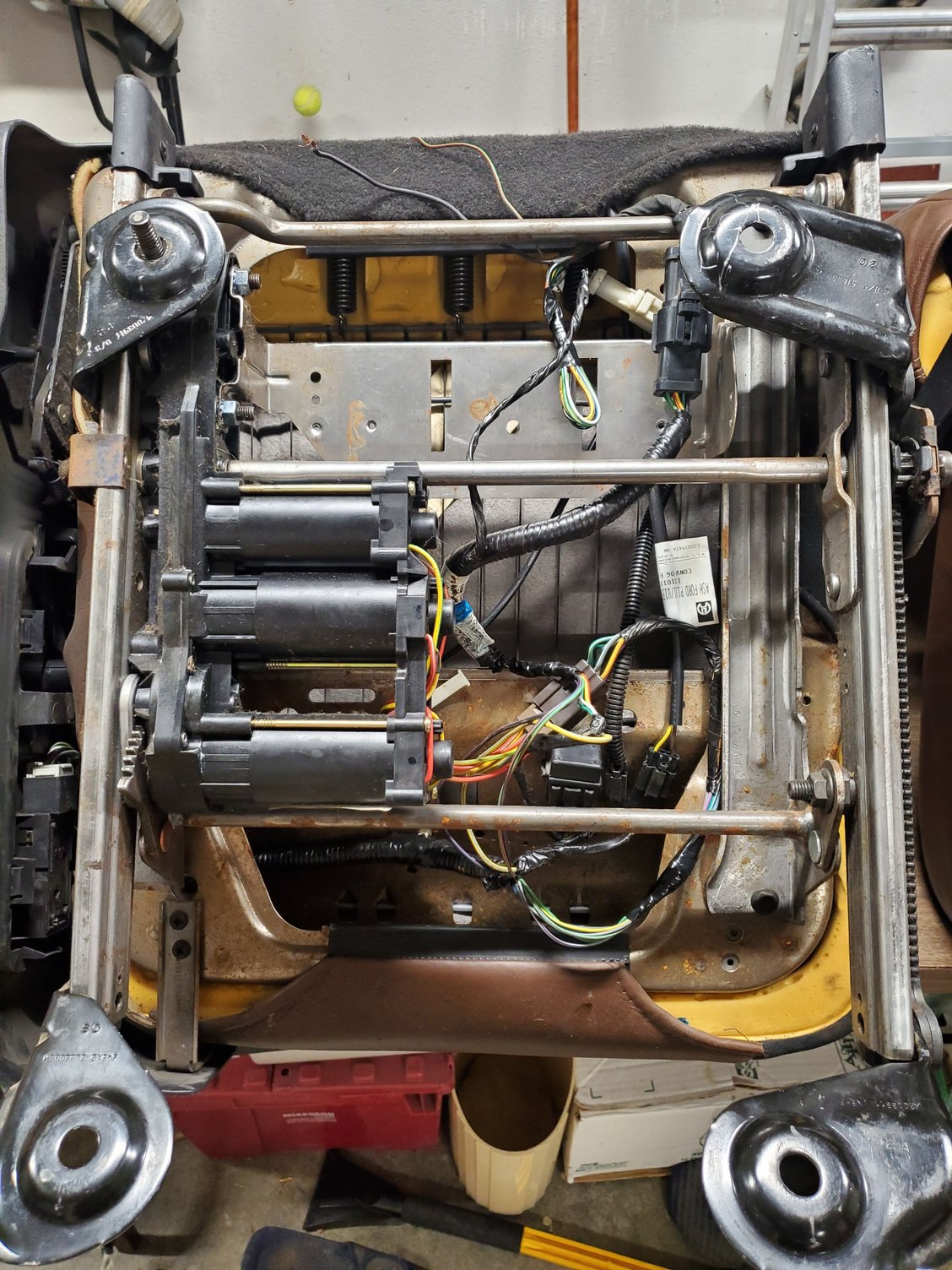

Heres a few pictures of what ive done so far. I also took a few videos to explain the wiring. If anyone would like help let me know. I explain things for the dumb 😅 like i said i have a video of the wiring for the front seats and can easily explain how to bypass the module on the bottom of the drivers seat. Save yourself the headache, strip plastic covering off the wires and cut everything that connects to the control module about 3" back from the module connections and remove all that wiring.
Ill take a bunch more pics tomorrow. For now i have a couple of my ex and a few of the whole interior i bought hahaha. Tackling door panels and 08 mirrors tomorrow

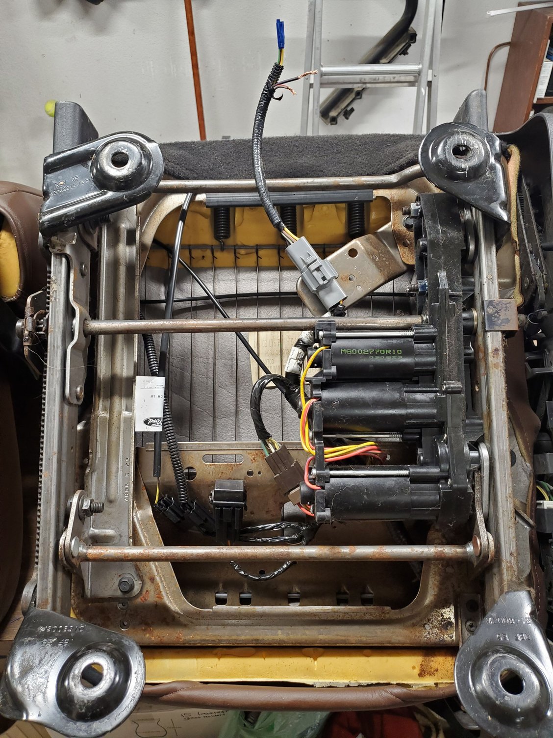

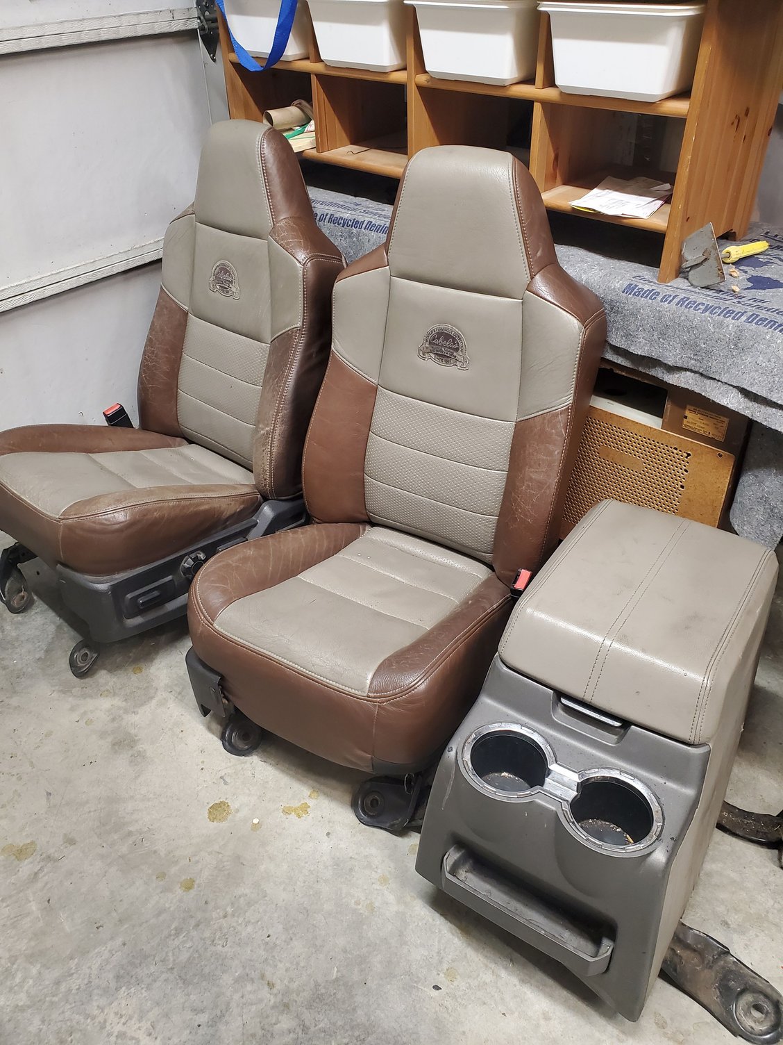

Heres a few pics of the 2 front seat after i rewired them
Driver seat once rewired and memory module removed Had to use a voltmeter from the switch to where 6 of the wires from the memory module go. Then i had to wire those 6 to another 6 wires. Thats where the voltmeter came i handy because those wires are for the motor. Once you determine your power wires with the voltmeter then you determine your clear passage for the remaining 6. Basically wire it to match the passenger seat.
Passenger seat

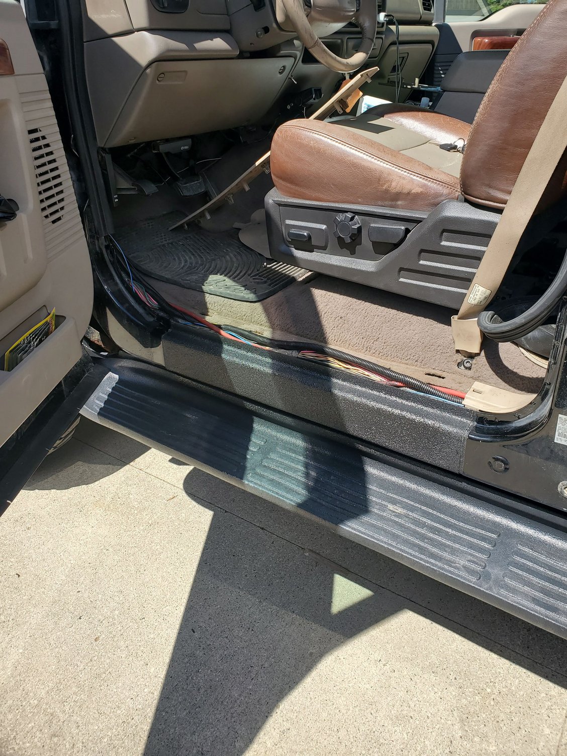

Now today, i got the door panels in and wired up except the mirrors. I also installed the mirrors but didn't wire them yet. Anyone have a good write up with pictures for a 2000 excursion that had those ****ty small mirrors? They were simply heated, power adjust.
Everything went awesome with the doors and bolting the front seats back in after rewiring them. Who ever posted that wiring diagram for the door wiring did an awesome job.

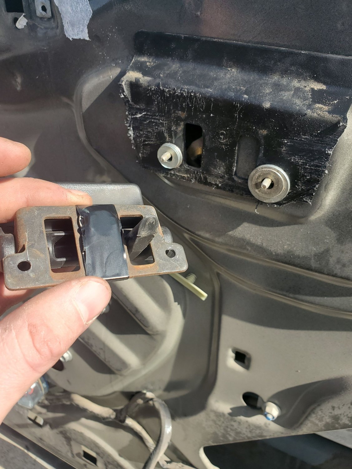

Forgot to take some pictures once i had the door panels all wired and mounted but i have a few of the modification i made to the handle of the existing excursion handle to make them work. Works awesome
Slight mod i made to the existing excursion handle. 1/8 space washers on the bottom and 1/4 on top. I literally wrapped electrical tape through the handle to hold the washers. Once its bolted up will never move. Noitce i also cut the cup area off the plastic to give me an extra 1/8"
Top view, all installed

h3ckler,
Your "original" front seats looked like they had built in seat belts.Just curious why and what you were doing with them.
Philip
Old Apr 13, 2020 | 03:02 PM
h3ckler's Avatar
h3ckler
Joined: Feb 2012
Posts: 25
Originally Posted by pkthomas
h3ckler,
Philip
Hey, i have already sold them all basically. Front back and console.
The previous owner had put those front ext superduty leather seats in before me so i just unbolted them and rewired the 08 seats.

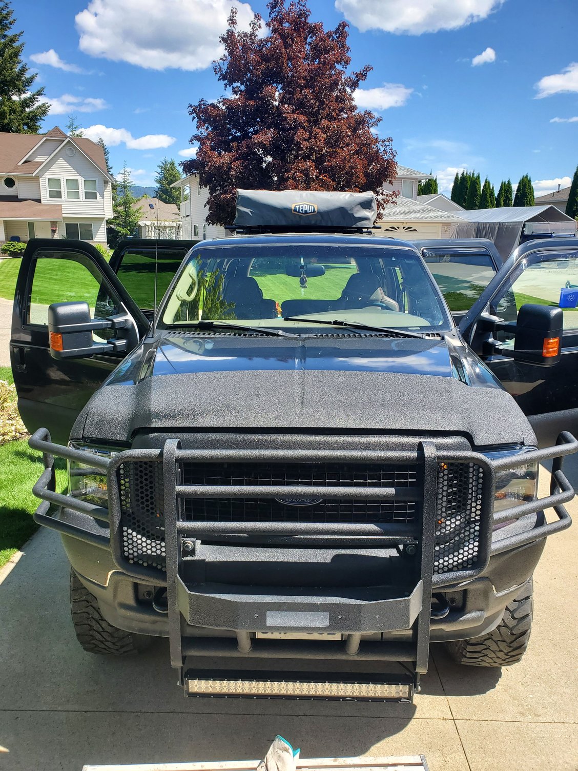

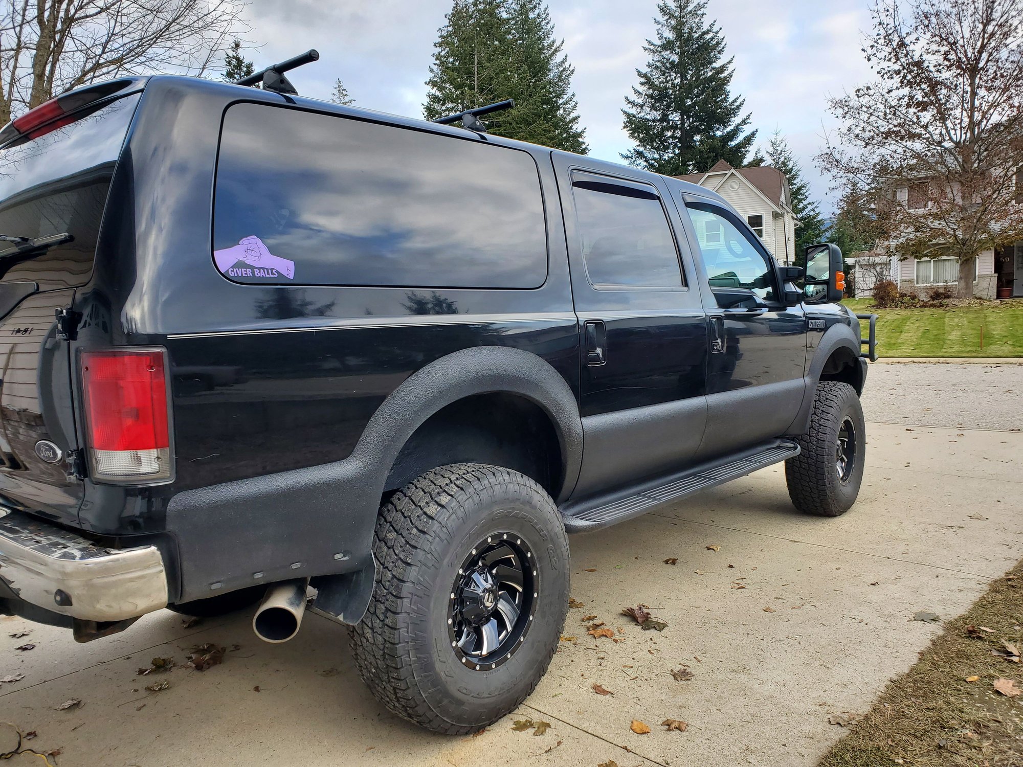

I've gotten door panels in the front, front seats, middle console, raptor lined a ton of the truck, replaced coolant reservoir, radiators, turbo, injectors, glow plugs, gaskets, put 37's on it etc.
Logging road adventures
Rock guarded hood
Rock guarded kick plates
Cabella front seats

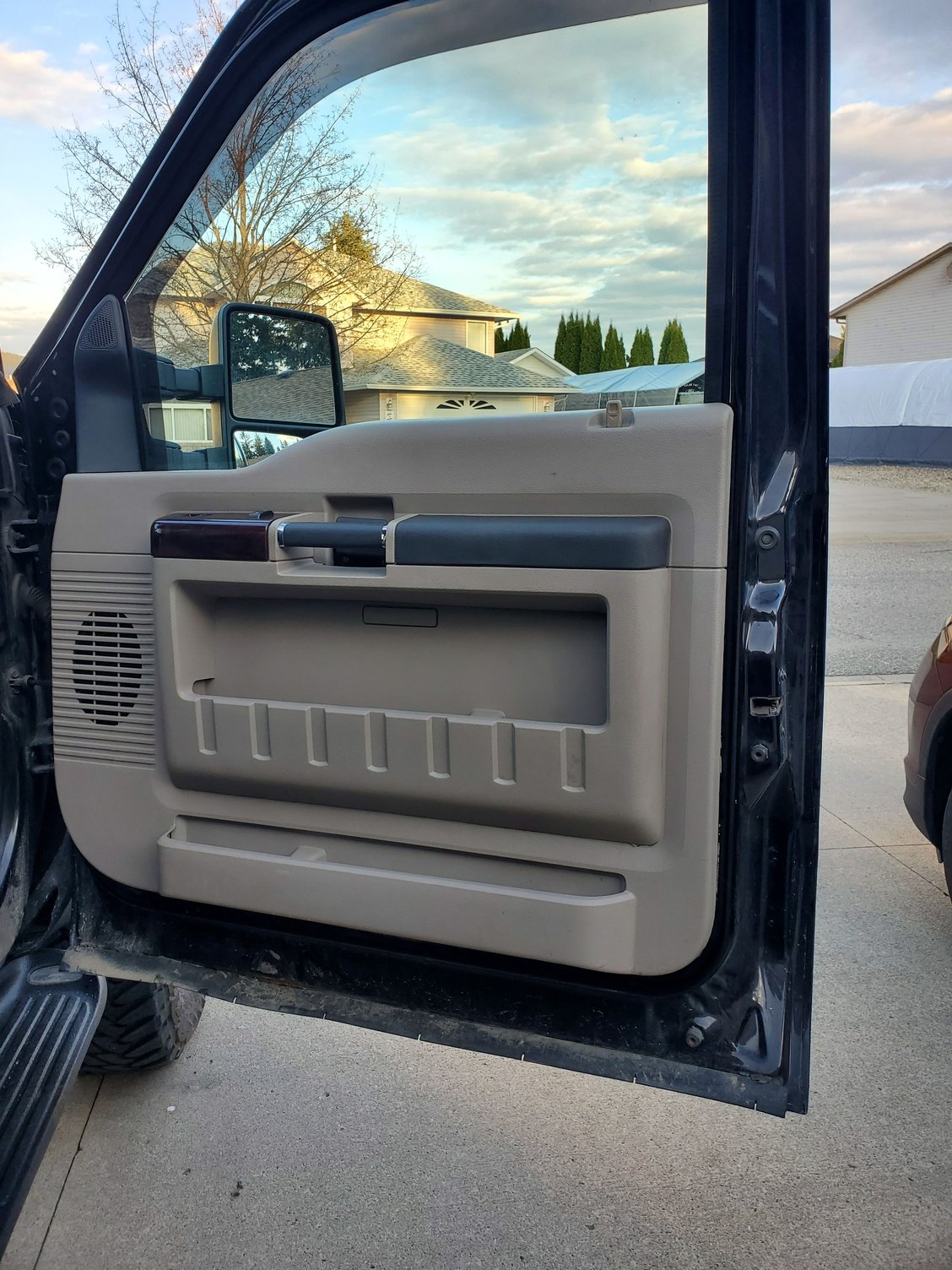

Front door panels with sony speakers
Rock guarded back, pre carpet reinstall and cleaning

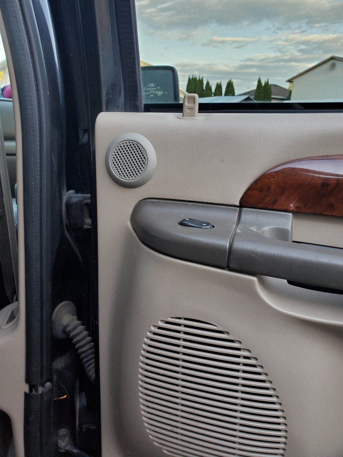

Tweeter wired in with sony speakers rear door, made a nice template for the plastic
Fresh 37's, nitto terra grapplers, highly recommended, had then on another truck, no road noise, 8 ply, good for offroad and wear evenly and last a long time

went from 3.73 gears to 4.56. way better gas mileage and no longer sluggish on hills. I would recommend this to anyone running a lift and 35+ tires.

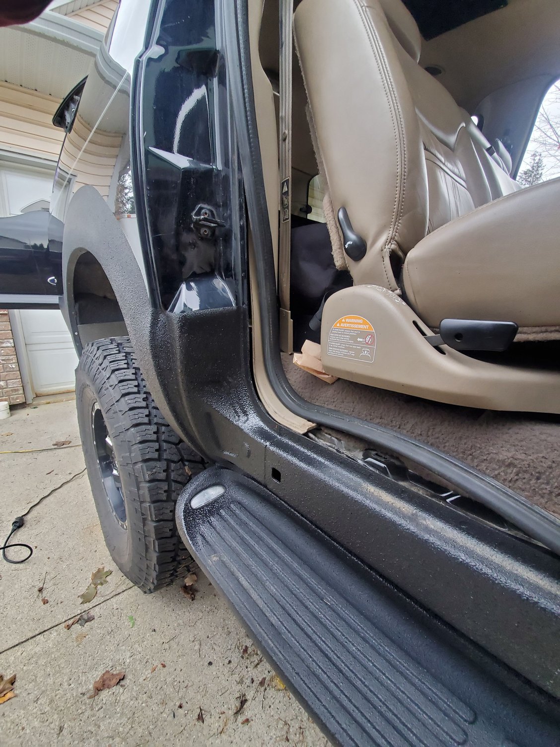

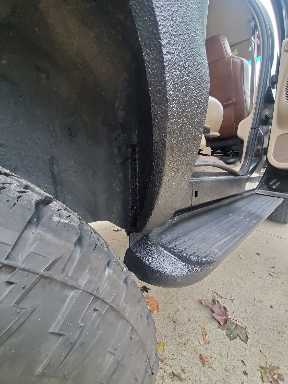

fixed some rust on the rear quarter panel in the fender area and did another coat of raptor liner on all the areas of the truck. will post pictures from my phone here shortly.
Old Nov 13, 2020 | 01:38 AM
h3ckler's Avatar
h3ckler
Joined: Feb 2012
Posts: 25
Ready to sit indoors for a week
Pre rust
Post rust once ground and filled
Post raptor liner, all fixed!
Also did in the door kick areas

It is really coming along great, what size Sony speaker did you use in your front door? I have only seen 6x9 and the door calls for 6x8, or did you fab an adapter? Keep us posted on you progress, Thanks.
