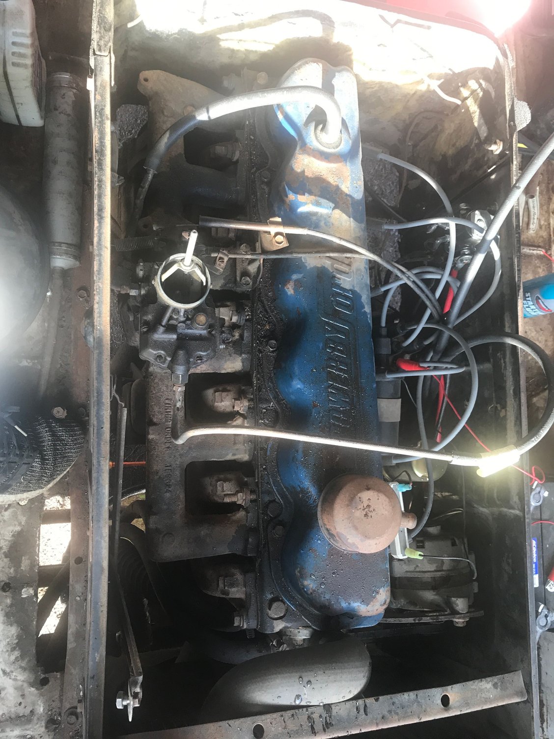

well you see the problem is I have no clue where to put the tranny fluid

67 should have a C-4 trans. trans fill and dipstick should be on the passenger side rear of the engine block, going down into either the trans pan, or lower side of the trans housing. the tube is around 1 inch in diameter.

there is no reservoir to be found
