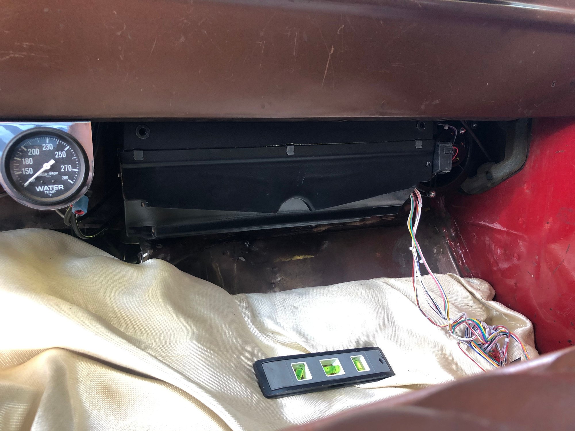

Here’s what and why I went the way I did. A fellow fabricator happens to have a mock-up vintage air gen II evaporator. I was able fit that up under the glove box area pretty easy. The reputation and sourcing thru summit of the gen II kinda made me forget about how awesome it would be to use my factory A/C controls so I went ahead and pieced together and purchased everything except hoses and fittings thru my summit pro shop discount. Evap, condenser, dryer w binary switch, compressor and 4 **** pod was just over $900 tax and shipping. I didn’t need a compressor bracket because the cummins doesn’t need one. One more note: besides not using the factory controls, the VA kit will require me to fab up some sort of reducers onto the back side of my factory A/C vents so the the new hoses will fit.

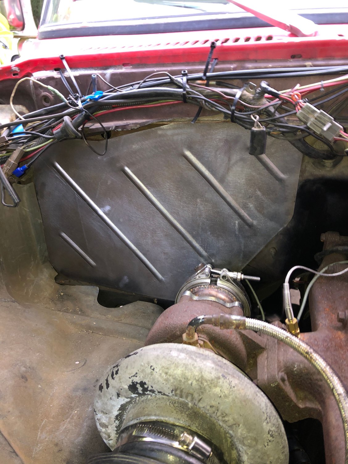

Ac delete plate
Installing it low so there’s plenty of room for the 5 hoses and my glove box above it.

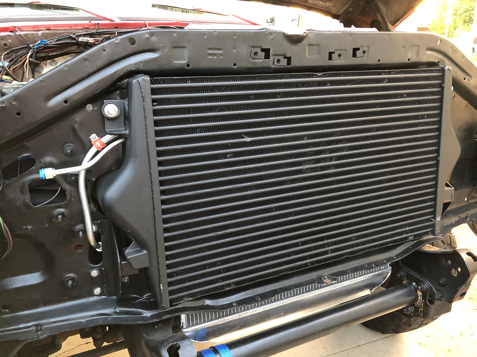

Photos of modding the brackets to mount the condenser between the radiator and ic.
