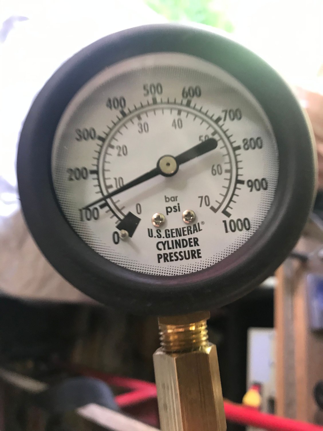

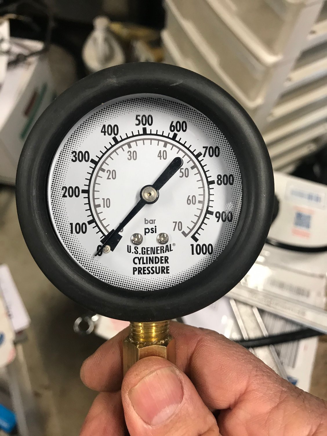

My aha moment was correct - the line doesn’t hold pressure.
pictures show the gauge pressurized, after I release the air hose, and the inside of the pressure relief fitting.
