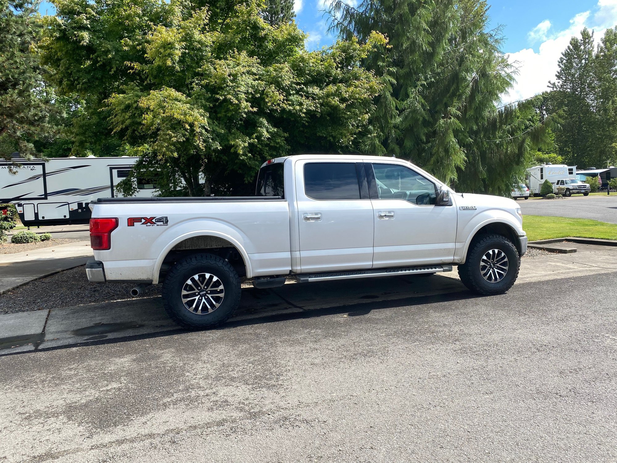

Ended up doing the ready lift 2.25 level and a 3" rear block. Looks good and still has some rake. Picked some new Raptor wheels with less than 1000 miles including TPMS sensors.

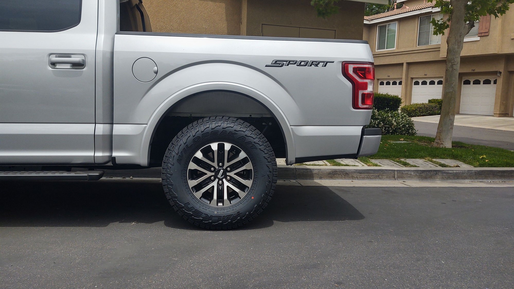

One thing I've done to my truck after getting Raptor rims (but 285/70/17 tires) to reduce the raked look before getting a level, is add rear wheel liners. Here's a before and after. Not seeing that silver part of the bed through the wheel well makes it look lower. Nothing else changed.
Before wheel liners
Before wheel liners.
After rear wheel liners

Looks nice. Any of the lighter-color trucks look better with wheel well liners. Silver, white, blue jeans. Black might be OK without.

They all need the liners. Can’t believe you have to option them.

Got my Husky's from Amazon. Under $100. Definitely worth it.
