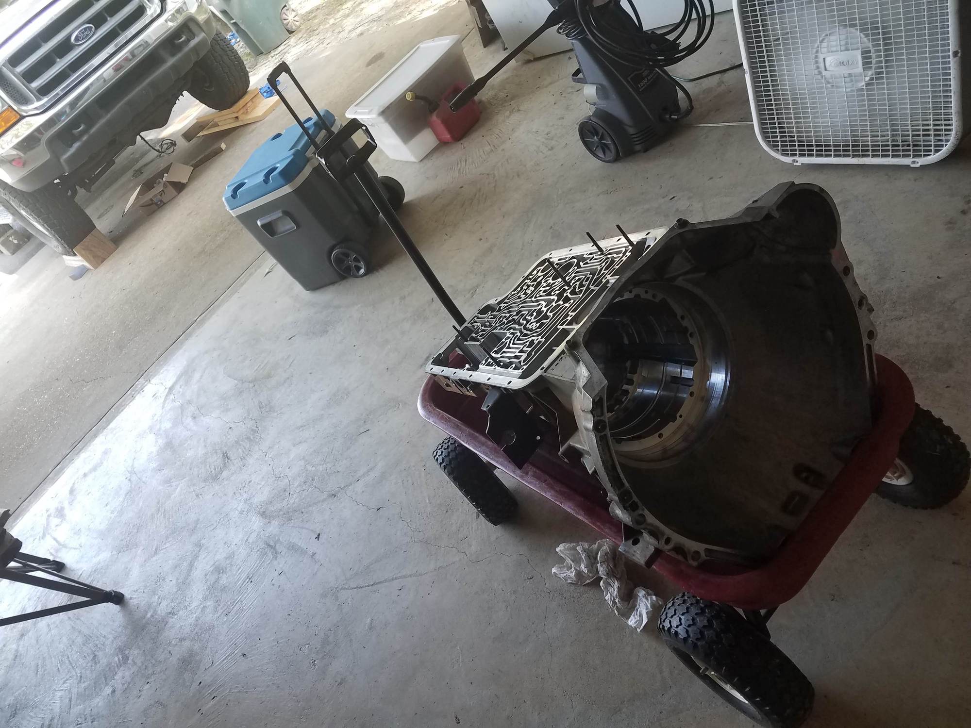

There is a snap ring on the forward clutch assembly that was prong to failure and is really the only weak point INSIDE the 4R100. If that snaps out of place,,,,,, nogoforward. I am no mechanic, but completely rebuilt my tranny last summer because the front seal started leaking. I used the kit from Transmissionbench.com. and also the Transgo shift kit. This kit comes with step by step classroom type instructions by Jimmy Williams on UBS drive. I called him direct with questions 3 times during rebuild and he answered twice and called me back the third. Heck of a guy. Since I saved money doing it myself I put the extra into a ATS triple clutch torque convertor. If you decide to rebuild it yourself, ORGANIZATION is the key factor.

Originally Posted by ajbrown208
Awesome. Love the use of the Radio Flyer.

@FordTruckNoob Yes sir. Those wagons are not just for LITTLE KIDS anymore.
