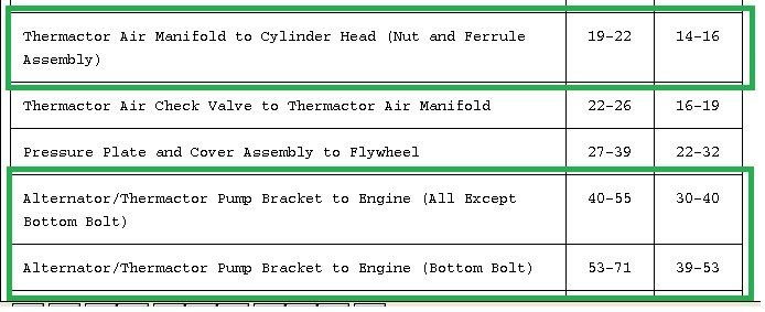

Cut from my Ford Service CD:
Far right column is Ft. Lbs. Center column is N-m

My Haynes manual says 30-45 ft lbs. And it says that torque is for the power steering support and mounting brackets. I'm not sure this is what you need and if it is correct for the bracket you are talking about. This is all the info I have. You might try those torques and see what you think. Here is another way you might determine your torque.
Sandy
