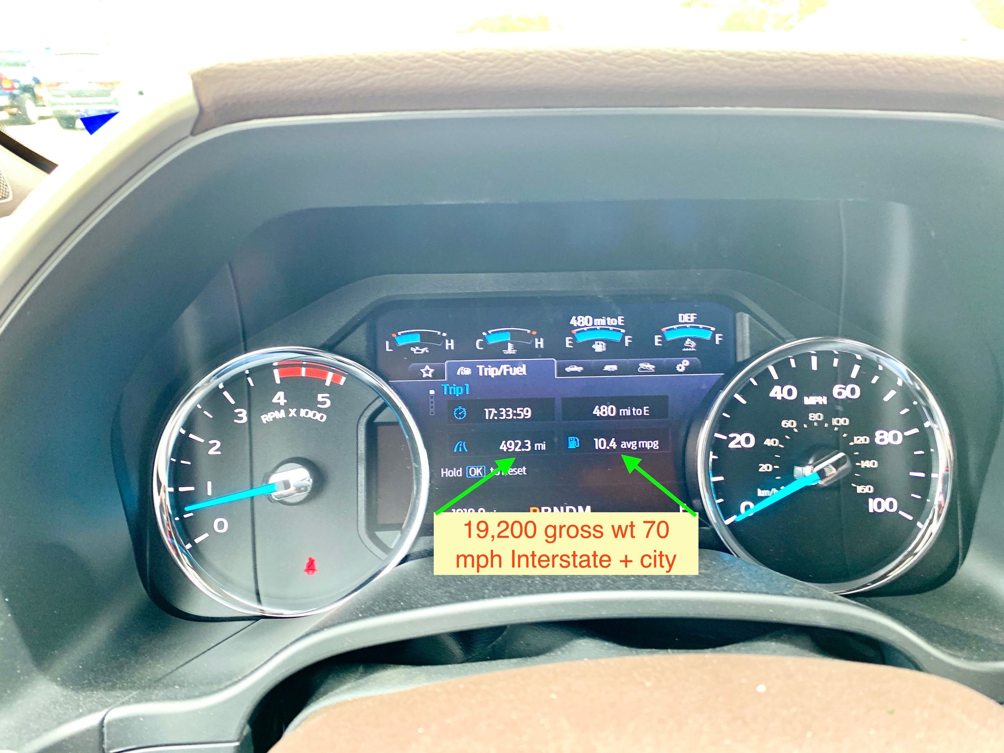

Hauling heavy at 19,200 total, 15,500 truck + 3800 tow
Tow-Haul
Lifetime includes 493 of Tow Haul, drive 75-80 (legal speed) unloaded, 70 loaded. Wt unloaded 9460 lb, me (200) _+ 46 gal diesel
