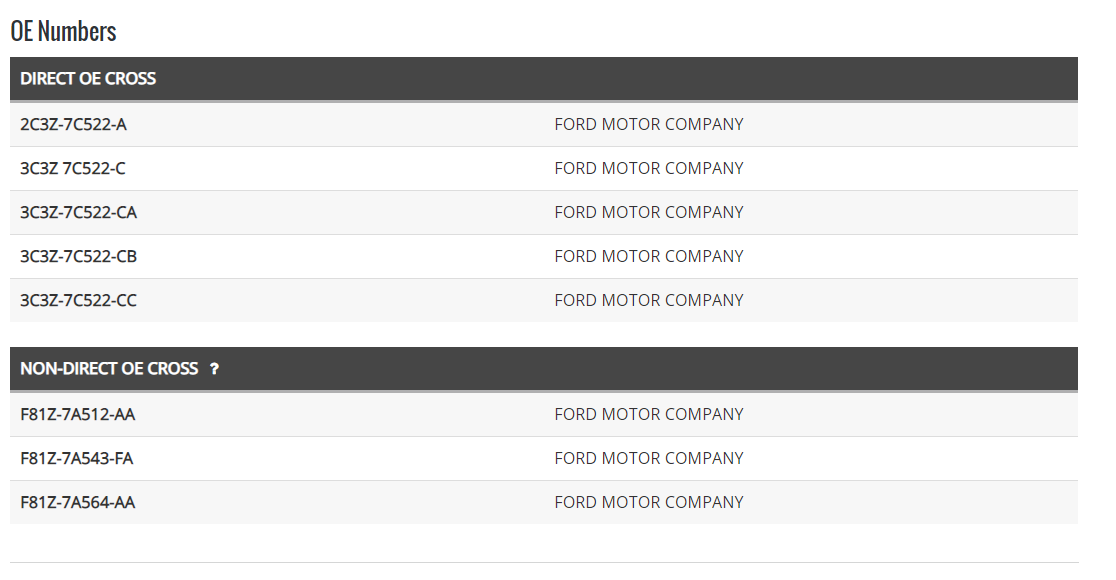

I was looking for a Motorcraft part number for the master/slave hydraulic kit, but I have not found anything definitive as of yet. So far I have the following. Although, cross-referencing some of the numbers at Tasca, they are not listed as viable replacements. If anyone can confirm one of the below numbers or a different number as being the correct Motorcraft part number, that would be a good addition to this thread. I will keep looking when time permits.

The all aluminum ones are junk. I’ve seen these fail in as little as a couple days (the rod pulls out of master).
My OEM hydraulics lasted over 400k miles. The good stuff doesn’t cost much more and doesn’t need a ‘lifetime warranty’.
Going off personal experience, I'll run with the aluminum...only issue was having to add some fluid after 100k+ of usage. Got a new spare on hand, just in case. Previous replacement if one was a misdiagnose. After removing trans and seeing the carnage if input, t.o. bearings and the plastic block nipple broken, since all was new being installed, I thru in a new m/s assy
