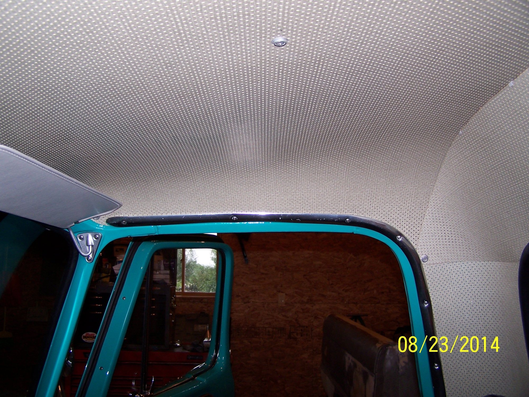

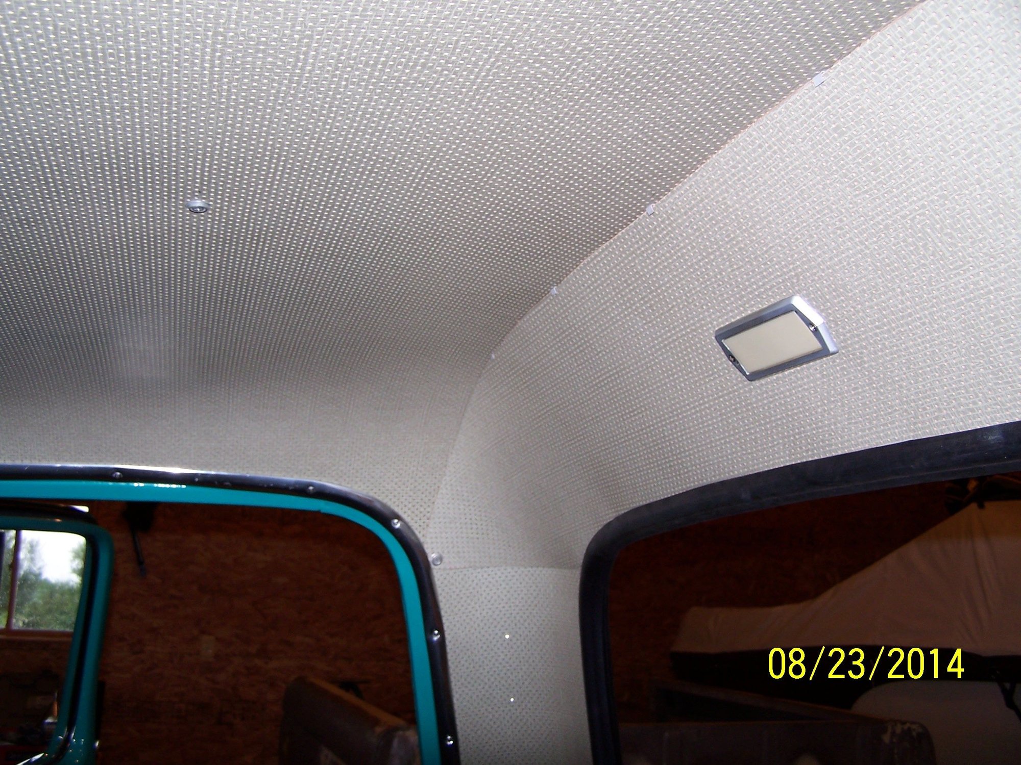

The shop doesn't know what they are talking about. The cab is the same 64 and 65 except for the floor on a 2wd. Here is a 64 Custom Cab perforated 4 piece

Originally Posted by TA455HO
The 1975 MPC does show a different part number for some of the 1964 pieces than 1965/66.
And then Dennis Carpenter shows the 2 piece as being 1961-1964, but I think that should be 1961-1963.
https://www.dennis-carpenter.com/en/...dliner-kit-2pc
I have seen an original 64 standard cab with 44K miles and it had the 2 piece perforated headliner that had never been changed. I thought 65 and 66 went to a non perforated headliner but wouldn't the size of the pieces all be the same regardless of perforated or non perforated?
Looking good, but where is your coat hook?
