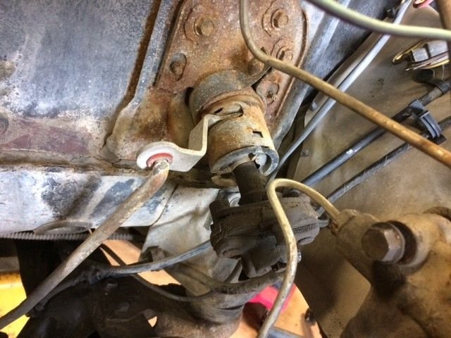

1974 explorer 2wd,I sent the steering box to Redhead for a rebuild. What else should I replace when it comes to the steering column while its accessed? and from what outfit?

I would replace the coupling on bottom of the steering shaft in picture , and clean the frame area were steering box mounts and inspect for cracks while you have the access , as some are prone to crack behind the steering box area
