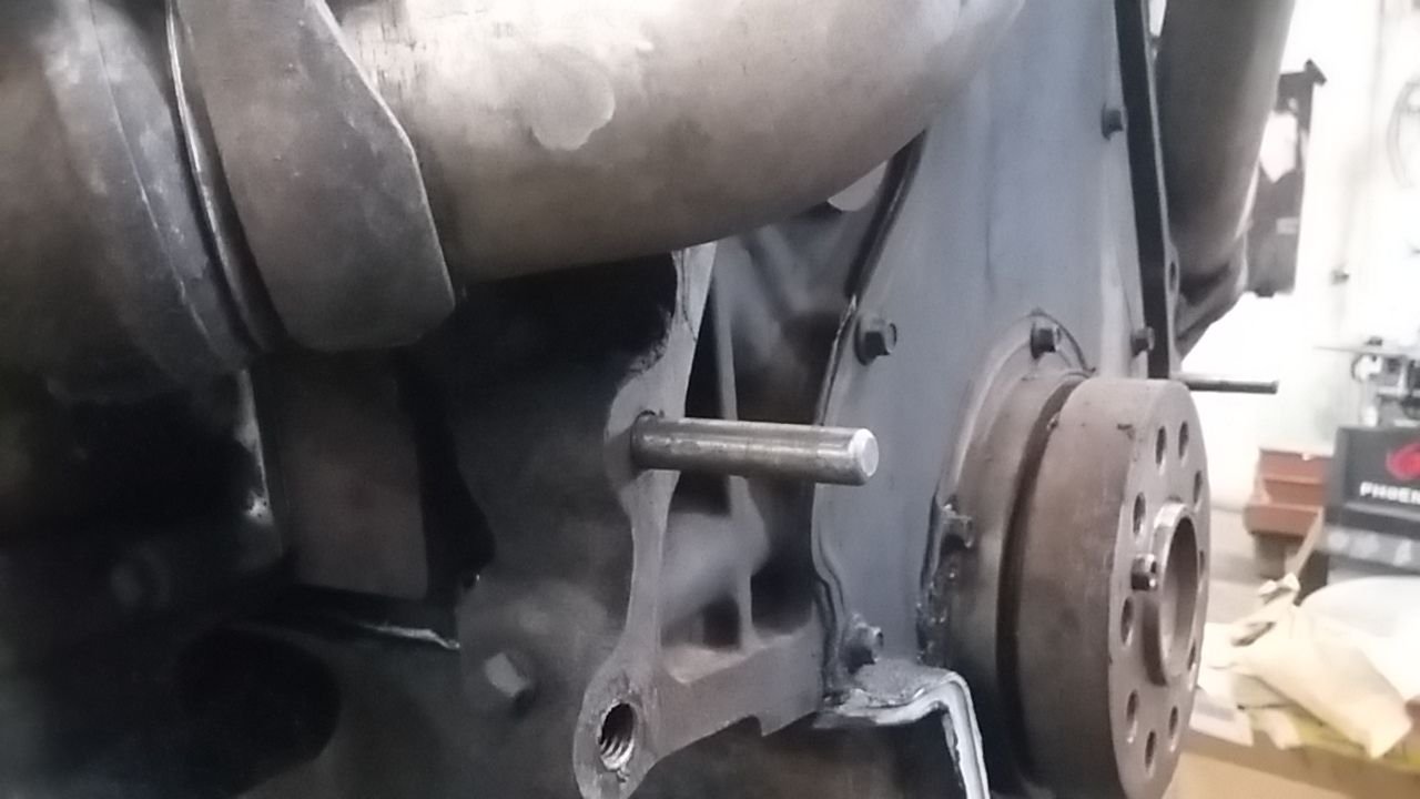

Here are a couple pictures I thought I would take this morning before stuffing this turd back into the hole.
This is a dowel pin for an automatic without the transmission spacer in place.
This is the same dowel with the spacer installed.
This is an actual (not trimmed) dowel from a manual-equipped block. As you can see, there's no way that pin will make it even halfway through the spacer.
