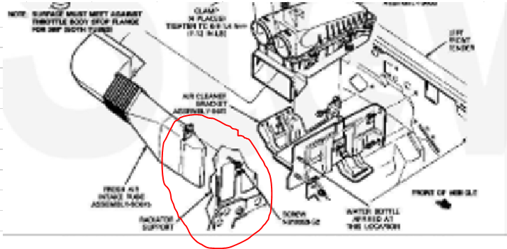

I opened up the fresh air intake by getting rid of that sad little opening near the radiator cap.Think about it, a 460 trying to suck air through a hole that small. I opened up the air filter box under the filter to get more air and better air distribution through the filter. The horns in the intake tubes were already gone.

From what I have seen that is plenty of air for the engine and it is drawing fresh cold air from the grill area. It sounds like your mod now has you using under hood air. Not better.

I forgot to mention the insulated box I made to take unrestricted fresh air and direct it to the filter box with a drain for rain water to escape.
It may not be pretty but it keeps the incoming air cool. I used a couple of plastic pails and a heat gun.
Someone replaced your I6/460 Air intake with the 5.0/5.8 intake, your 460 and the I6 comes low from the grill support(more like a Ram Air Intake), and a lot more cool air
