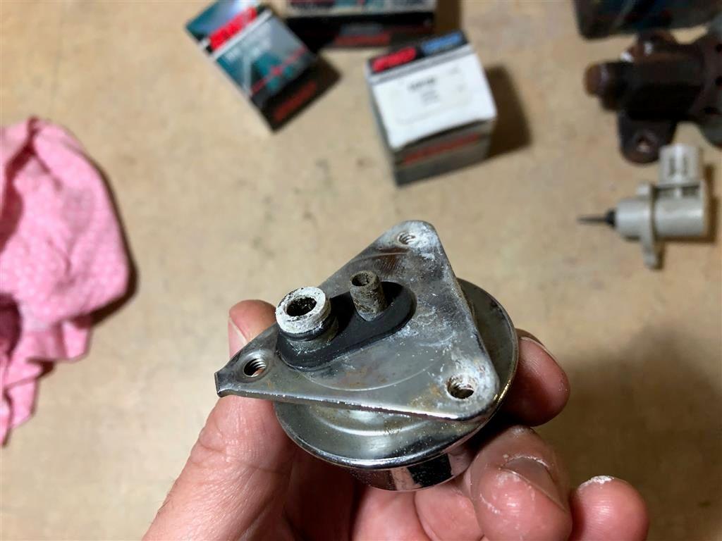

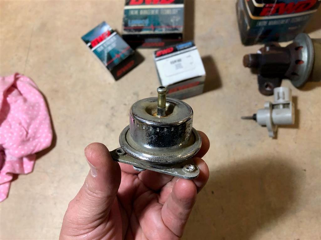

Oh, and can you guys tell me what this part is? It was in the box for the EGR sensor...
Old Apr 4, 2020 | 06:59 PM
torq'ta 5 8's Avatar
torq'ta 5 8
Joined: Jan 2019
Posts: 5,075
Likes: 864
From: N.W. Alabama
thats an old fuel pressure regulator, and as long as TPS closed voltage is above the minimum closed(0.6v) should be ok but here is good write up on it
Throttle Position Sensor Testing, Replacement and Adjustment - Ford Bronco Forum
