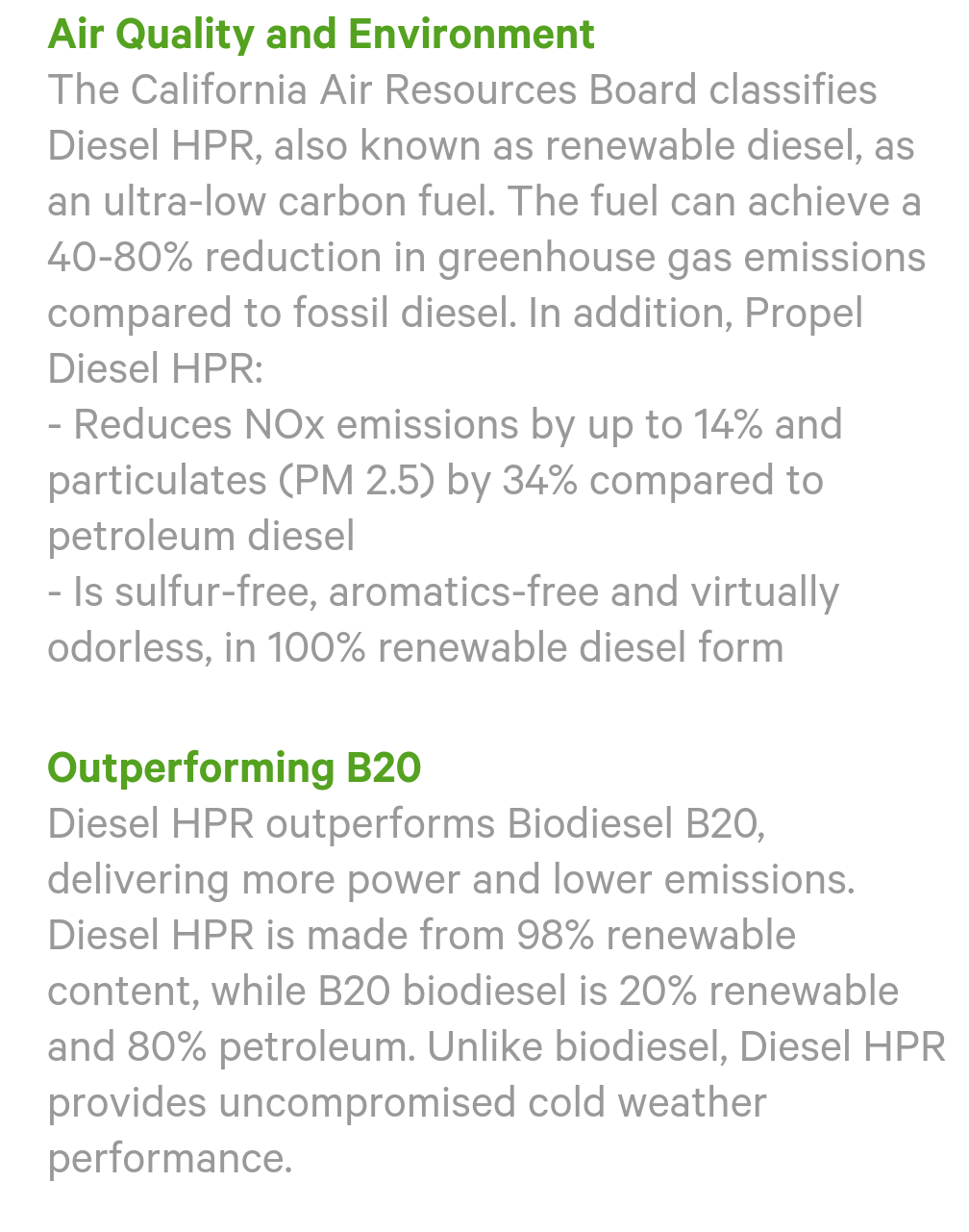

I use Bio quire a bit, mostly Propel Fuels Diesel HPR ; Clicky.
I have never noticed reduced power or fuel mileage even running B-20 from other sources and none of my oil analysis have shown more than 1% at 6K oil changes. I say run it.
They claim that Propel is better than biodiesel. Sounds like it's good stuff. I'd try it if I could get it.
That fuel sounds AWESOME.

@Overkill2 you're right Propel is a different animal than B20. I wish that I could get a tank full also but it seems to be exclusive to certain areas. @Superduty450 where do you fill up with Propel?
