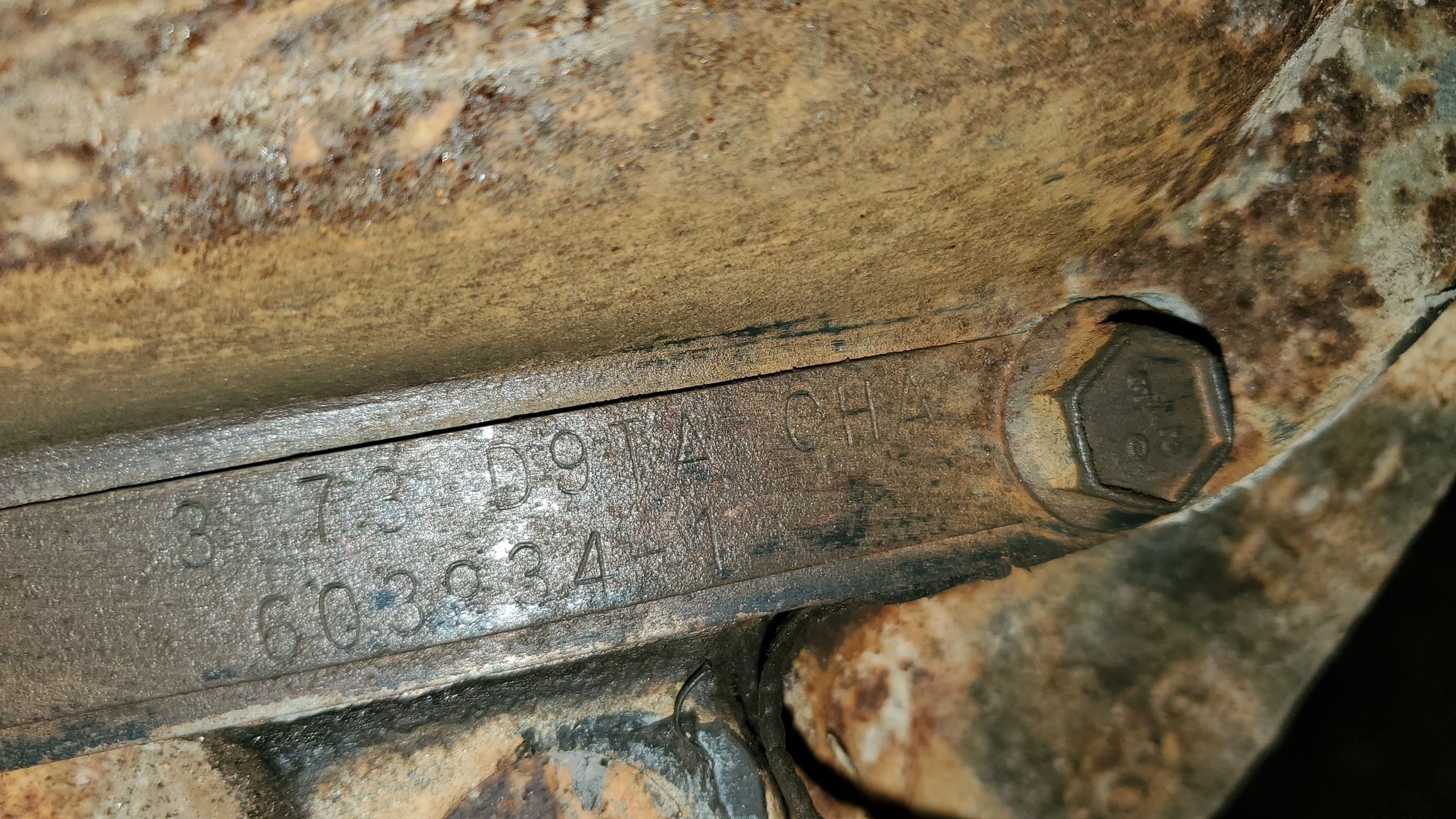

I've got a '79 E350 I'd like to steal the rear axle (full float) and springs out of to replace my 1990 E250 Camper rear axle (semi-float) and sagging springs. The door sticker appears to not have the axle info inputted, or it's faded. Below are pics of the Door tag, the rear axle and axle tag for the '79 E350. I was hoping maybe the VIN could shed some light on the axle. Any help would be appreciated.
Missing info on tag
3.73 D9TA-CHA 603934-1

REAR AXLE ID TAG: Ford: D9TA-CHA // Dana: 603934-1 = Dana 70 Rear Axle / 3.73-1 // No Limited Slip // 7,400 lbs. Rear Axle Capacity.
