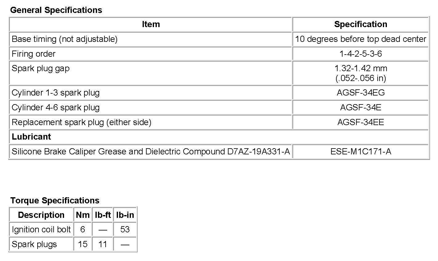

Hello Iam trying to do a tune up on my 2003 fordf150 4.2L 6cyl I wanted to know the firing order if Iam standing in front of the truck. Also the order for the ignition coil pack, does this truck have individual coils as well thanks...

Like this?

Ok thanks for that now if Iam standing in front of my truck firing order on the passenger side of engine will be 123 in a straight line then on the driver side will be 456 six and three will be last close to the windshield?

THE ..FIRE OREDER … >> IS NOT << THE CYLINDER NUMBERING ORDER.
Look at the chart provided to see the >>>FIRE ORDER.
If you don't, you will get into a mess.

Taylor , you have the right CYLINDER DESIGNATION ... 1-2-3 on the passenger side, 1 by radiator, 3 by the fire wall.......... then 4-5-6 on the drivers side.... Now you need to look at the FIRING order..... 1 4 2 5 3 6
