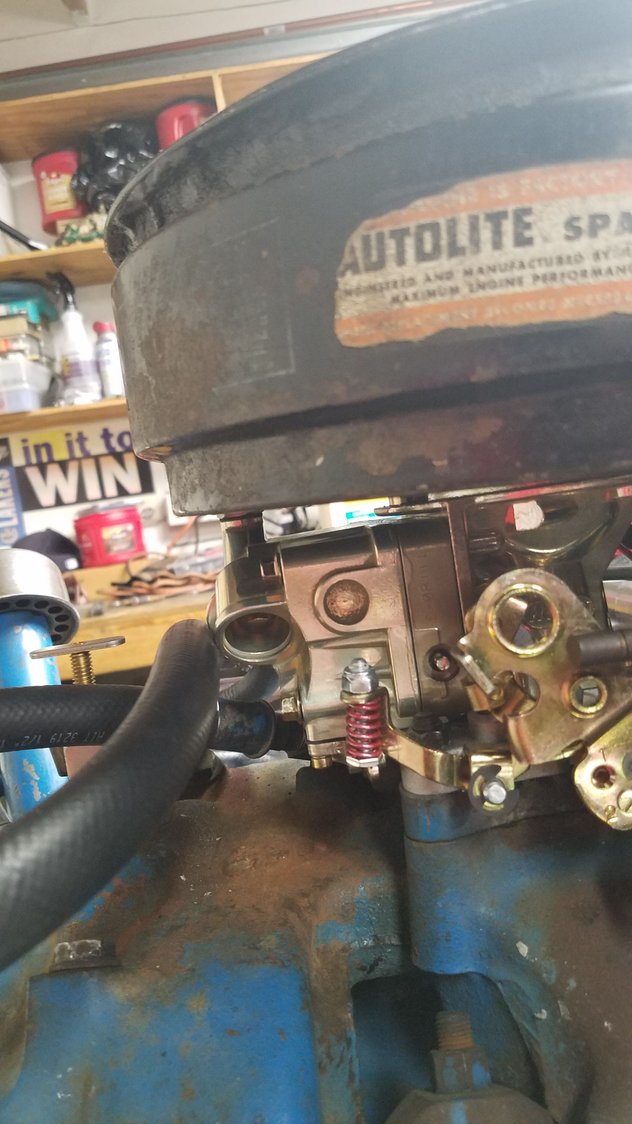

I have the oil bath filter but it doesn't sit all the way down it hits the carb
Old Aug 23, 2020 | 03:26 PM
lakechief's Avatar
lakechief
Joined: May 2014
Posts: 34
That's why I was asking

That's interesting, I used a Holley 500 CFM circle track carb and the oil bath fits fine. I "assumed" it would fit on any other Holley as well. Hm.
Most auto parts stores sell those chrome bling air cleaners w/ a filter for not too much money.

yeah I need to get one thats's 8 inches in diameter.
thanks anyway appreciate it
