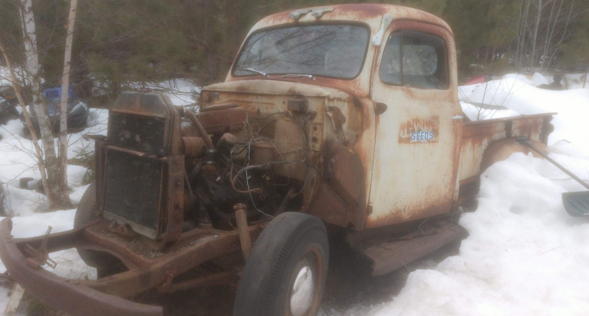

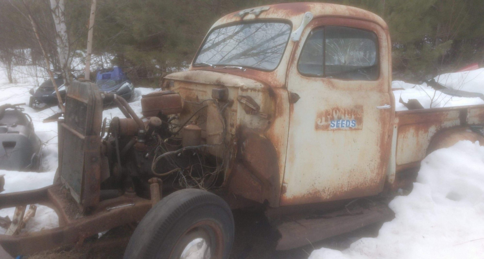

Thank you guys for all the feedback. Here are a few photos of the way it sits now. I can get better photos later this week, due to snow meltage. A little quick update: All four wheels are also locked up.

Is it your intent to keep the truck as original as possible... (flathead V8, original brakes, etc.?)
If not, getting a 90's or 2000's era drivetrain / frame is not expensive but does take quite a bit of fabrication and time.
I have a great deal of respect for those who take them back to factory original... but there are pros and cons to both.
As mentioned already: finding and aquiring a Marmon-Herrington 4x4 drivetrain, might be one of your greatest hurdles if you decide to go that way.
I'd recommend plenty of research and then make the right decision that best fits your desire. There are plenty of great people on the FTE site that have gone through everything you'll have to tackle no matter which way you go.
NOTE: I see the remains of what looks like sun visor mounts on your rain gutters and center of your roof right above the windshield... The center bracket could be worth a couple hundred bucks to the right person... I'd suggest not trashing that...

One of the biggest problems with frame swaps is the narrow width of the older trucks compared to anything newer and the rear frame kick up on newer . I the case of building a 4x4 it's far less crucial and the larger fender opening will work in your favor also .That being said there will be no bolt on options and many challenges . If I were attempting this I would first find a donor with the right wheelbase to eliminate any major frame work and then start measuring every thing you can get to and then remeasure everything again . Most importantly you need to decide what you are going to use this truck for ; weekend town trips , lifted , large tires , daily driver , parades only , serious off roading ? This to me has a great bearing on what donor vehicles should qualify . Good luck and keep us updated . Did we mention we like pics ?
