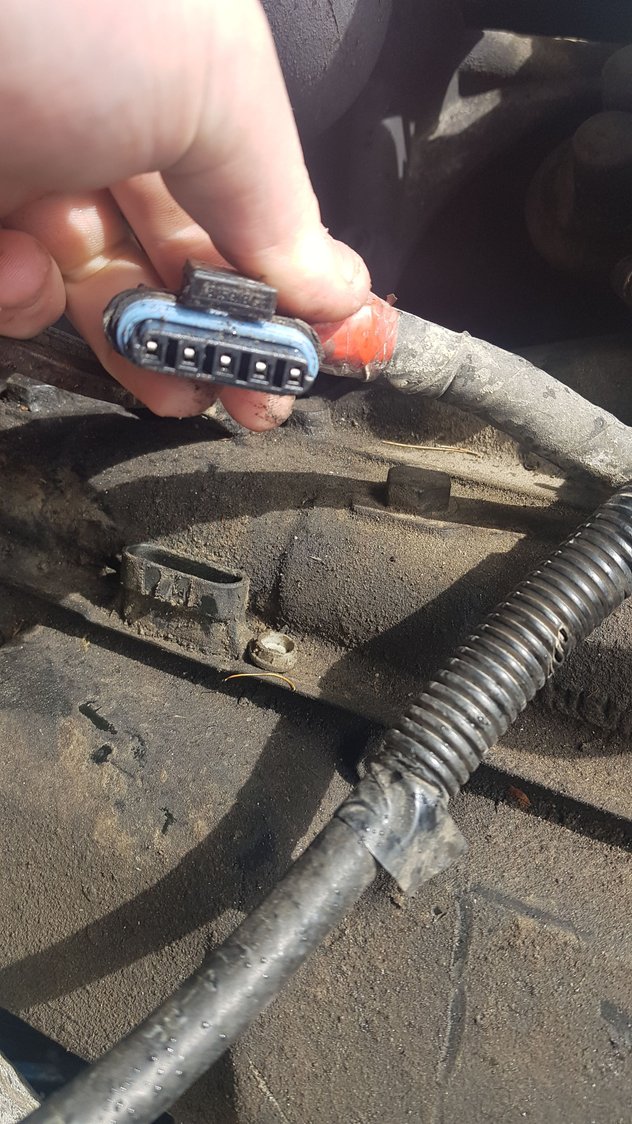

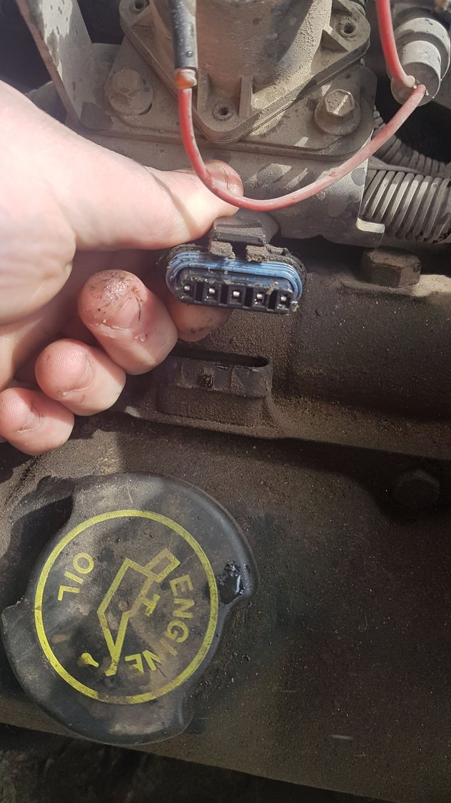

Ok guys I checked the UVCH and they all look awesome! Did a cold start (7°c) and it ran horrible for the first 30 seconds (sounds to me like only one bank firing?) Now I have notice a stupid amount of white smoke (it was warm) when under throttle, and the stutter still remains! Would injectors O-rings cause white smoke too? The link is a link to the video of the smoke. https://drive.google.com/file/d/1AIo...rivesddrivesdk

Yes, those 2 look good, but the ones under the valve cover may be bad. How are the ones on the drivers side look? The IDM can shut one bank down to protect itself if it senses a short in one of the harnesses.
