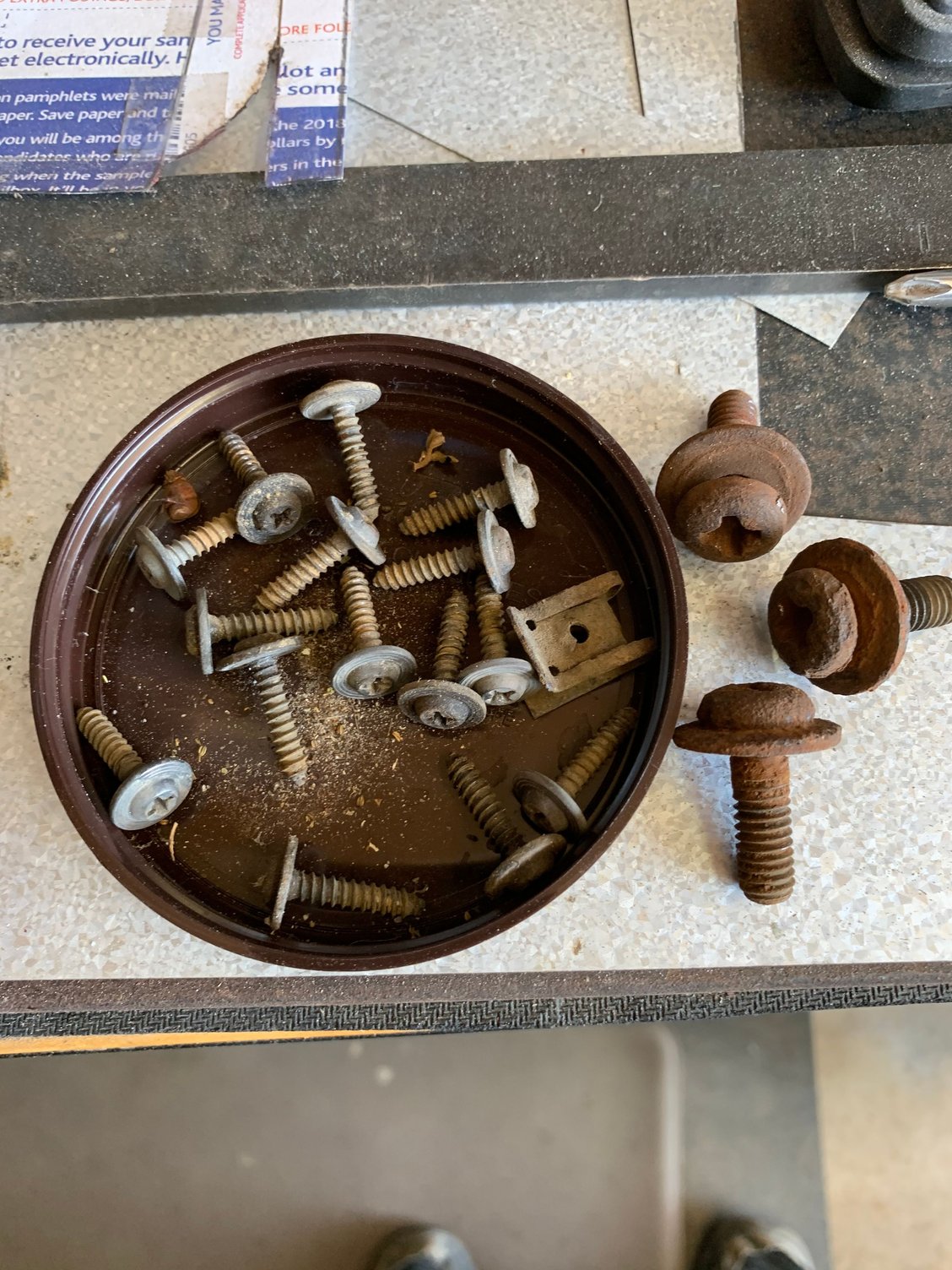

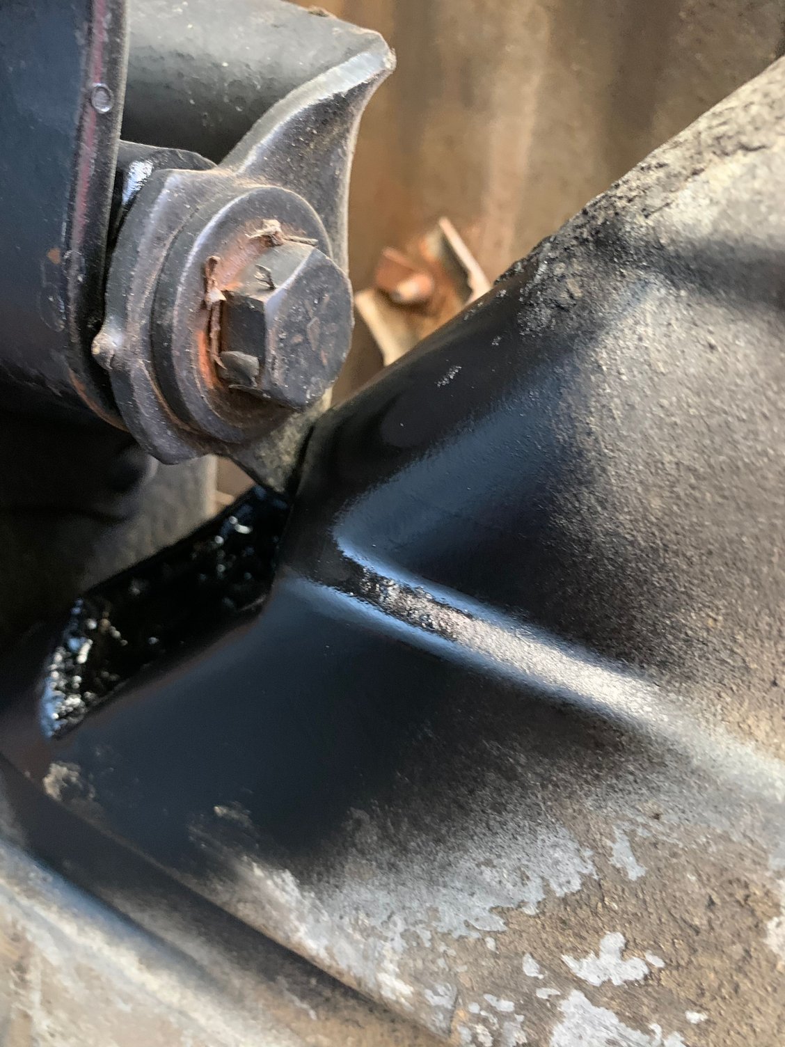

I know old thread but...... I'm doing this job right now. The bed I have has a tool box and side reflectors (just the holes) the reflectors (or lights) aren't there. I'm guessing it's 1968 plus. It's now on my 1970 High Boy. The tool box hit the spring hanger and I had to make a cut out for it. So for me it didn't quite fit but everything else fit. I have a question. What do the bolts or screws look like that hold the box to the quarter panel? Stupid me lost track of them. Looks like they are small sheet metal screws with huge heads. Picture of yours?

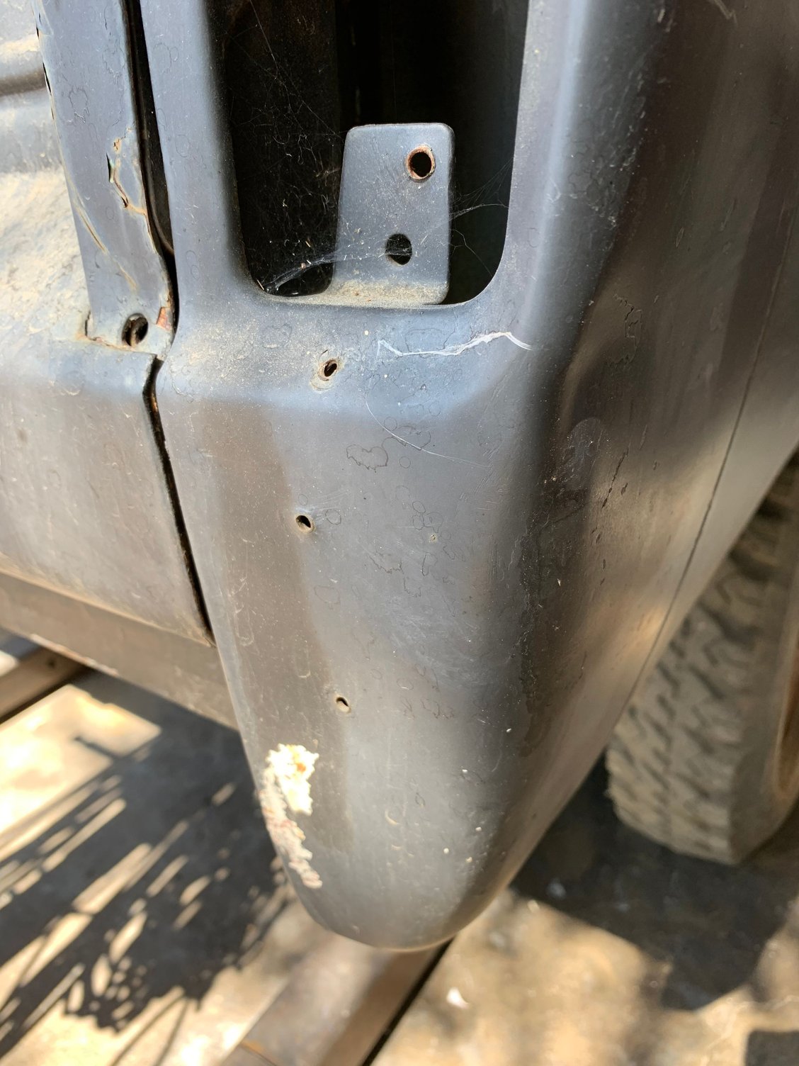

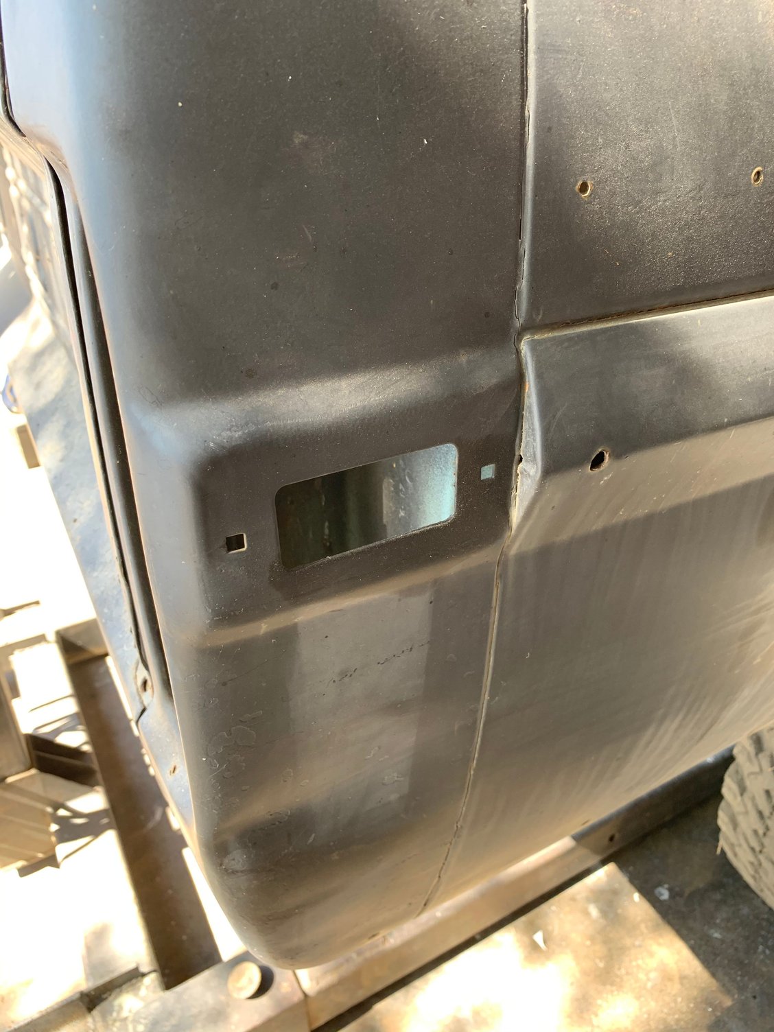

I found the screws! Yay! Here's some pictures of the screws and the cutout I made.

1968/69 F100/350 Stylesides have red marker REFLECTORS located at the lower rear section of the bed sides.
1970/72 F100/350 Stylesides have red marker LAMPS located at the end of the scallop (Bumpside) line.
Thank you sir! From what you said it seems my bed must be a 1970/72 Styleside.
This must be for a light.
The holes below the tail light hole must be for a reflector.

R/L Red reflectors below the Styleside tail lamps: 1969/72.
