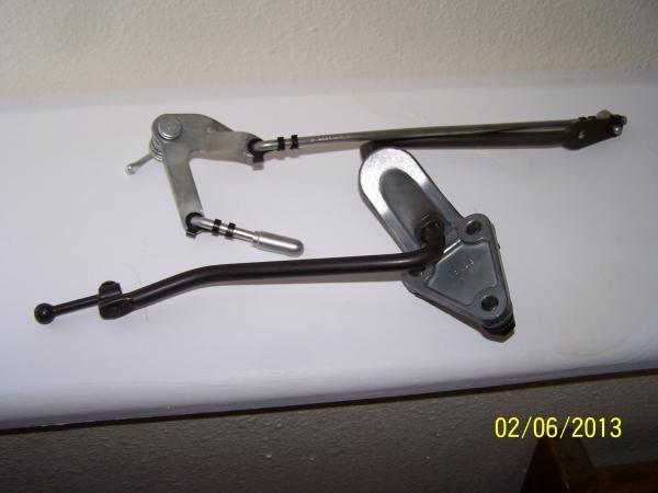

If it is what I think it is, isn't it pot metal? I restored one from a pickup, along with the whole linkage. That one was pot metal.

https://www.fordbarn.com/forum/pictu...ictureid=18887. Like this?

I had to cut the rod, clean and chromate the bracket, clean the rod, weld it together, then plate and blacken it. It went on ebay , made it worth my while. There were 3 in the junkyard, this wasn't broken.

Originally Posted by 1952henry
Click on the link, all you see is a black screen.

Yes, it is made out of pot metal. Looks like the one that BJ Maberry posted

Sorry guys my post was because NumberDummy couldn’t see the attachment 1952Henry posted! Good Luck!
