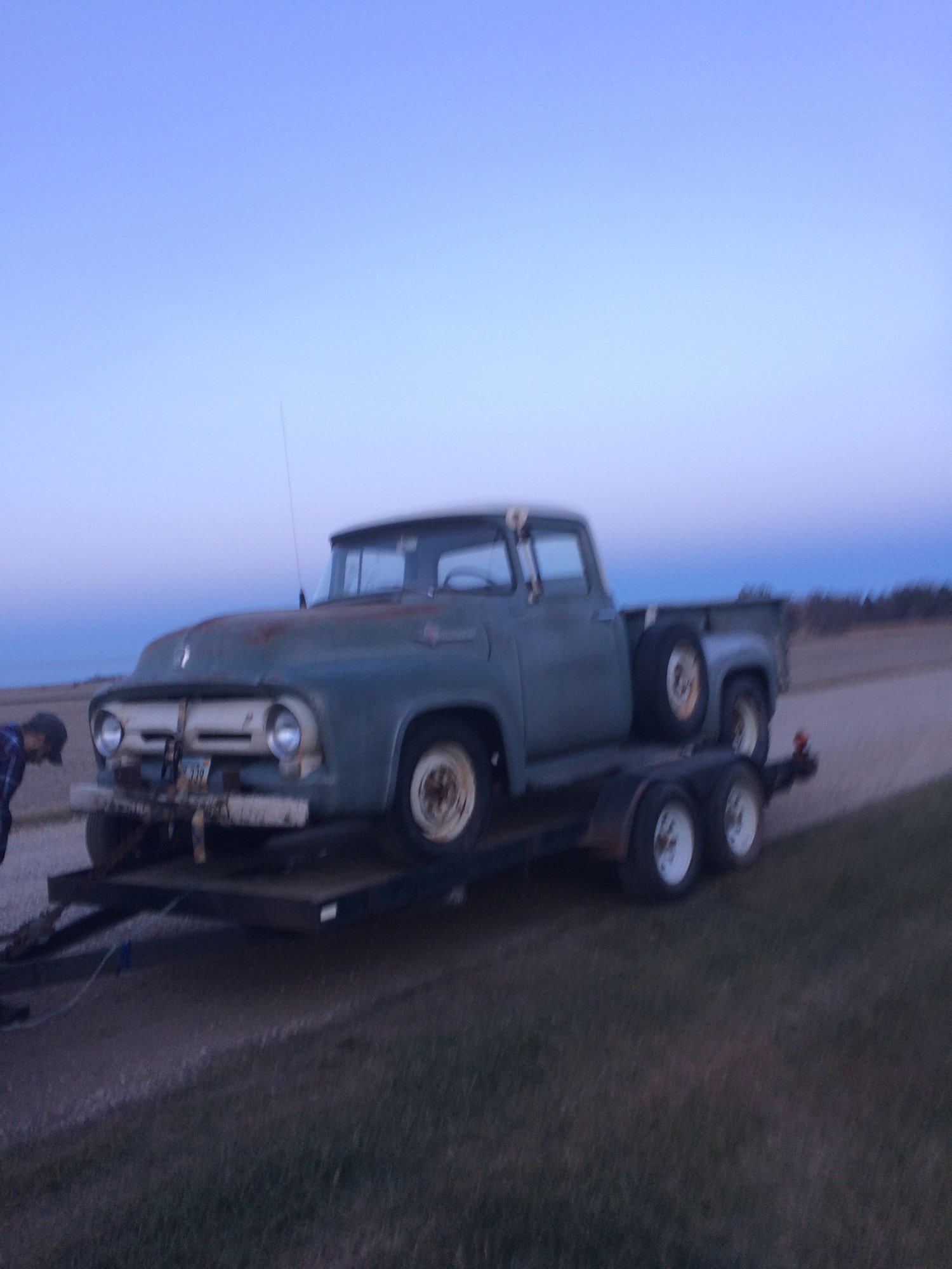

Dude, have you shown is pictures of your Meadow Green 56?

Thanks a bunch, that's a sharp truck! Now I'm debating whether I should go with a black bumper. The cab top is also painted white as well as the
outside of the tailgate.

He two tone option was started in 1955. That was Colonial White in 56. FYI, in 56 the running boards were body color and the wheels were painted Colonial White on F100's.
