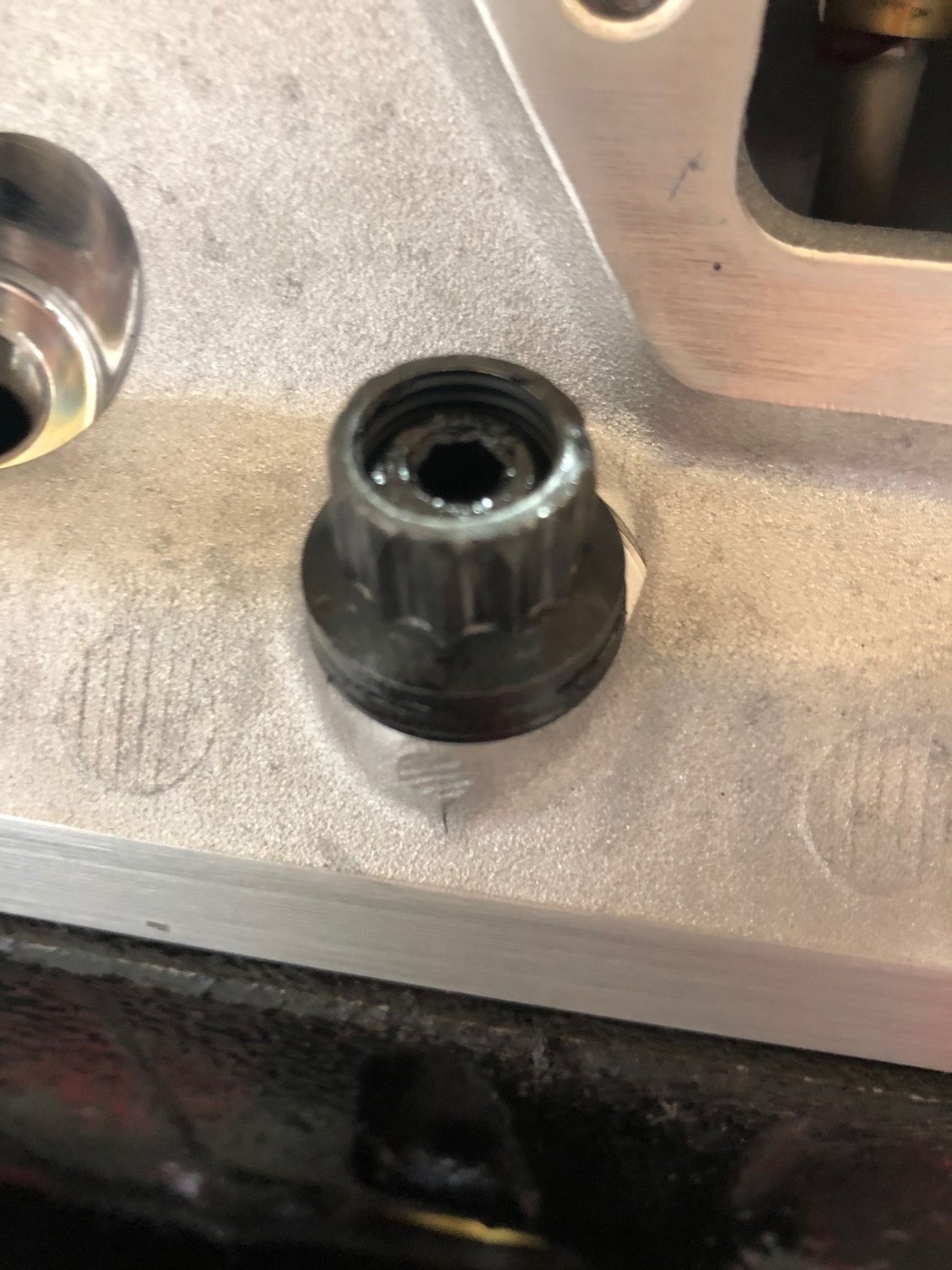

Checking Valve Clearance 5.8 HiPo into a 59 F100
I bought the valve checker, but the rockers weren't removing the marker from the tips of the valves. It looks like the hydraulic rollers give 2 much for a good solid read. The stock length removed marker just north of the center line 1-2 times. I used comp cam check springs, because I was told it would prevent squashing the roller. I've read that some guys use washers to prevent the rollers crushing/losing oil. Any body have a link/youtube video or similar you could point me towards for reference? I read that some people buy a solid tappet. Do we know how much squish is taking place? Is there a measurement I could add to the checker for proper valve train geometry?
Ex.... Do we know how much the hydraulic rollers sink in without oil? I can put together a math formula, which would get me close to length.
These head studs were torqued in the correct sequence, but I expected the stud to be more exposed. I think I received the wrong stud kit here. These are probably for a 302. Another 1/2" would be perfect.

I would NOT run those head studs as-is. The ARP head studs in my 351w's stick up past the nut at least 1/4". I don't know if the issue there is the studs being short, or the head you're using being thicker than "standard" on the deck.
302s use 7/16" head bolts, 351w's use 1/2" by the way.
When I measure for pushrods, unless I know before hand that the cam uses a small base circle, I just stick a stock length rod in with the springs that I will be using, put dry-erase marker on the valve tip and roll it over. If that comes up being far off, then I stick an adjustable checker in with a soft spring.
As far as the hydraulic tappet wanting to compress, you've got few options. I have a couple old roller tappets that I have welded solid for checking length. Works great. Alternatively, you could disassemble a roller tappet and stack it full of dimes (or pennys if they fit) and reassemble for a mock up unit that won't compress. I think Thunderhead289 on youtube has a video of disassembling lifters, can't remember if he was rebuilding them or making solid checkers, but that should help.
