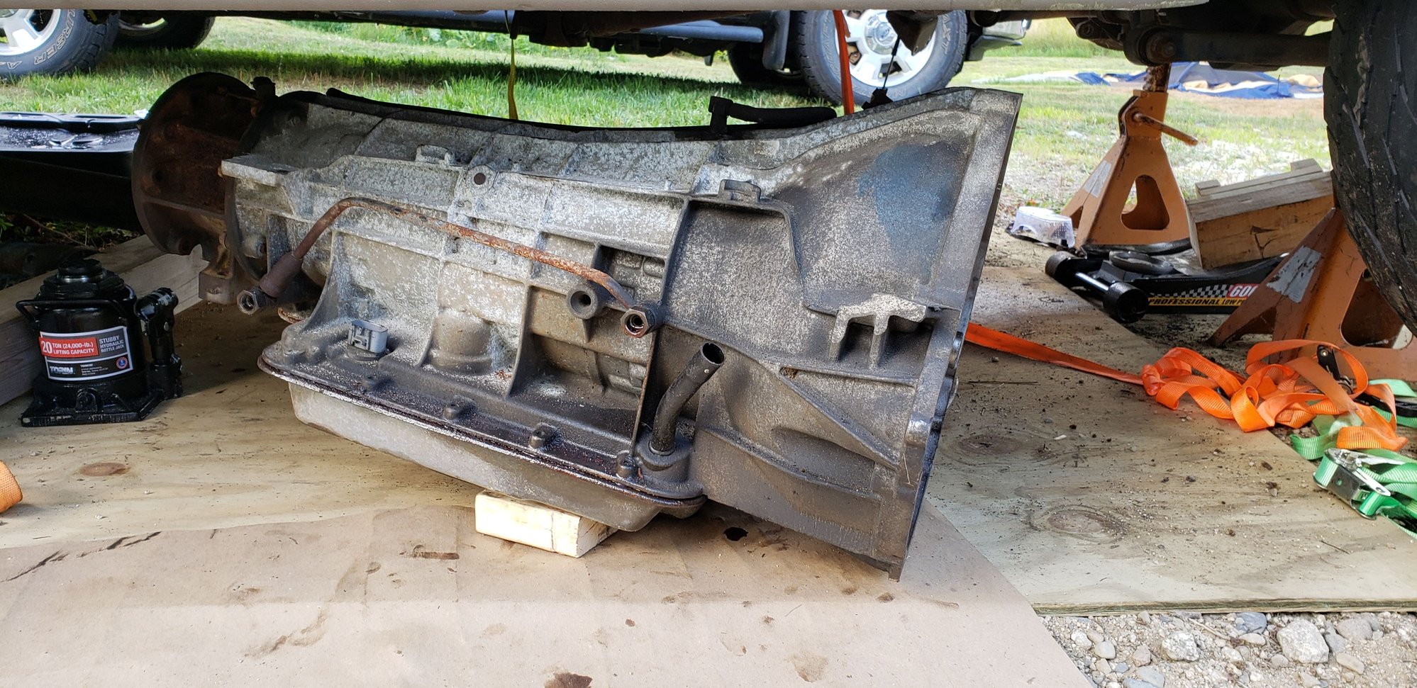

Transfer case fixture
It's a start...
Temporary resting place
Finally getting some real work done.

And she's out.
This might be a stupid question, but aren't stock converters painted? The C4 and C6 trans that I've worked on before, the TC was painted blue.
At any rate, its out. Still have a tool to build for pump removal, so I won't be starting teardown until tomorrow or Thursday.
Progress is progress...

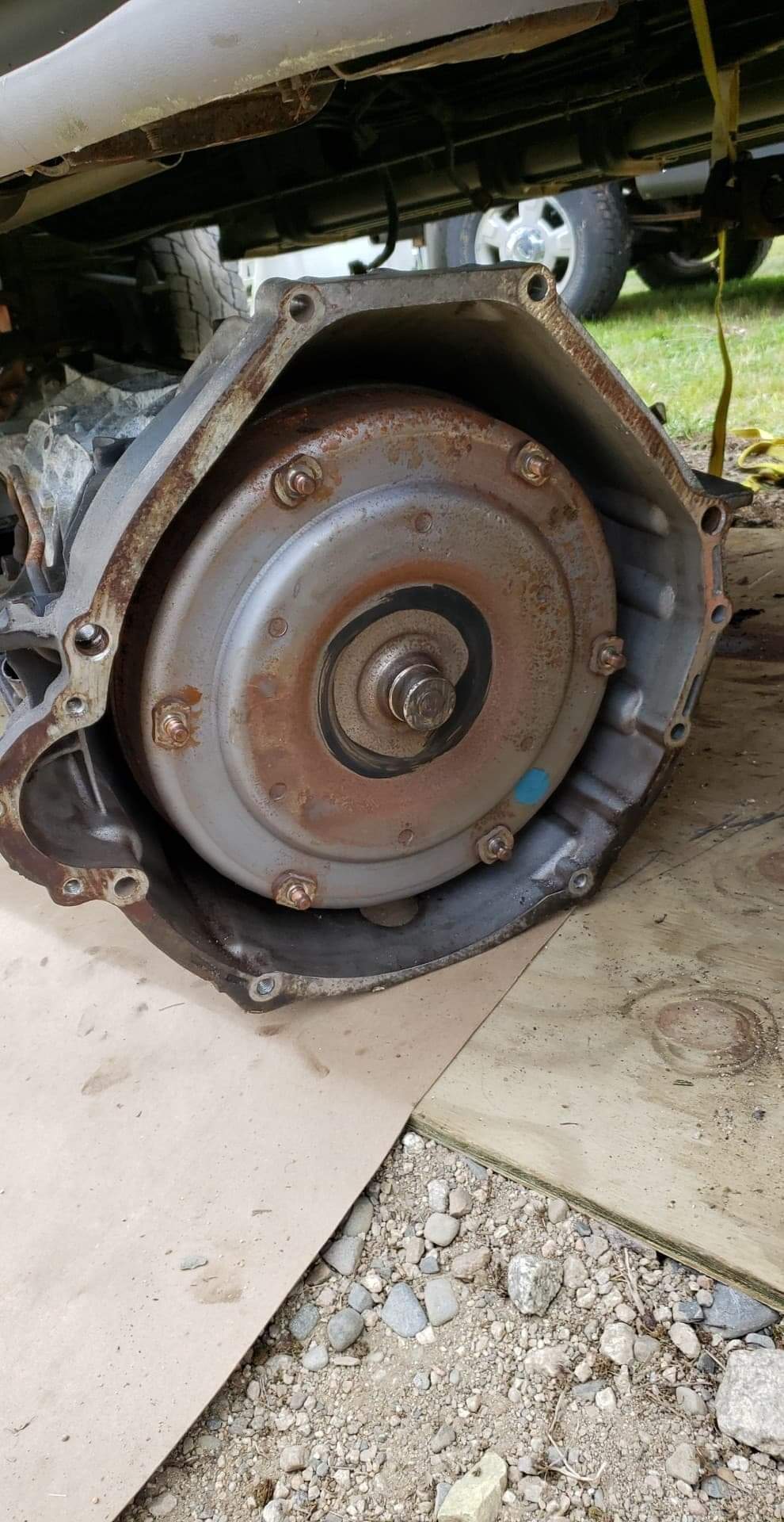

No leakage...
Well I got the trans moved into the garage, and the TC out.
Anyone have any info on when Ford changed to the new seals? I don't see any evidence of a leak in the bellhousing. With 220k miles I would've thought there would be something...
