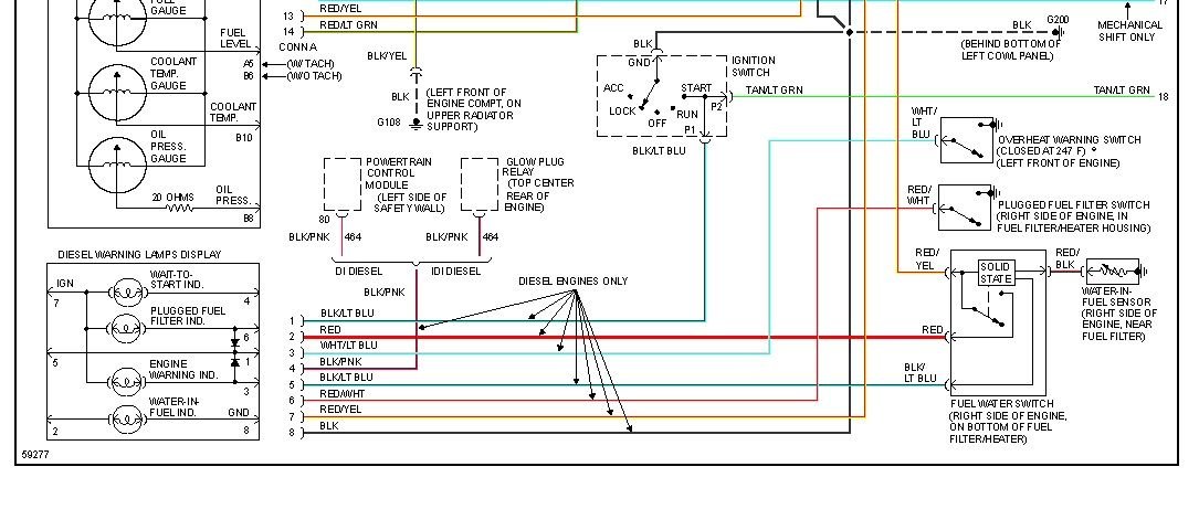

Lonewolf, what is the proper way to test the WIF module? I took the 90 degree connector off the WIF sensor and put it to a ground, which illuminated the Water in Fuel light in the dash. Providing the sensor in the filter base is good, that means everything checks out, right? Pardon the hijack BigRed

No problem at all. The right angle boot has been cut or ripped off of the wire for me by a previous owner so that's how I tested the circuit the other day to confirm it was functional.
I used a jumper and grounded the sensor wire which caused the WIF light to illuminate

jumpering the sensor wire to ground is as good a way as any to test it.
here is schematic....
The Red/yellow wire eventually ends up at fuse 17 .... as you can see the WIF module is just an SSR, Diesel is generally non-conductive and so is pure water but Water in fuel has many Impurities making it conductive enough to trigger the Solid State Relay and turn the light on .... probably a better way to test is using a variable resistor to ground .....Unfortunately I do not know what the Resistance Specs should be to cause the SSR to trigger..... it would be an easy enough experiment to figure this out Providing the WIF module you test is within Spec... IF that makes any sense
EDIT: also NOTE: when pin 1 on the display module is taken to Ground by the IGNition switch in the start position Those Lamps should light up this is the Lamp Test Mode.
