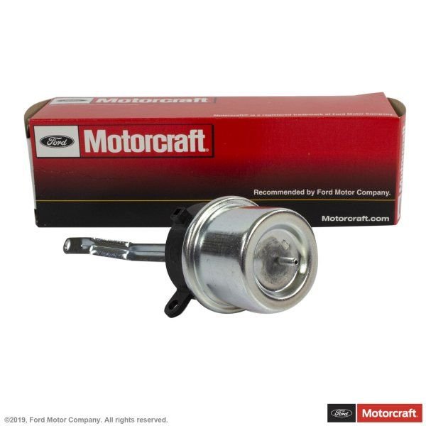

On dual climate control optioned Expies the top actuator is the passenger control and the bottom is the drivers side. Do you hear just one "flap" on start up ? That's normal. If you hear several then there might be another issue. Can you better isolate where the "flap" is coming from ? There's a floor vent actuator and a recirculate door that's vacuum operated, which would better coincide with the vacuum available on startup. Your Temp control Actuators are electric and will operate with the key in the RUN position. If you're not getting any clicking when you run the temps up and down the scale then those actuators are OK.
Floor Vent Door Actuator .....
Recirculate Door Actuator .....

Yes the noise happens at startup. I will have to check the vent actuator. Do you know where its located ?
