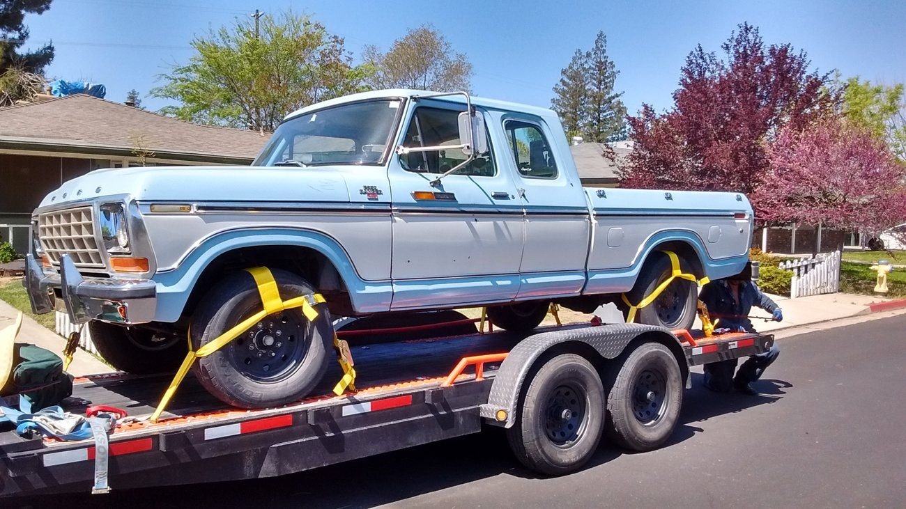

Anybody know why one set of west coast mirrors mounts right below the window and the other set mounts farther down? Is one set a bumpside set? The bracket that mounts farther down on the door is also wider (the horizontal pieces are "longer", making the mirror stick out wider)
First picture shows the two brackets on my truck. Next two pictures are from two different trucks that show the different mounting.

Well the blue truck has them mounted lower than the brown truck.
The blue truck set is actually the set I have in my picture that shows it mounting lower (and is wider). I have another set of west coast mirrors that fit the same way as the blue truck set. So either I keep getting unlucky and buying bumpside sets or im doing something wrong lol.
Also my original set was missing the 3rd arm and when I threw a spare on, it mounts pretty high (coompared to the blue truck and brown truck).

Thats what I am thinking, the set that is pictured on the blue crew cab came from a bumpside and was just mounted on the dentside.
I was hoping someone could definitively tell me the bracket I am holding on my truck and the bracket on the blue crewcab pictured, is from a bumpside.
For now I will just have to continue on with the assumption that that is true lol. Thanks for the pic!
