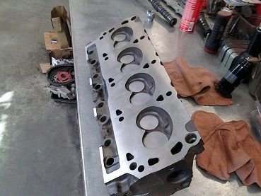

Hi, these heads are from a 87 5.0, any idea what cc they are stock? They have a "S" casting on the other side.

Those are actually '86 E6SE heads, that casting number should be on the bottom of one of the intake runners. They were a 1 year experiment and ended up being the worst SBF head ever produced. Chambers are 64cc nominal, the intake valve is badly shrowded, and the exhaust port has a massive thermactor bump in it which all makes for terrible airflow.

Thought I had a 87 5.0 but looks to be a 86 with crappy heads LOL! And got my answer on the cc question...... thanks Paul, appreciate the info.

They were not a one year head. They were in production until 91. Used in the big car lines (Crown Vic, Marquis and Lincoln) Chambers were 68 cc, his look to have been milled, so could be less.

they where shaved 10 thousands when I had the 5.0 rebuilt.....interesting info and opinions on these heads, I must say the motor pulls real nice with the setup I'm currently running...... thanks for your opinions and feedback.

The exhaust on the lopo engines stock were very restrictive. The intakes were choked down and had 17 lbs injectors. They also have a dish in the piston with no valve reliefs. The 68cc chamber is deeper than other heads. And i have read stock these heads can take up too .600 lift with out hitting the piston with out valve reliefs. But since it doesn't flow well at that lift it doesnt really help.
On mine the long block is stock including the camshaft. (I do have a explorer camshaft, gt40 3 bar heads and 1.73 cobra rockers for later on). But i have the speedway tight fit headers, 2.5 inch dual exhaust (no H or X pipe), 1985 mustang (4speed) sure spark roller gear distributor, edelbrock 289 street master intake and 670cfm 2v TBI.
The intake matches very well with this combo as it's over with at 4500 rpm just like the heads are.
If I ever pull these heads and keep them they will be ported on the exhaust side before being reinstalled.
