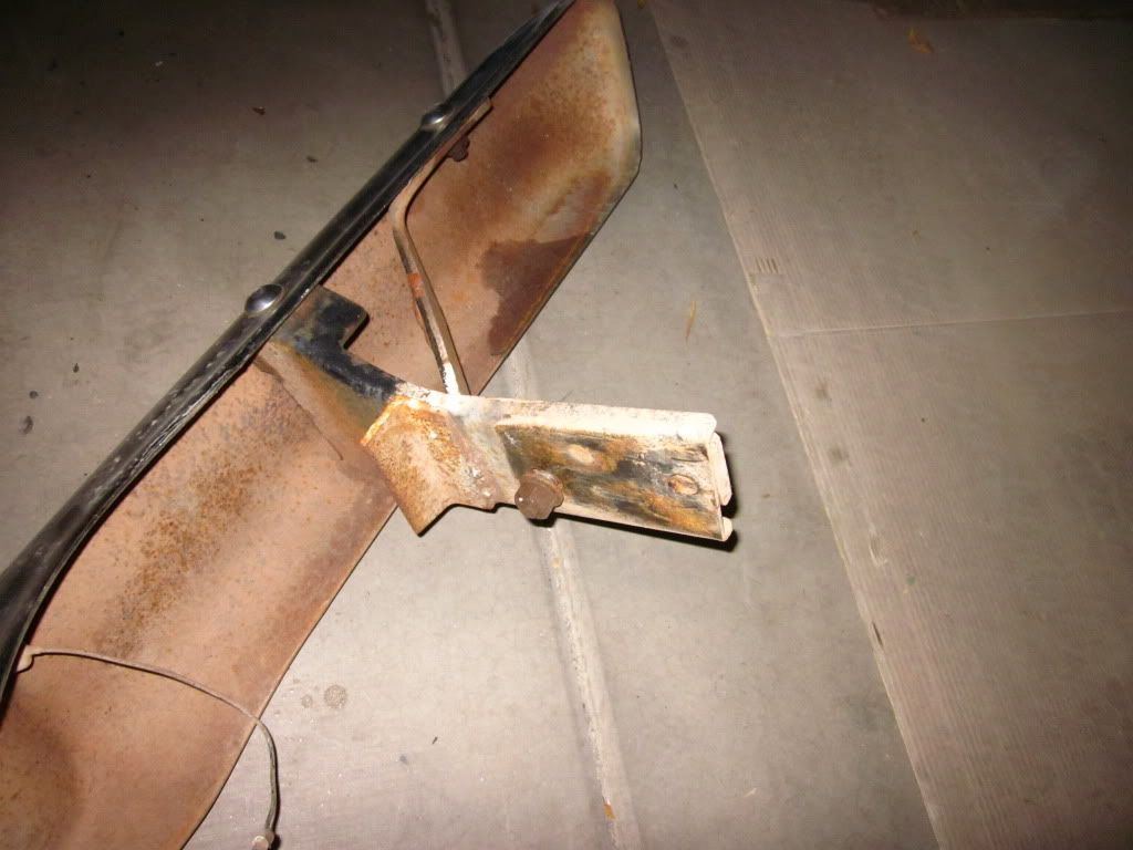

Ok. I have 1 last part to purchase. Rear bumper. Its the contoured bumper. Lmc offers 2. One says 37.5 mount holes the other says 40. Where are they measuring from. The bumper bolts on top of the bumper? Or what?
i have my old beat up bumper contoured bumper. But i still dont know where they are measureing from.

I just went and measured the frame this bumper below came off of. Outside to outside it 37 1/2.

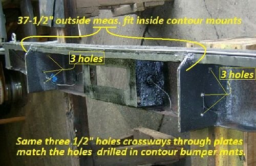

Old Apr 23, 2022 | 11:23 AM
tbear853's Avatar
tbear853
Joined: Feb 2004
Posts: 10,844
Likes: 2,613
From: The Shenandoah Valley
I believe the mounts for the contour bumper are different than the step bumper.
They are ... if using a mass produced step bumper, or Ford's, they always came with mounts AFAIK.
I made mine, i just welded two 1/4" plates in my bumper that are "out to out" 37-1/2" ... same as contour bumper mounts "in to in" so then just mount with three good 1/2" bolts each side after drilling the holes. When I put it on, I just slide it up on to the contour mounts, then crawl under and line up holes and insert bolts.
