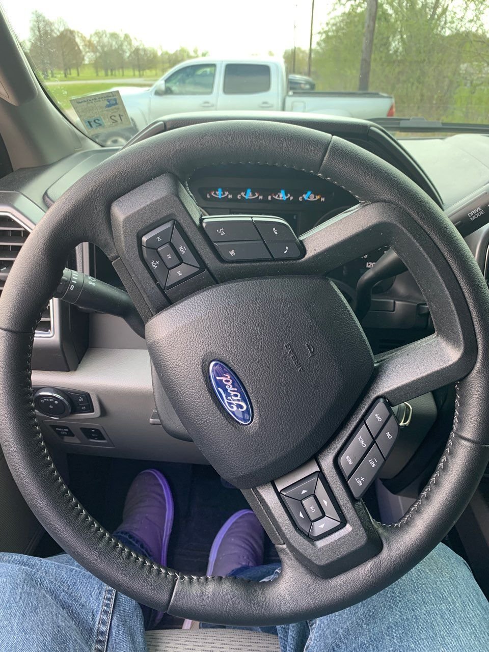

JKBrad,
I had the leveling kit put on by a custom shop near my house but brought the truck to Gateway Ford to have the truck aligned and have the pigeon toe fixed. As shown below this is how far i have to turn my steering wheel to get the tire to turn slightly. When im going around a curve if to turn my steering wheel like i am pulling into a parking lot.

Did it do that before you had it aligned?
