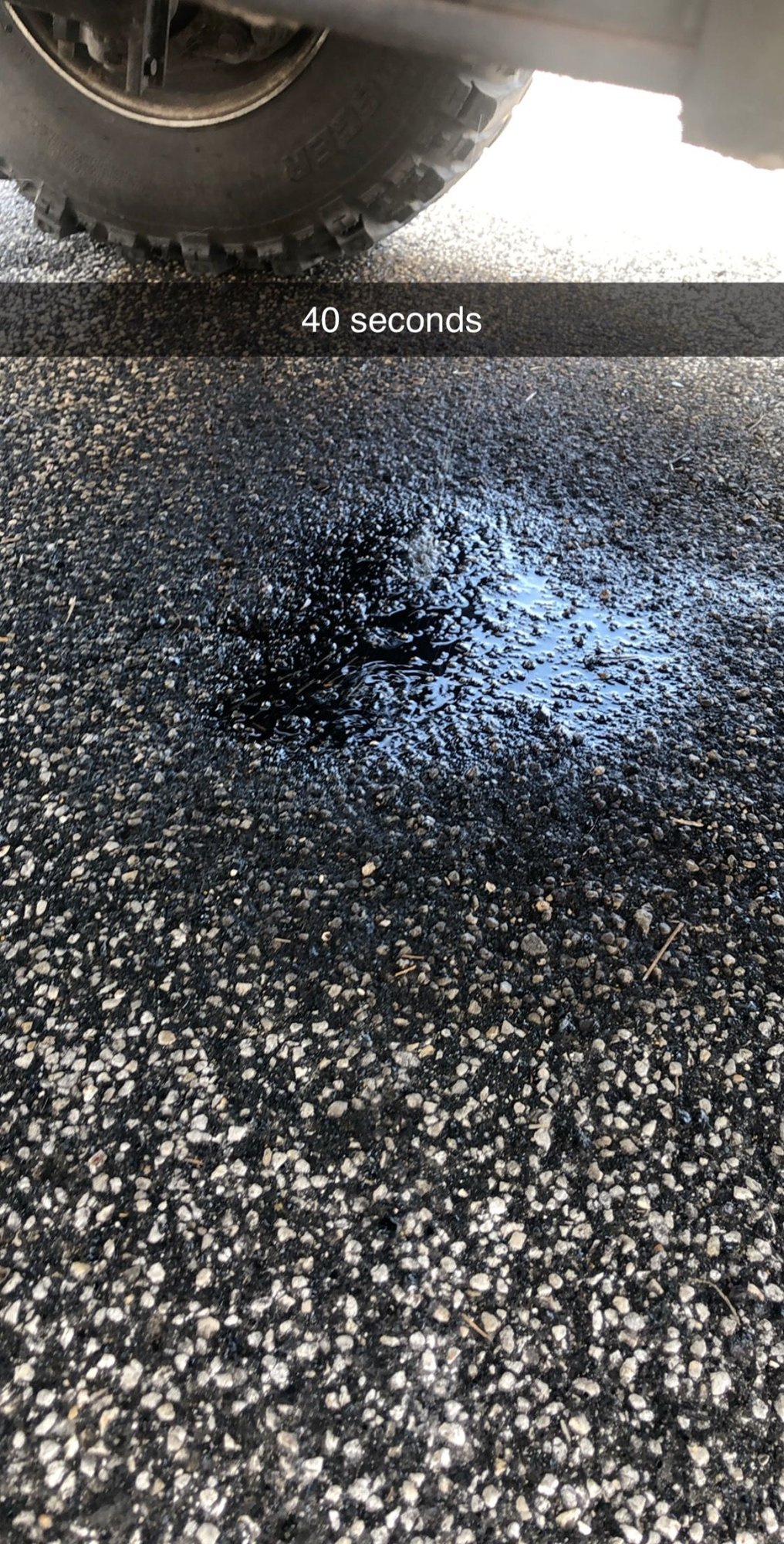

My 96’s original fuel pump is leaking bad I think it’s past time for an e-fuel setup, I’ve only seen it in person once in my short life but I know they are huge money if you buy a kit so I’ll probably make my own, any ideas or things to watch out for while doing it, I’d prefer to use pre-existing parts but I’ll do what I need to, I have access to a mill, lathe, welder and some of the basic fab shop stuff.
anything is greatly appreciated
40 seconds after starting I have a pretty big puddle of diesel

That's a nasty leak. It's probably doing damage somewhere.

It is not doing damage. Pretty ignorant statement. And this mod is a huge improvement over the cam driven stock pump setup. If you are having problems with oil changes, maybe have someone do it for you?
