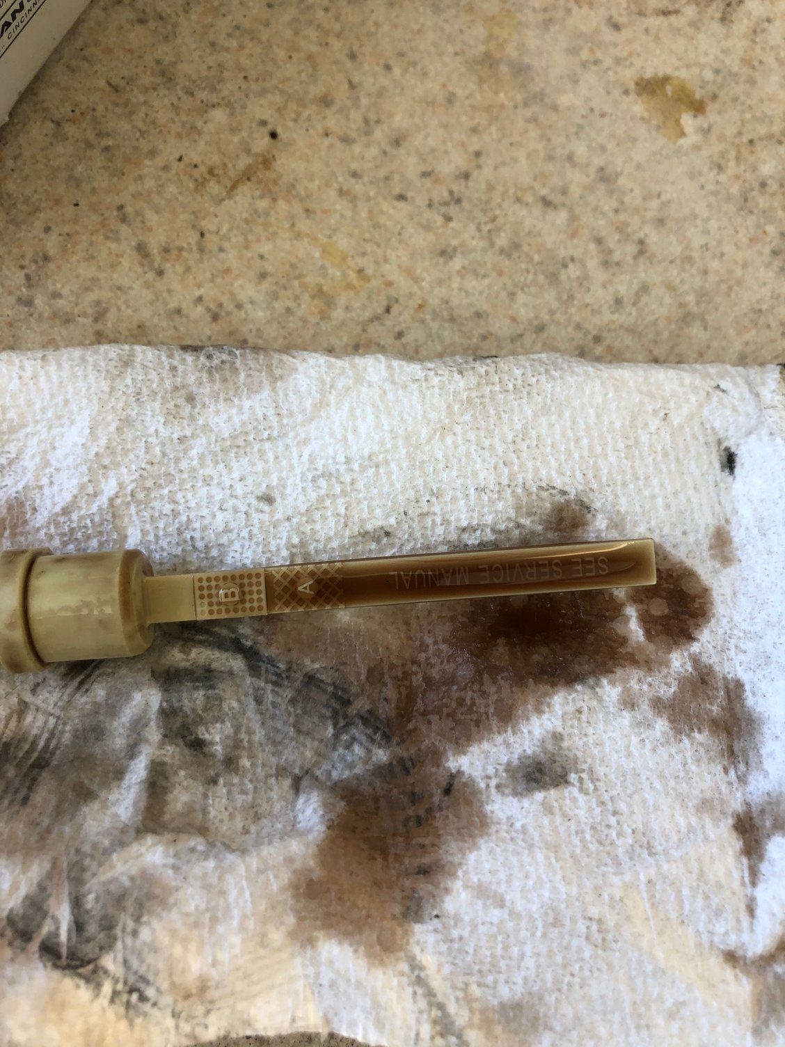

I was prepping stuff today for the actual swap and checked my replacement trans to see if it was drained. It wasn’t but the fluid is DARK. I attached a photo of the fluid. This is some of the darkest trans fluid I’ve ever seen and I’m concerned it’s indicative of potential problems I will run into after running this trans a while...maybe after the warranty expires.
Trans fluid in my donor trans. Very dark, no burnt smell but seemed darker than 70,000 miles of normal use to me.

Fluid looks normal, mercon LV turns dark quickly. I suggest while the replacement transmission is out drain the torque converter and pan. Change the filter and refill while it's out. The 6r80 needs fluid changes every 30k due to metal contain sticking solenoids.
Thanks, that is a relief about the fluid color. I already have the new filter and pan gasket, had planned to do that (required for my warranty).
